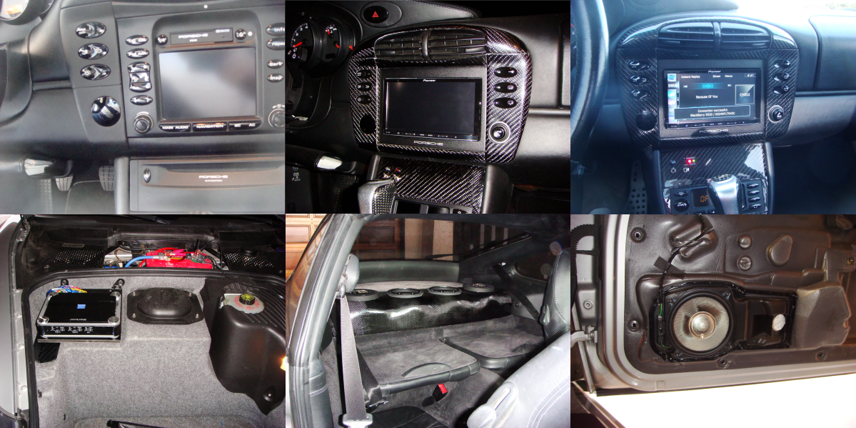

apologies to the o/p but this thread is what I'm looking at doing.
To rxbike and irish100p what are your thoughts on these pieces for a budget (decent ) build? I'm doing all the labor myself so I'm not looking for sea quality like you guys have!
dash and doors
http://www.ebay.com/itm/121174686850?_trksid=p2055119.m1438.l2649&ssPageName=STRK%3AMEBIDX%3AIT
behind the seats
http://www.ebay.com/itm/400705885948?_trksid=p2055119.m1438.l2649&ssPageName=STRK%3AMEBIDX%3AITinside the factory sub box
http://www.ebay.com/itm/231480402914?_trksid=p2055119.m1438.l2649&ssPageName=STRK%3AMEBIDX%3AITamp
http://www.ebay.com/itm/261741506700?_trksid=p2055119.m1438.l2649&ssPageName=STRK%3AMEBIDX%3AIT
this is just what i found surfing around. haven't picked a head unit yet but it will be 7 or 8" bluetooth and gps unit. thinking alpine or maybe parrot radio
and lastly to show everyone how little i know about this stuff is this the proper routing? h/u to amplifier to crossovers to speakers?

For the price what you have listed is pretty good. If you're doing it yourself you will definitely save some cash. You may have to modify the door pods to fit the focals in there. but what you have isn't a bad setup at all. IMO unless you really want rear speakers you don't really need em, which might give you some extra to step up to the polyglass focals or save it for something else. I'm also not sure how big a difference the focal subs would make in the factory subwoofer box, but any quality speaker will sound better than whats in there now.

would the subs in the doors be sufficient enough and ditch the bass box? if i had to get rid of something thats the piece i would like see disappear
I agree, front staging will be all you really need especially in our cars. Ditch the Bose sub box and run a set of 8" or a single 10" . Consider the 700/5 JL amp for your one stop shop amp. I have that in my son's jetta and it has been a very gutsy amp running mids/highs and a single JL 10w6 sub in a ported box. Add the sub control **** to decrease or increase bass as you wish at all volume and I think you'll be happy.

IMO, when I listened to Irish's car without the sub it sounded just fine to me. I was actually going to have my car done with NO sub but the installer said he would run the wires and setup the rack to accommodate anyway while it was all apart. Then offered me a reasonable price to just do it so I jumped! I would suggest doing the best you can up front but perhaps running wire to the back just in case. If you decide you don't like it you've got the wiring and can save up to drop something in at a later date. If you don't listen to bass heavy music you may never miss having a sub. Do sound deaden while you're at it IMO as that pays lots of dividends and doesn't need to weigh a ton.
I'm NO expert with audio hardware but I know I liked what I heard and bit the bullet on this install. I may yet tweak my DD afterwards! I regret the amount of funds sunk but expect I'll change my tune as soon as I listen to it. I'm already trying to figure out what sorts of music will show it off best while bouncing off the walls waiting for it to be done.
P.S. I'm actually pretty curious as to how the Bose box wold sound with halfway decent speakers in it. My installer didn't seem to like the idea of tweaking it and he's certainly more the expert than I but I remain curious

I went with an Alpine PDX-5, replaced all the speakers with Infinity Kappa and added two 6.5 JL Audio subs and two 6.25 Infinity's in the custom enclosure in the rear. The amp fits great where the stock CD player was so no new space was consumed except for the sub enclosure - that space was not used anyway. It may not be audiophile quality but it's 100 time better than stock...
