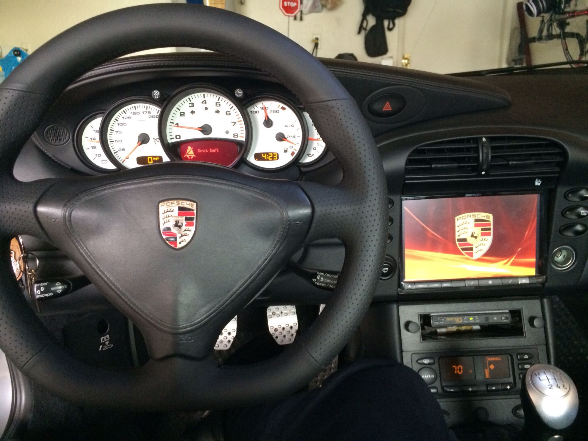

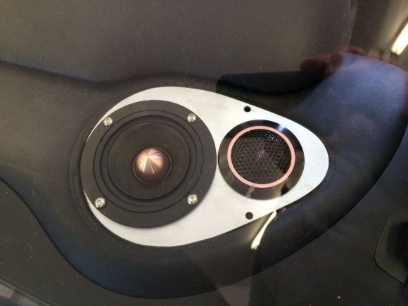

here are pictures of my current setup:

Rear panel using original mounting plate<br/>Hybrid Audio Legatia L4 and L1 Pro tweeter
I am currently powering the system with a JL HD 900/5 providing 100 watts/side to mids and highs and 500 watts to a pair of 8" DVC Hybrid Clarus subs.
With the DSP-Z8 unit in there now, my next step is to pull the passive xovers and use the 8 channels of the DSP-z8 as active crossovers, add an additional JL 600/4 and run the 6.5 of this amp in bridge mode and run the 900/5 mids and high channels to the 3.5 and r2 pro tweeter, eliminating the rear channels completely. Will be rebuilding the sub box to run a single 10" or 12" DVC and retiring the 8" subs.
