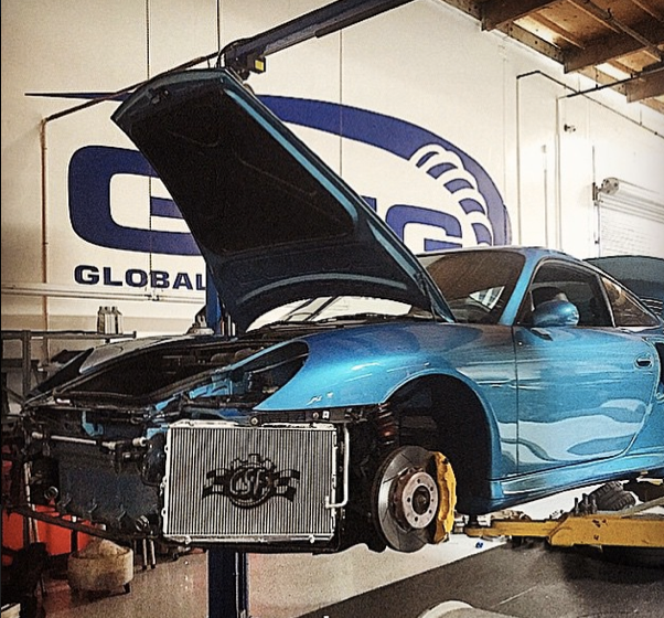

I'm installing a set of my radiators into my car right now, and not only did I buy the brackets - I've been waiting for two weeks for them to be delivered from Germany.. ugh
Been dying to get my car back next week.. Hopefully soon..
I'm really interested to know how you go about doing this if you opt not to do it the tradiaitonal way (i.e just buy the parts suggested for install).

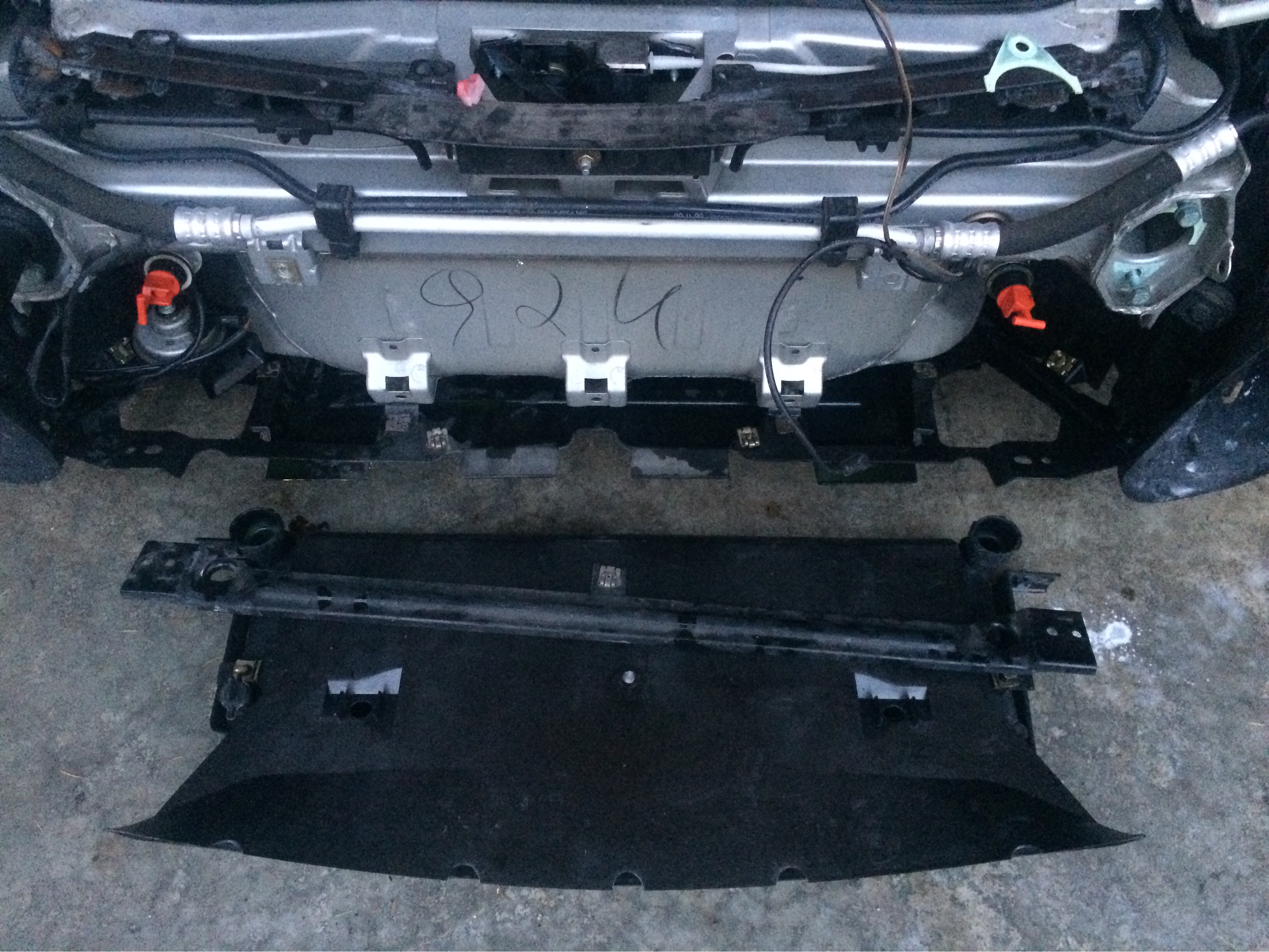

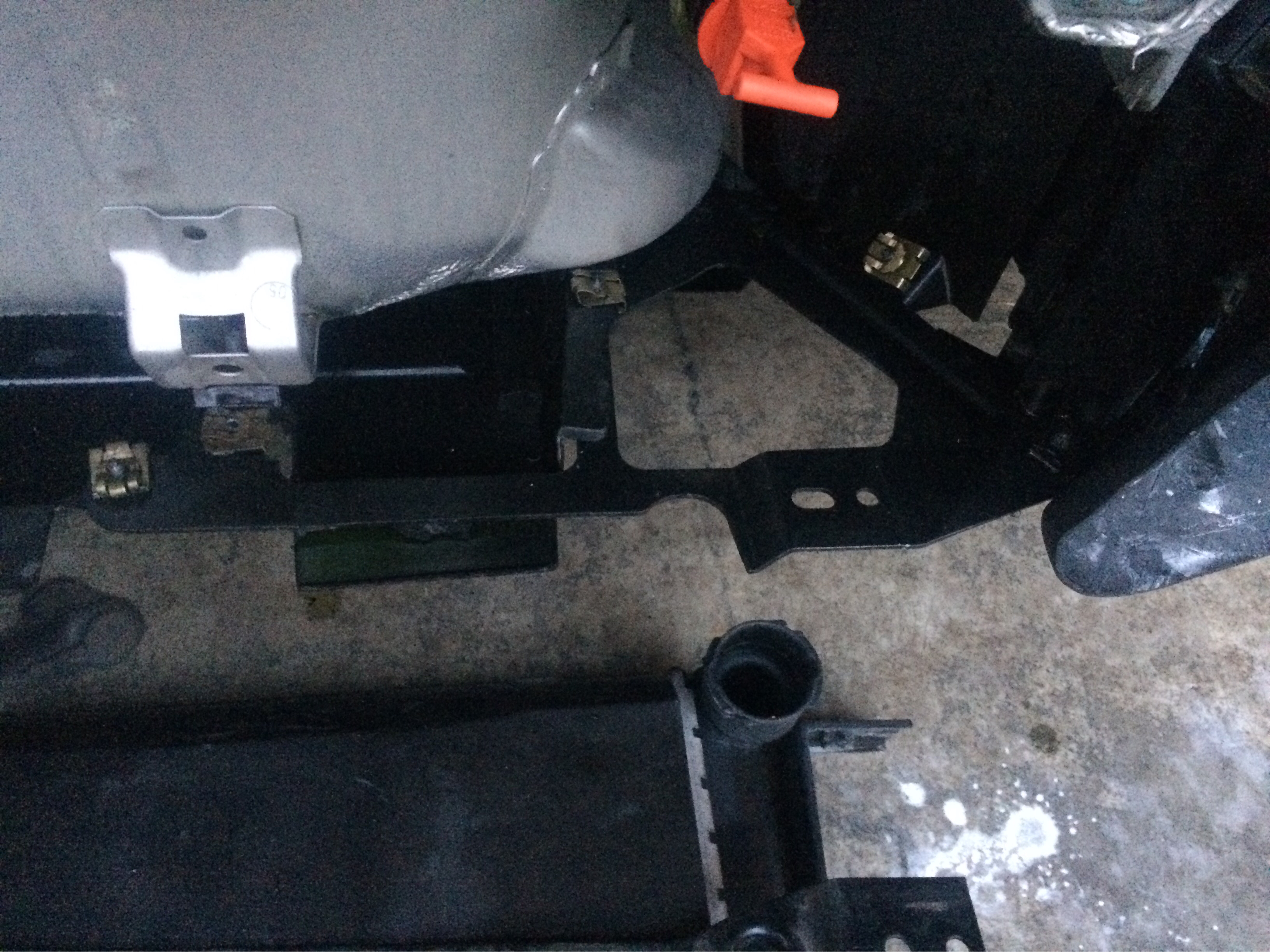

So, I was able to use the existing center radiator brackets and bend them for the tilt. The center radiator flips and fits right. The only thing you need to do is rotate the radiator frame that has the upper two bolts so the tabs are closest to the duct. I easily made my own spacers, but honestly they are not too expensive to buy anyways. Here is the tilted radiator. The last pictures show the triangle bracket before bending. They are bent stock to tilt the top of the radiator aft towards the trunk tub. All you need to do is clamp the flat part that the radiator frame bolts to to keep flat while bending. You can test for the radiator with the spacers and while reading the lower part on the brackets before bending you can put a angle gauge of some sort and determine what angle you need to bend to. Then clamp and bend away. If you have ever fabricated or done any metal work this is super easy. It took me a total of maybe 30 minutes of bending, check, adjust etc. i would never buy the Gt2 brackets after seeing how easy it is to modify the existing.

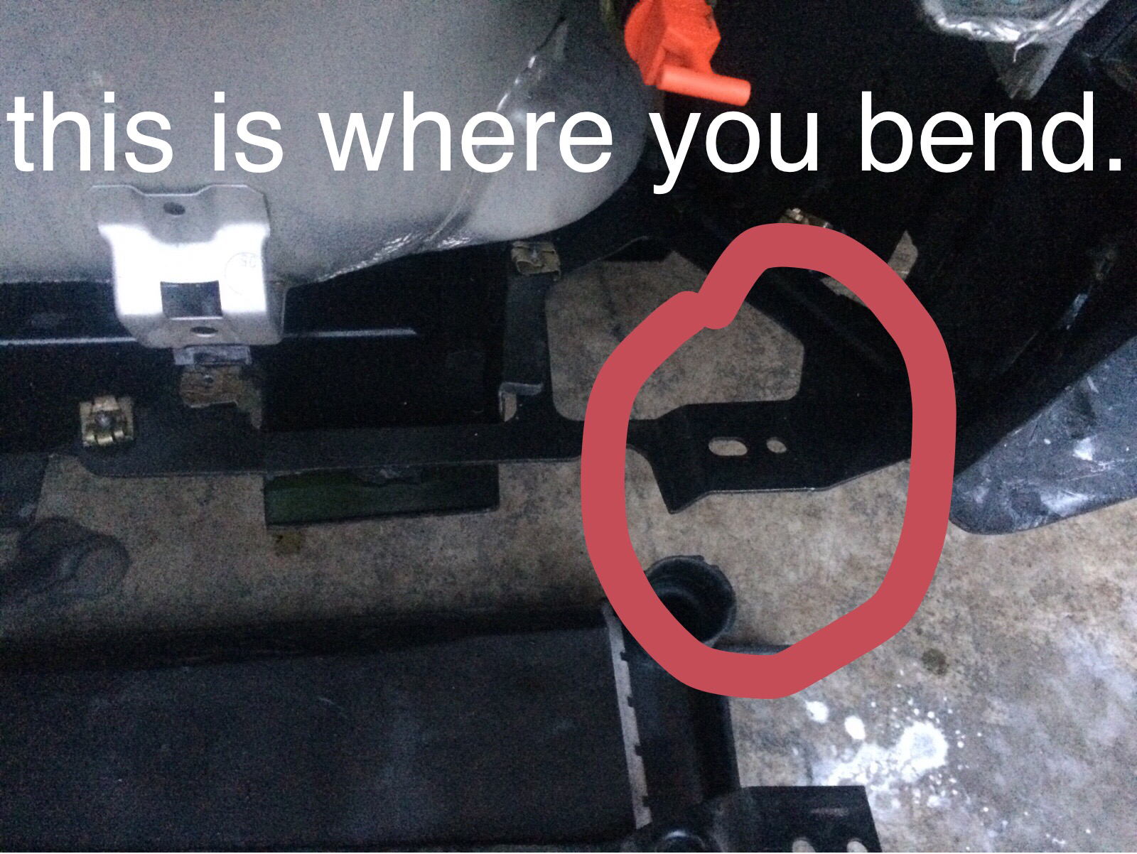

Old Jun 17, 2015 | 02:29 AM
32krazy!'s Avatar
Joined: Dec 2008
Posts: 5,551
From: tn
Rep Power: 628
i guess I'm just not seeing were the bends take place. the pics look the same to me

Here is where the bend takes place. I did not remove the bracket at all. I hope this helps?
