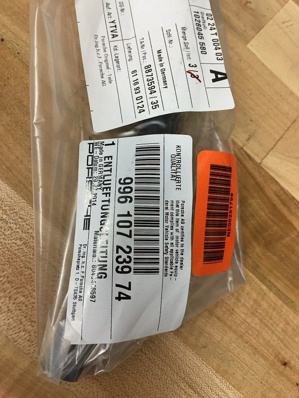

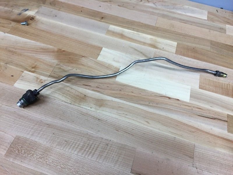

So here are all 3 oil lines for the drivers side, new from Porsche:
Part numbers for you guys:
Small one that goes to check valve:
Large line that goes to top of sump:
Large line out of sump side:
My old oil line:
And here is where that line connects on the top of engine:
Closer:
Hope this helps some of you!
