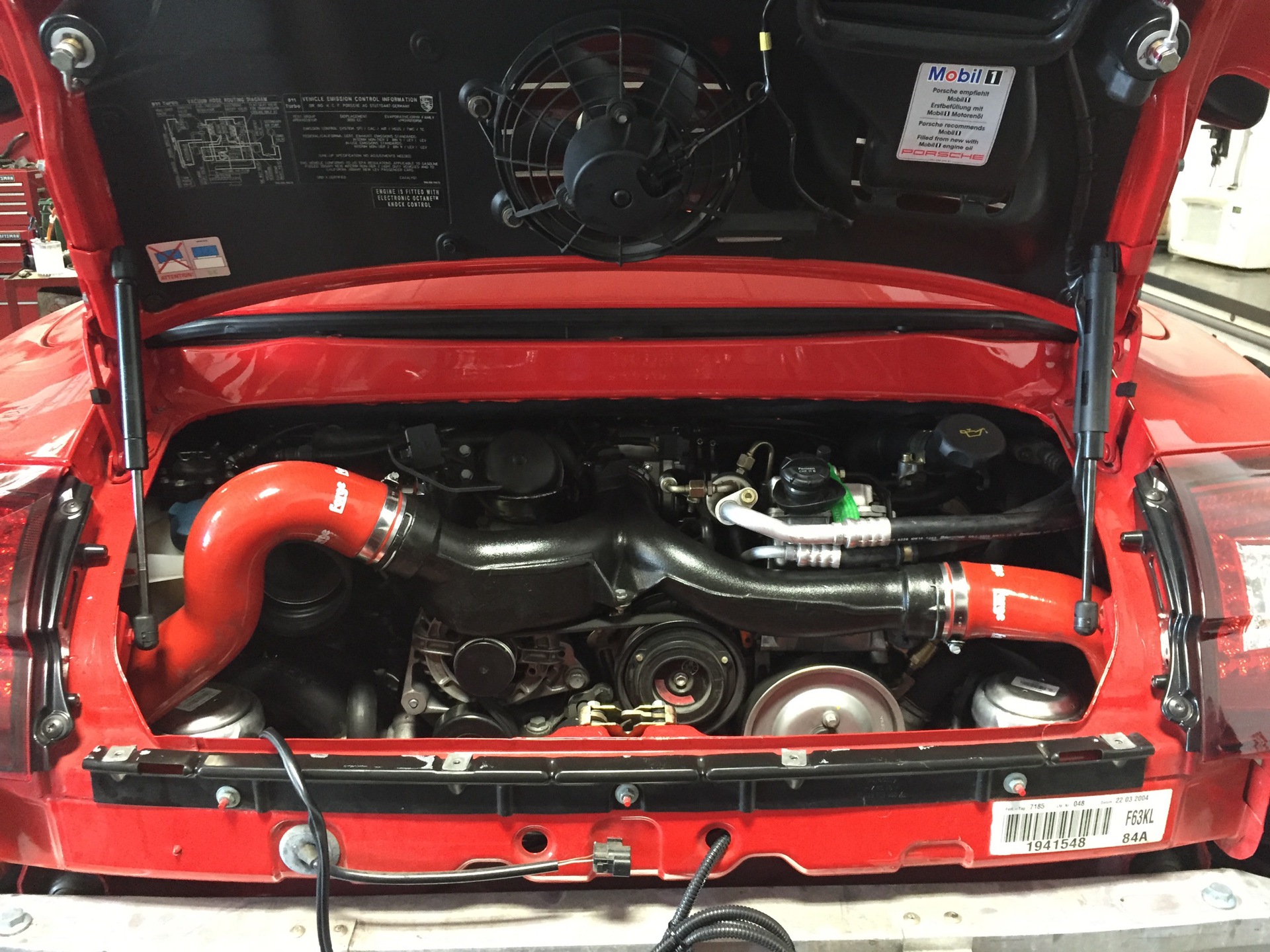

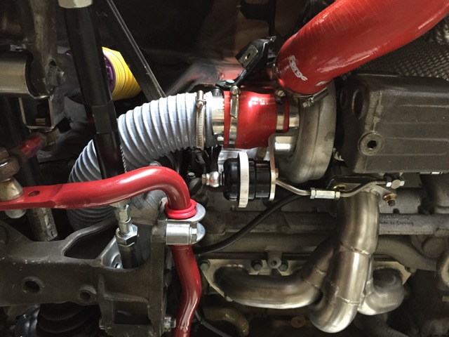

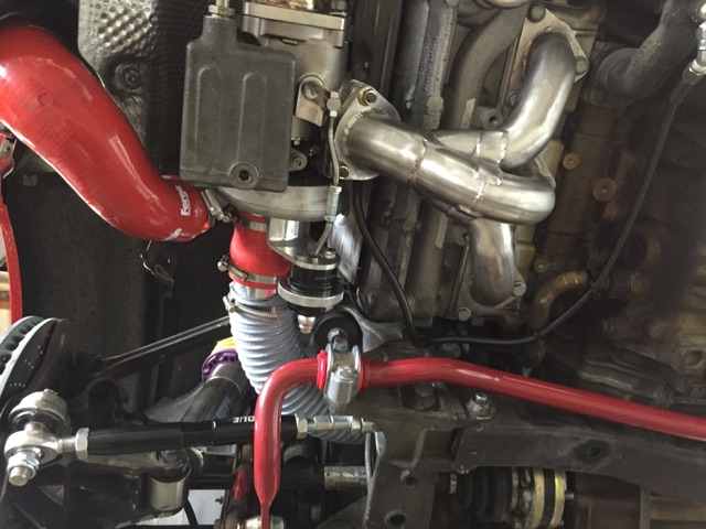

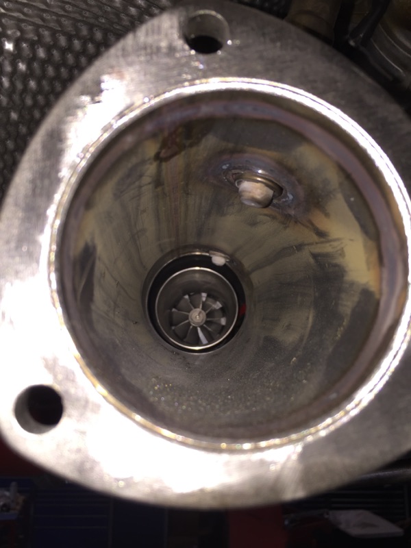

Build continuation: forge hoses (top) and new OEM motor mounts, decats on turbo, 911tuning intake hose/Torque toes/Eibach sway bar install, barrel of the gun, different angle

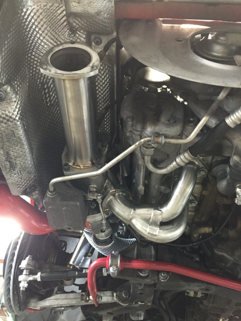

Double check now that your decat flange diameter matches the alpha turbos. You don't want a lip shrouding the wastegate exit. Will create boost issues. It's much easier now to check, and port the decats to match, then to do it later.
Thx for the tip.

Good call Craig. Yes it's a clean fit. Picture angle isn't the best. Do you think that is adding to your issue?
No, I spent a lot of time getting mine to match with both exhaust setups. However it is critical, especially with the alphas as 1) they are bigger than 3" 2)they have the tube that shrouds the turbine form the wastegate, forcing the wastegate gases to the circumference.
Great build by the way. Glad Sam has your back, can't go wrong.

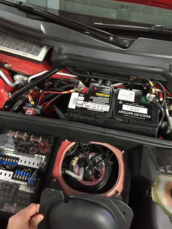

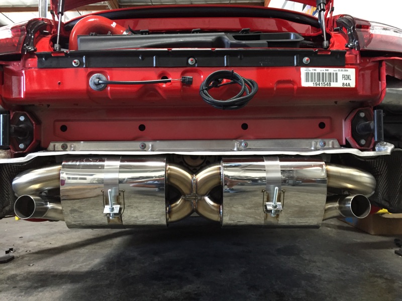

Build continuation:
SRM fuel pump, KW V3 ride height adjustments, Kline 70mm X exhaust

Untuned Kline 70mm stainless exhaust sound (in neutral, engine lid open...lots of engine noise, sry)...I'll post more later with lid closed and I'll strap a gopro back there during a run once we get a tune in.

Sounds good, love to see it spitting flames. Have fun with it.

I luv it! That 70mm exhaust does it.

When tuning is done we will get some nice vids.
