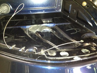

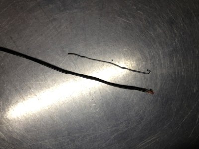

It can be tricky the first time. here is how I did it
Engine compartment Emergency Release
Located underneath L rear tail light. To access:
  1. Protect bumper with tape etc.
  2. Shine a flashlight in gap between taillight and bumper
  3. Use a hook to fish out the cable.
Here are a couple photos of the cable and the tools you'll need to fabricate
