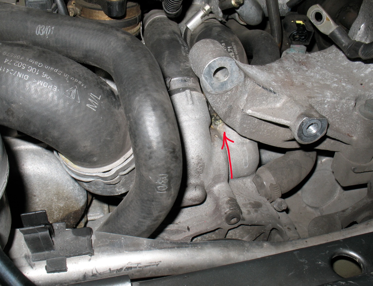

Hi All,
I've been smelling coolant at the rear of the car for a few months, but have seen no puddles. The shop I use has been pretty competent in the past, although no specialty in Porsche or 996tt. They said I had a leaking snap on coolant fitting and pulled it off and replaced the o-ring, but the situation hasn't resolved. They seem to think I need to replace all of the hoses to the tune of $2k.
Any thoughts on replacing all hoses based on age? Could I actually be dealing with leaking pressed-in fittings, or are those failures typically catastrophic? Any other likely causes of a very slow coolant leak?

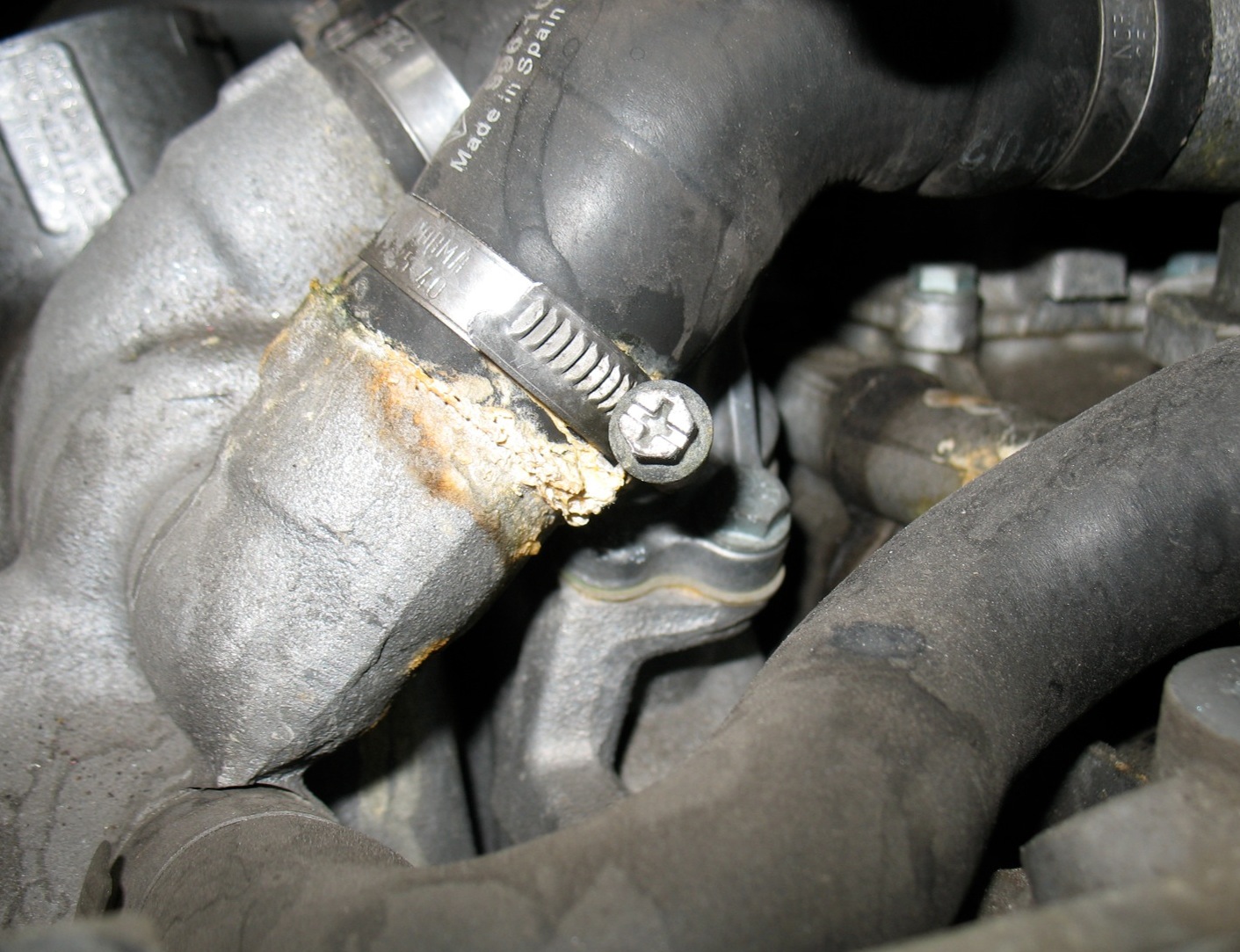

Yes it can be a coolant fitting. I had the same smell in the engine compartment for a long time and decided to take a closer look at the beginning of the storage season. What I've found was one of the fitting on the coolant pump housing was loose in the recess but did not pop-out because it was to tight with other components….The coolant was not falling on the ground , it was evaporating on top of the cylinders….The alternator has to be removed for proper inspection….I doubt the hoses are at fault but it is good to replace them if you get the fittings welded or pinned….
