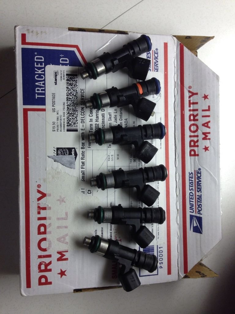

I thencontomplated about fuel. A 5bar FPR would have been enough for my goals but I fell on some 72lbs injectors for adecent price so after speaking with my tuner I went with them.
So after getting the injectors sent out to be cleaned and tested I started on the install of the Turbos.

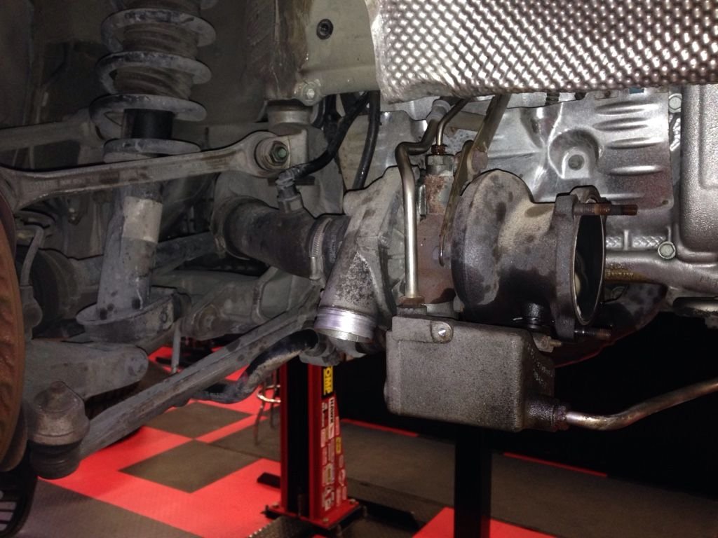

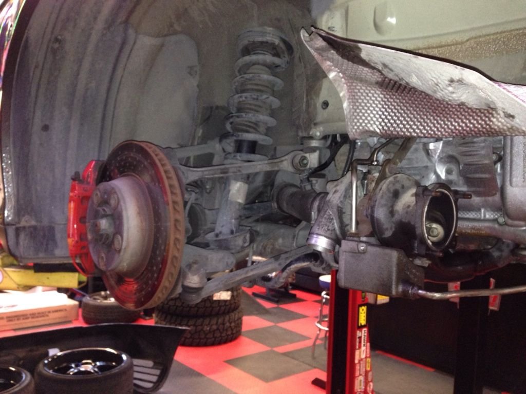

Rear bumper, intercoolers and exhaust off. Can finally see the turbos but just like everything else on this car they are going to take some time to get off.

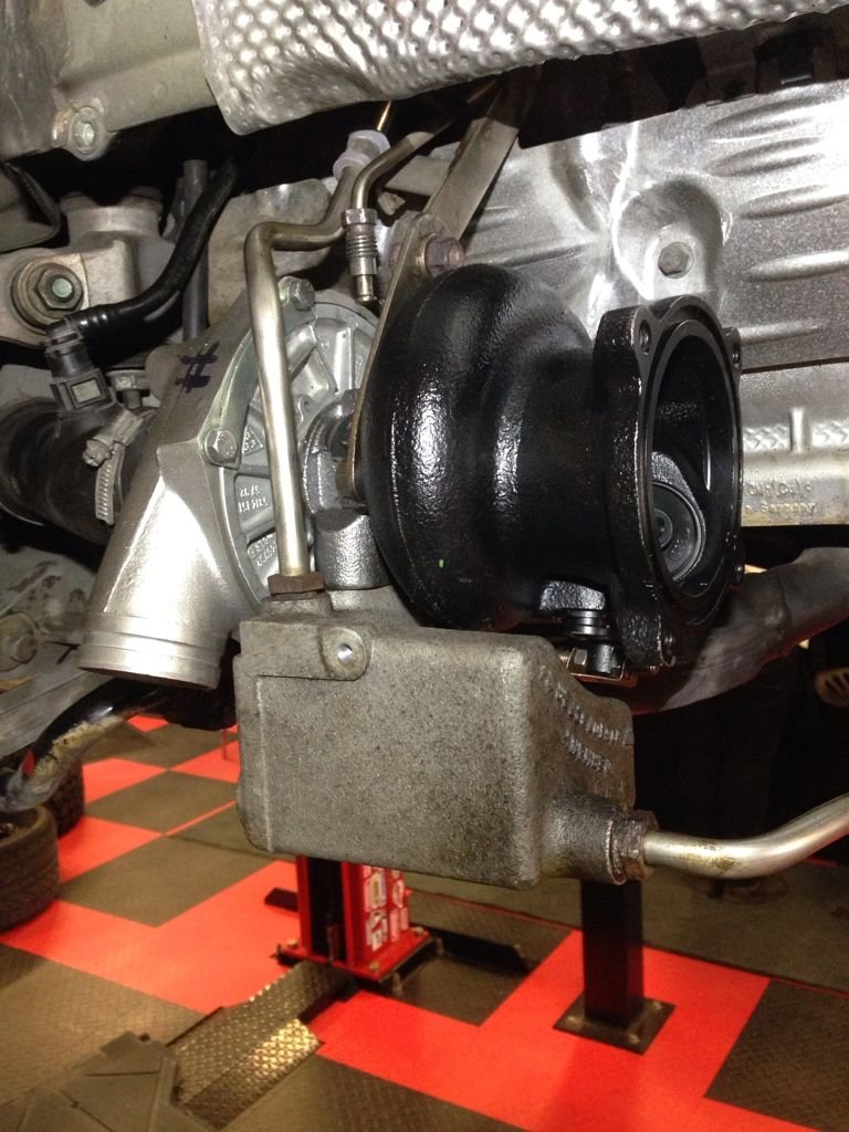

Got both turbos out and started working on getting the 72lbs injectors in. This means tackling the top of the engine. Have to remove basically everything attached to the top of the motor. And there is a damn lot of stuff and it is insanely tight. I was about ready to set the car on fire but had some help from an actual tech who was able to do what I just couldn't get at. About half way through the injector part of the job. After that it's just a matter of putting the new turbos on and the million parts back on.
Also so had to buy two check valves that go between the turbo oil feed lines and turbo itself. Cost about $100 each. Part number 996 107 030 78

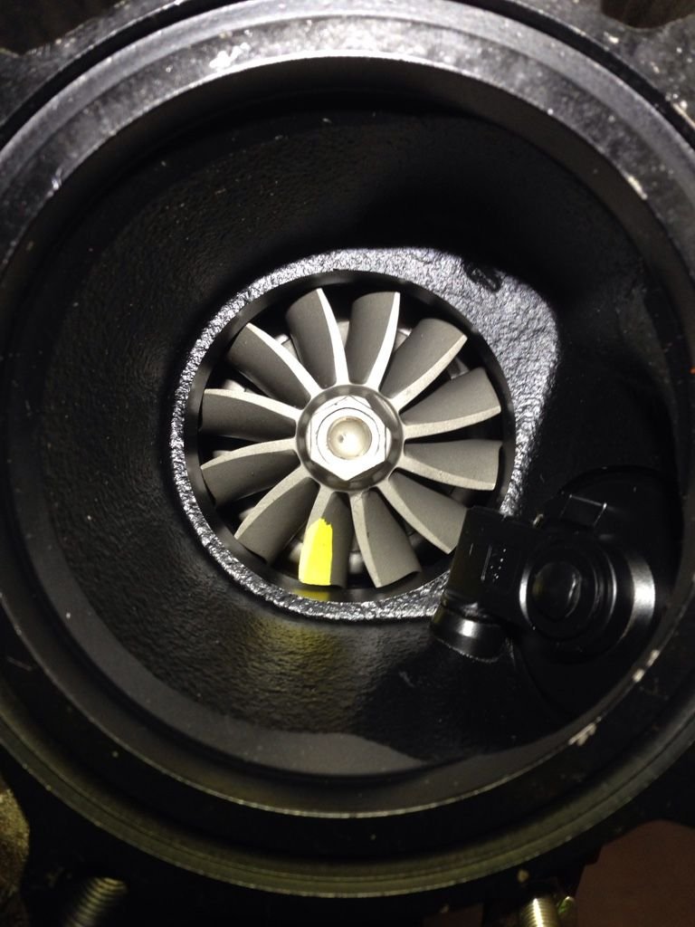

New turbos in...
Hello in there!!!
