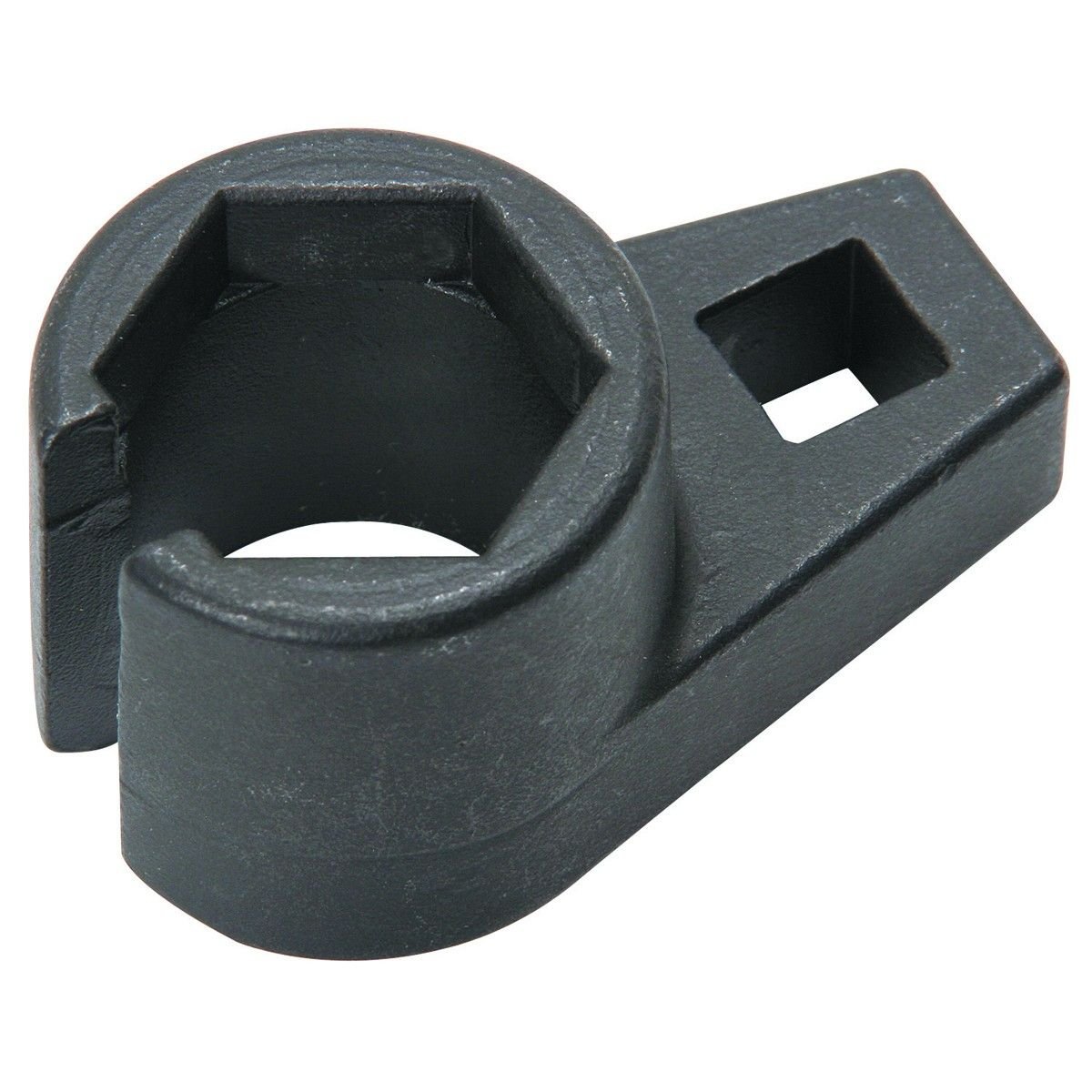

Are you using one of these in your set up with flexible extensions ?
No, I've never seen that, where do you think I can pick one up.

[QUOTE=YJosephTT;4331380]No, I've never seen that, where do you think I can pick one up.
http://www.harborfreight.com/3-8-eig...nch-97177.html

[QUOTE=rxbike;4331387]
Local autozone has a set also, thanks much...been doing it hard way all this time...

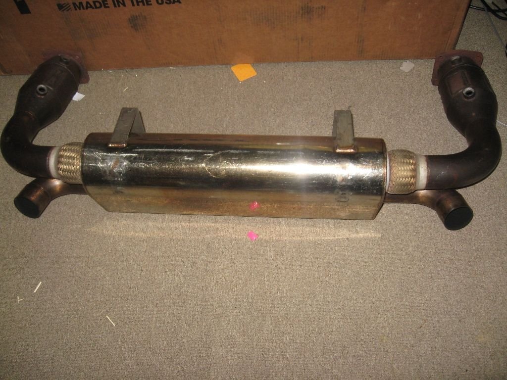

The problem isn't with breaking them loose, it was just extremely space limited last time i tried.
The area where the "cat" is is so big it made it tough to get a 22mm wrench in previously, but I just picked up the O2 socket at autozone so I'll try this time leaving it in...
Here is the exhaust:

I couldn't do it with it on, those Cat Cans on my exhaust are just too fat or may hands are too fat, but I tried with two different O2 wrenches and didn't have enough room especially with that small pipe from the oil tank in the way to get them free. I managed to get it over the sensor just could not get at a good angle to break them free. But even if I did, i wouldn't have been able to get the J extenders off with the exhaust installed.
Ended up pulling off the bumper first to see if I can get at them behind the IC and heat-shield, took about 5-10 minutes to remove bumper by myself. It looked like to much work to get IC off and I didn't want to risk damaging heat shield, so I dropped the exhaust again, this time took me 20-30 minutes max to get it completely off.
Maybe on a stock muffler its possible, but those big *** cans made it a no-go for me.
