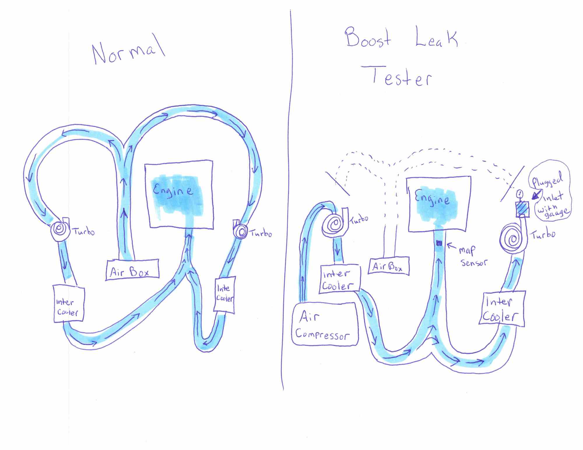

So I was trting to visualize the air flow path and why the boost leak tester would show 20psi but the dash gauge only read 0.3bar when doing the boost leak test. After drawing it out on paper, unless there is a physical obstruction after the intercoolers to the MAP sensor it has to be an issue with the MAP senor itself?? Make sense?

PS, if anybody is doing a boost leak test can you check what your dash gauge reads while doing it? I'm curious to know if the 0.3 bar mine shows is a default setting because a lot of the systems are off. Or if something is actually wrong with my map sensor.

Sambo, Markski or EPLtony should have experience with this, I would think the MAP sensor shows intake pressure whether on or off, but like you said it may be default.

The DV valves just divert boost internally and not to the atmosphere so a boost leak test wouldn't show if a DV is faulty.

The DVs divert the air to the intake track from the Y-pipe...so for example if one is stuck open a little bit...it would bleed off air into the intake behind the MAF...thus causing pressure loss.

Ahh ok. Makes sense. Especially since I took the DVs and tested them and they are perfectly fine.
