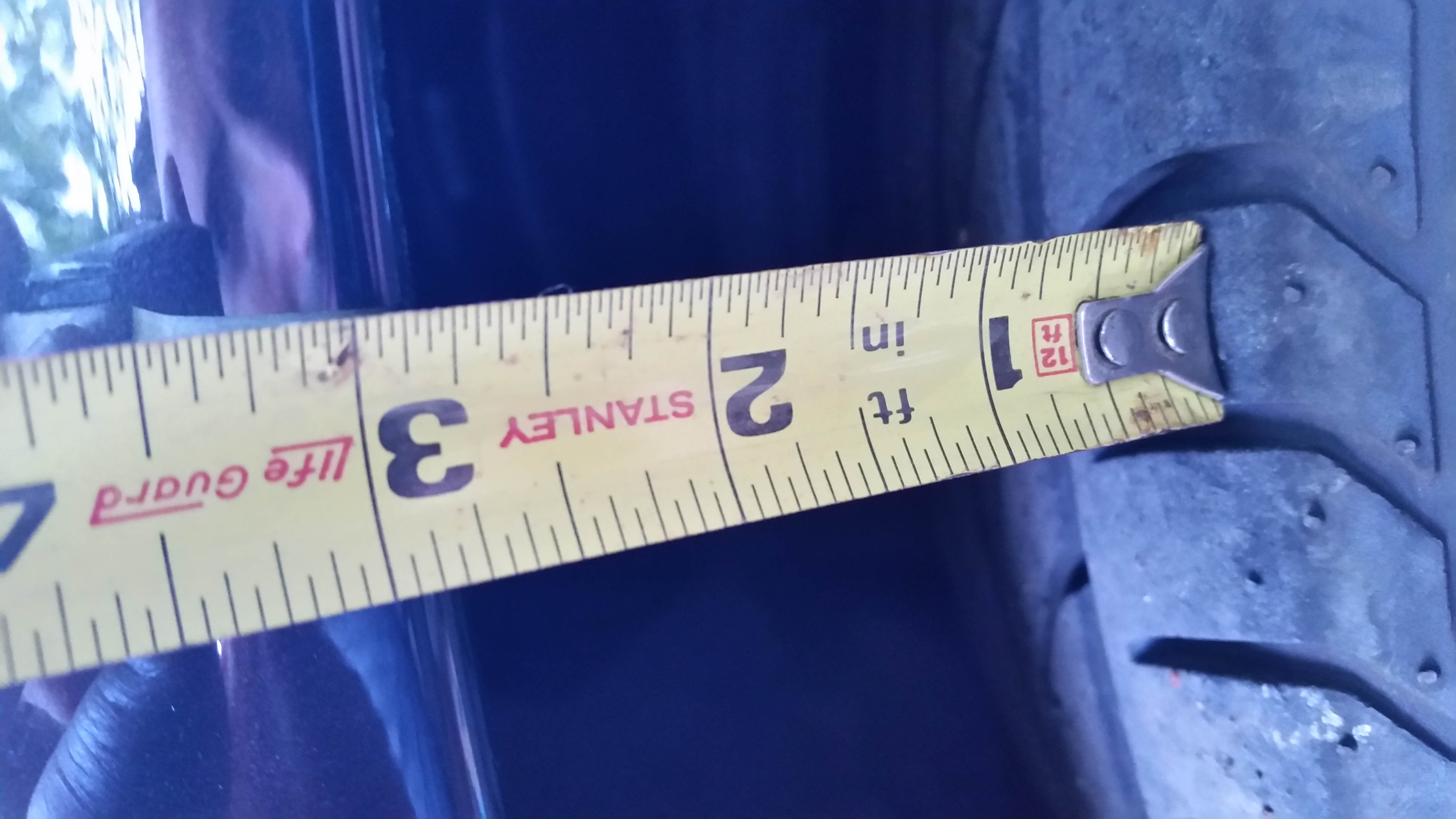

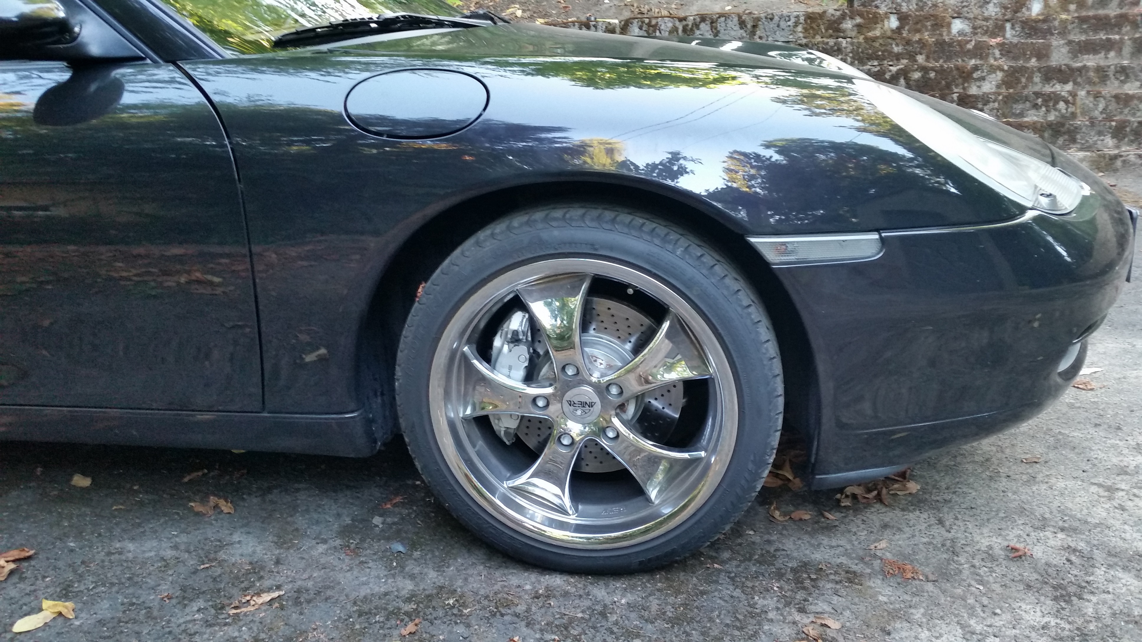

For context, this is what the front of my car looks like after the install. Currently arguing with Sunset that they need to make some adjustments, there's no way the car should sit this high.
ID:	424968   Click image for larger version
not unless it's suddenly amphibious!

Right? So my research indicates this can be an issue if the "torsion bars aren't reindexed". Does that mean re-tightening the sway bars?
I have eibach sway bars front and rear.
honestly have no idea. but I wouldn't think the sway bars can affect height like that? if the dealership doesn't know that isn't "right"(?!) then I don't know what.
looks like it's only a technique applicable to pre 964 models.
Yep, exactly. Something is wrong, that's clear.
Update: After a robust 300 mile drive the front has settled in 3/16". Looks much better. Apologies to dealership, I think they did the job correctly.
