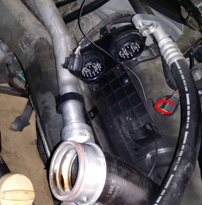

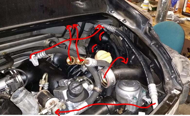

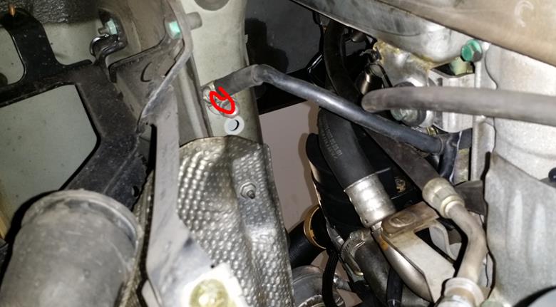

28. Time to go over to the passenger side and remove a bunch of stuff now. Some people remove the hydraulic pump and A/C pump and don’t crack them open. My A/C needed recharged anyway being 14 years old and low, and it seemed more effort than I desired to remove them in the car. So I just broke open the connection. Your choice on what to do. I removed the two hydraulic lines, and the two A/C lines as shown. While you are over here you can also unplug the two large mil-spec electrical quick disconnects. There is one more little electrical connector near the mil-specs. Unplug that too. I couldn’t find it in the pic to show you with engine in. I included a picture of it with engine out to show you the thing I’m talking about. You’ll also want to remove the passenger coolant hose while over here.

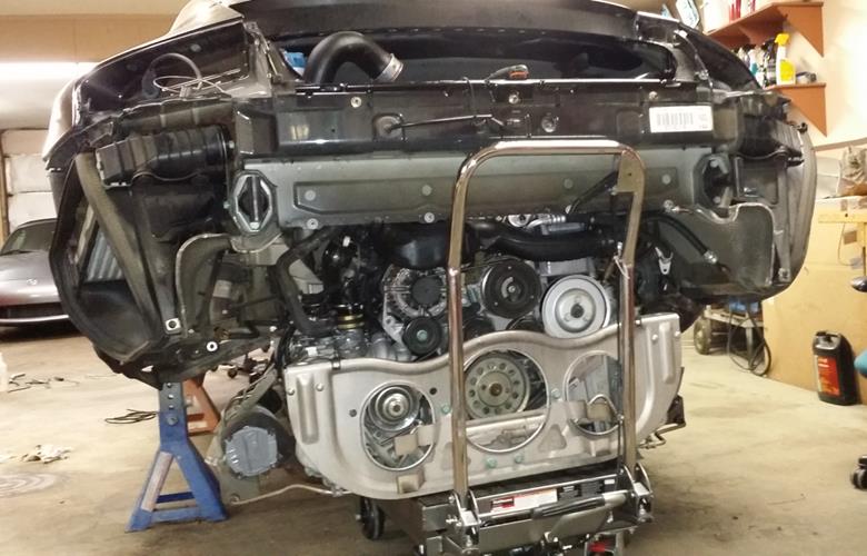

32. Next I jacked the engine back onto the mounts and put the nuts back on. I removed the cross brace that we sat the engine on earlier. There is nothing holding the engine in now except the transmission mounts up front and the big two bolts in the back.
33. I got a table to help with my lowering. http://www.harborfreight.com/1000-lb...0438-9328.html I can’t imagine the two jack method not being terrible. As much money as you are saving by doing this yourself, you might as well buy the table. I used wood on the table to make it "fit" the bottom of the engine. Jack the table up until it barely pushes up on the engine. My wood blocks were on each side of the engine pushing on the bottom of the heads on each side.
34. Remove the two engine mounts, and there are two mounts for the tranny at the very front you should also remove. Now all weight is on the table.
35. Lower the engine / tranny combo slowly until you are just a few inches below where it was when it was sitting on the cross brace. You want to be careful here, this thing is really heavy and has the ability to knock your car off the jack stands and cause disaster or even worse, death. STAY OUT FROM UNDER THE CAR while you are lowering. I don’t want to hear someone was following this tutorial and killed themselves.
36. You are a few inches lower than with the cross brace. Go to the driver’s side of the engine bay looking from under / behind the engine mount. There is a second fuel line that wasn’t easy to get to earlier. It’s held in with a 10mm bolt and a seal. Remove the 10mm bolt and pull it out.

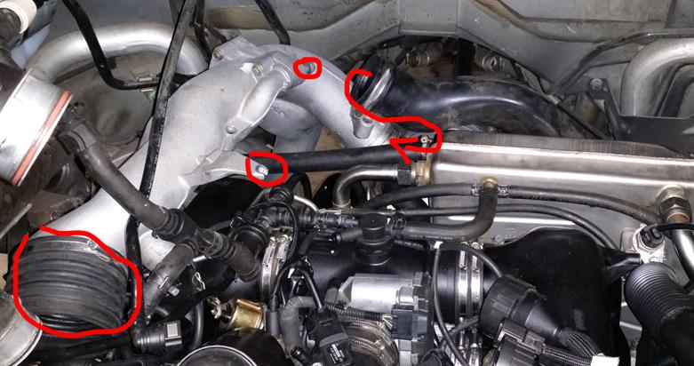

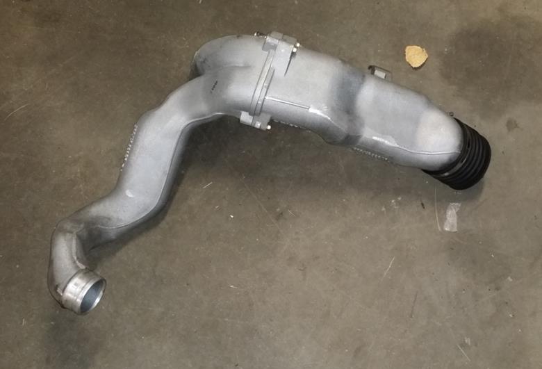

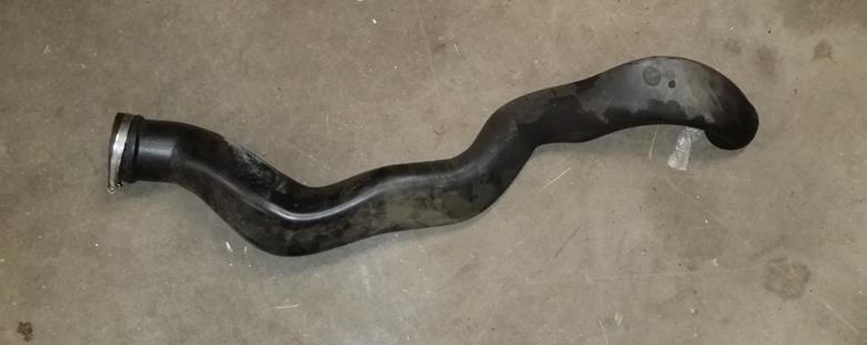

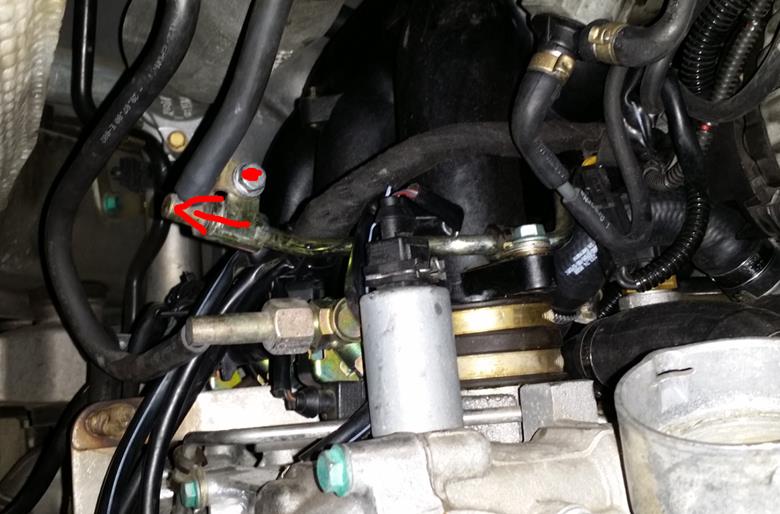

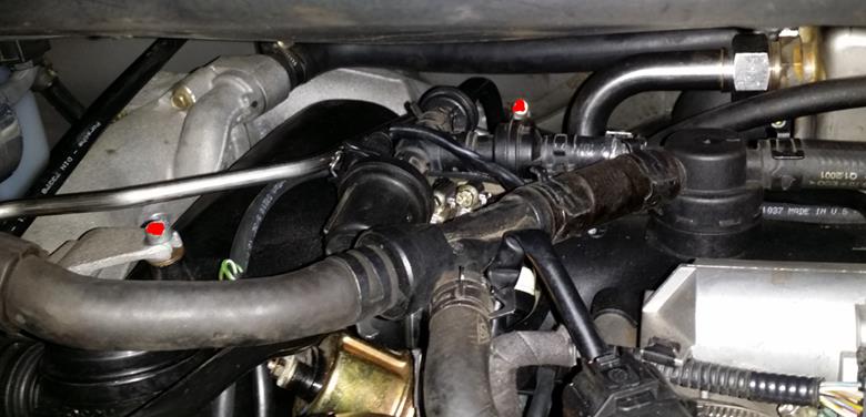

38. Repeat slowly moving a couple of inches down. Once you have enough room up in the engine compartment to be able to see the back stop. This should only be another 2-3 inches at most. You need to unhook the blow off valves, and intake tract. You’ve probably noticed by now that Porsche made the intake tract run through the rear sub-frame, and then bolted those pieces to the engine. (WTF Porsche) We are going to unhook the intake tract so that it stays in the bay while the engine comes down. In the bay unscrew the worm clamp and pull the passenger plastic intake pipe off of the big aluminum piece. Also remove the allen head bolt holding the big aluminum piece in place. There is also a line running from the oil reservoir and the aluminum thing. Remove the clamp there to. Unscrew the worm clamp in the front of the aluminum piece and pull the blow off valves off of it. The aluminum piece should be loose now.
You won’t be able to get the aluminum intake piece out right now, but I thought it would help if you knew the shape of the thing you are dealing with so I’ve attached it.
Ditto you won’t be able to get the Plastic passenger side thing out of the car so I have attached a pic of what it looks like to help you.
Eventually the setup will look like the picture with it all unhooked I’ve attached

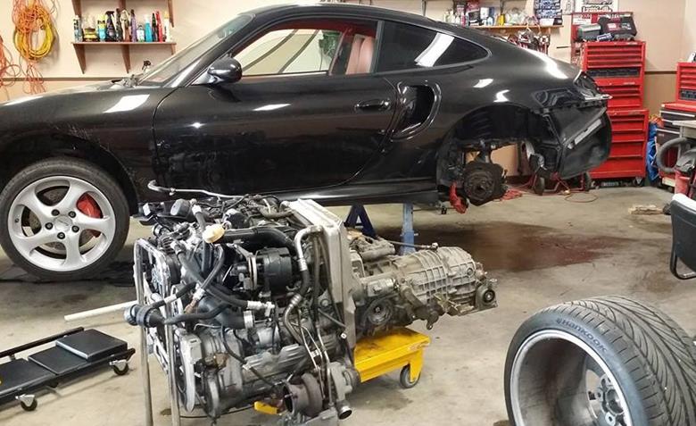

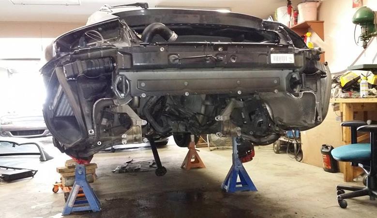

41. Assuming everything is unhooked, you now need to raise the car high enough to roll the engine out. I went slowly, and got my rear jack stands up nearly all the way. I didn’t tell you to do this earlier because jack stands tend to get kind of iffy at their max height. This gave me plenty of room to roll the engine out. If you remove the oil fill cap you’ll gain an inch or two that the car doesn’t need to come up further. Once the engine was out I then put the rear jack stands down a few notches so they were stable.
Old May 27, 2015 | 09:01 PM
  #70
crash41301's Avatar
Joined: Dec 2014
Posts: 134
From: Louisville, Ky
crash41301 is a splendid one to beholdcrash41301 is a splendid one to beholdcrash41301 is a splendid one to beholdcrash41301 is a splendid one to beholdcrash41301 is a splendid one to beholdcrash41301 is a splendid one to beholdcrash41301 is a splendid one to beholdcrash41301 is a splendid one to behold
42. You are done!
All in all, having now done this, it wasn’t as bad as I thought it would be. Porsche clearly spent time to make it *relatively* easy to drop the engine. Nice of them considering they designed it to need the engine out for most services!
