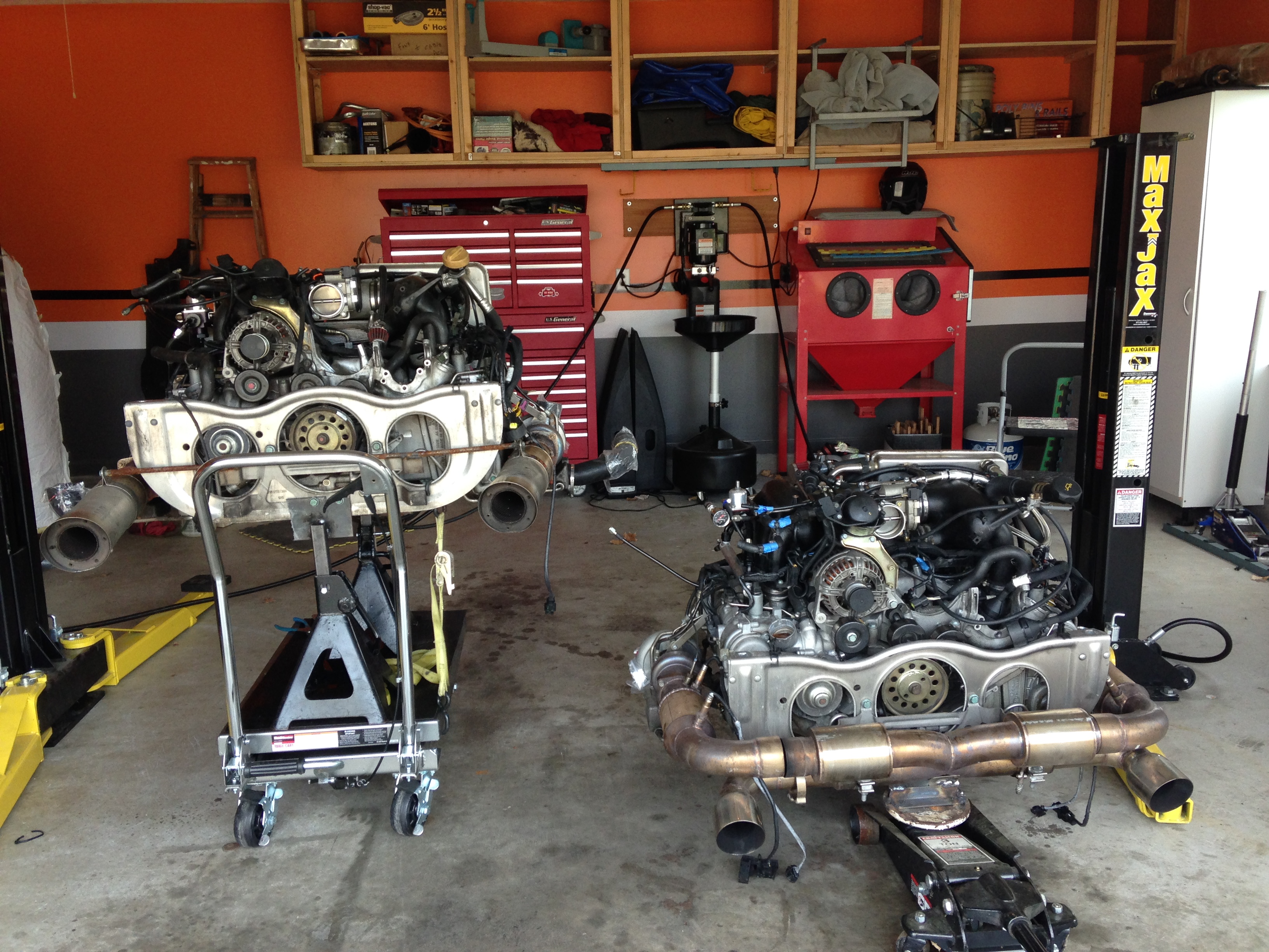

get a lift. it will save your back your time and your sanity. i use the max jax and its the main reason i still have the car

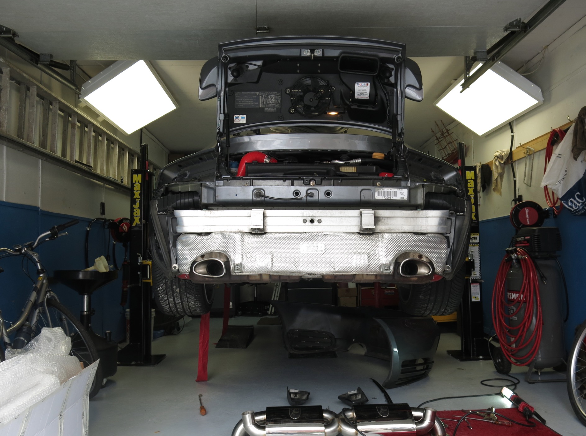

I like it !!! Got the same equipment but less space ;-( Love the Maxjax and also got a 1000 pounds hydraulic table...Very useful....

With the two post lift system (maxjax) how does the weight transfer workout when you finally separate the engine/trans from the car. Does it not become nose heavy with the fuel tank and want to tip forward?
no car is solid on the lift.
