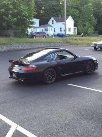

So the wing is Strosek? I was wondering. The OEM wing was in the backseat when I purchased the car, and the dealer said it had a "...GT2 wing". Based on the dealer's ad photos I was expecting a fixed wing, but this one has the original working hydraulic rams and actually works (for now). Regarding brakes - I need some recommendations for upgraded street/track pads that are relatively rotor-friendly.

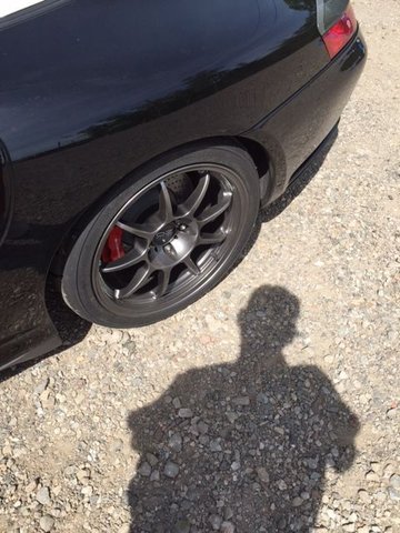

Track Upgrades So Far
Ended up with a set of OEM size OZ Allegaritta wheels and R888 tires for my first track event. Can't say I like the tires all that much - lots of tread squirm and a soft turn-in, at least compared to the Hoosiers and MSPCs I used on my 968 for club racing. They get greasy after 3-4 laps. The car is great fun on the track, but it's a whole different approach - not a momentum car for sure. I'm constantly refining my line in order to straighten the car out and light the turbos sooner! German muscle car. Worth noting that the event was at the new Whiskey Hill Raceway in Palmer, Mass. It's a very complex track with several challenging series of corners that require planning and precision. They are still working on the track - adding striping, catch fences, and eventually curbing, but it's ready for action and there are loads of club events scheduled there this summer. Ordering some PFC brake pads for the COMSCC NHIS event coming up in a few weeks. I will need a real racing seat and harnesses next...

yeah, good choice on the wheels. lightweight and cheap for track in case you mess em up. looking good.
