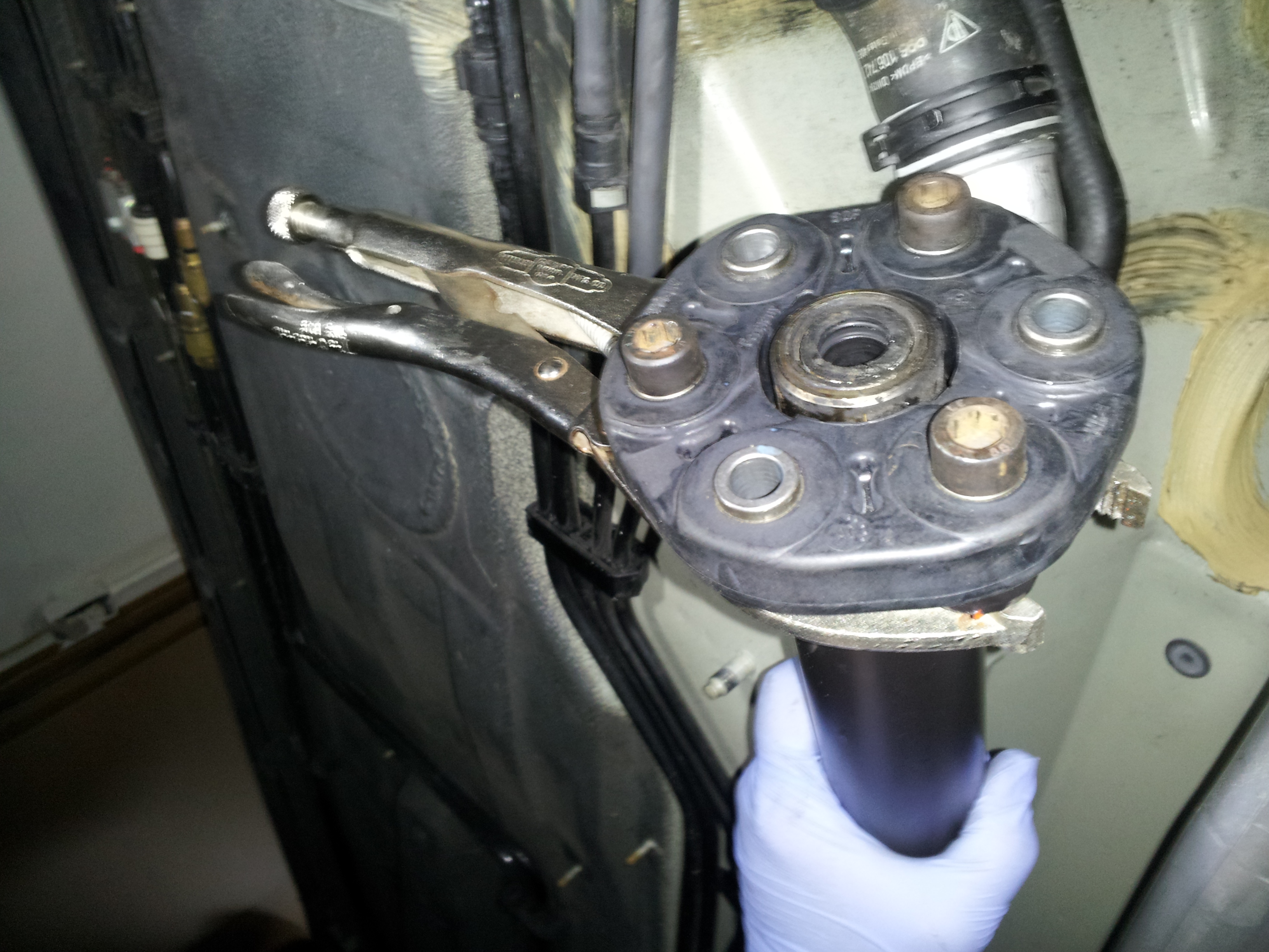

Couple of installation tips:
You need to drop the nose of the transmission down (while supporting the trans housing) and push the drive shaft forward to allow for the trans output flange shaft stub to clear the shaft flange and coupling.
You need to hold the front drive shaft to loosen or tighten the allen bolts on the shaft side of the flange. I used a large round round jawed Vice Grip to hold the shaft. You could also use something like a pipe wrench. See pic below.
When installing the new coupling, you need to install the allen bolts on the front drive shaft flange side first (while holding the shaft as above).
After inserting the output stub back into the shaft flange, the trans then needs to be brought back level and in neutral to allow shaft rotation to initially insert hex bolts on the trans side, then engaging & disengaging the parking brake while rotating the shaft to tighten up the hex bolts.
