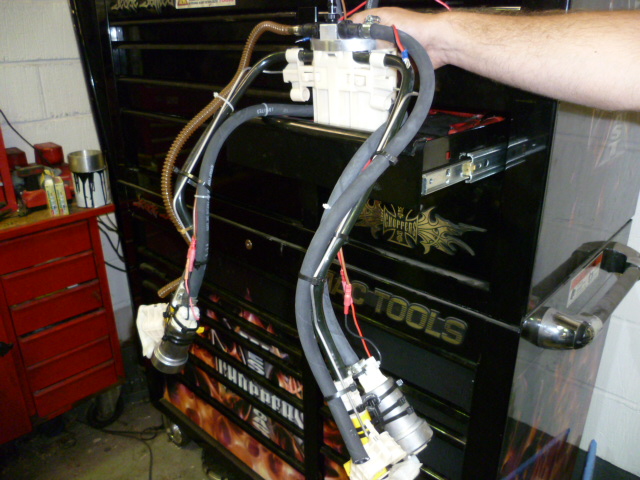

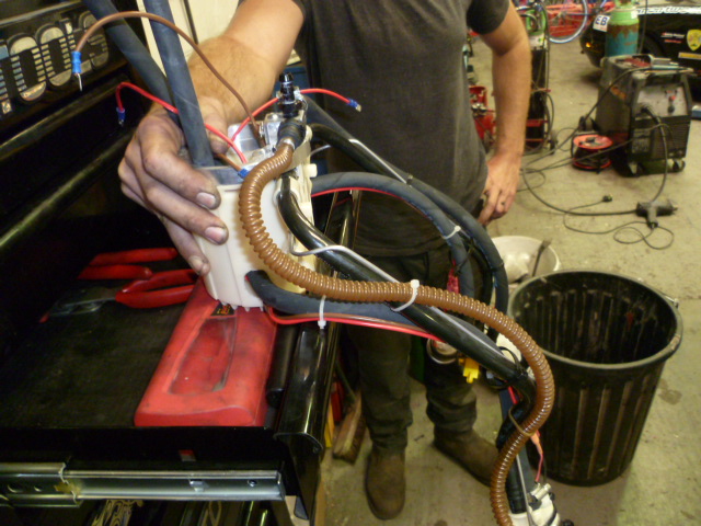

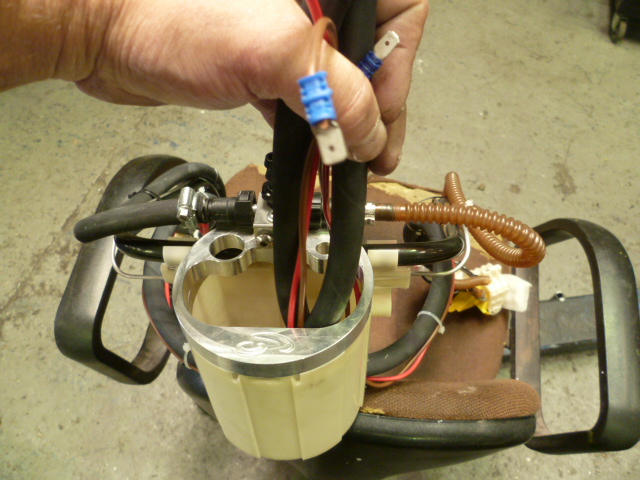

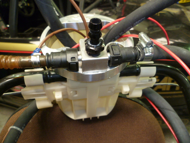

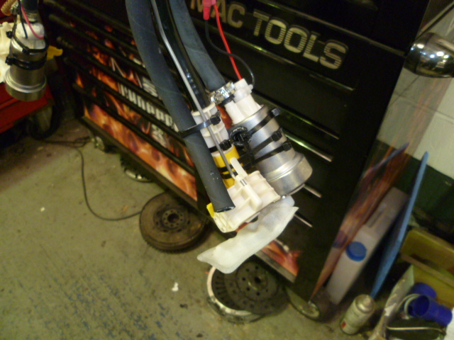

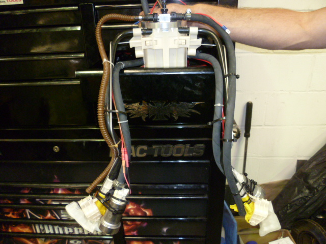

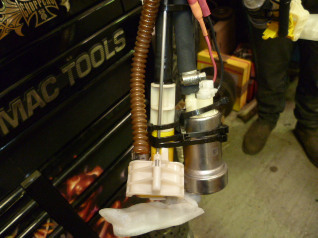

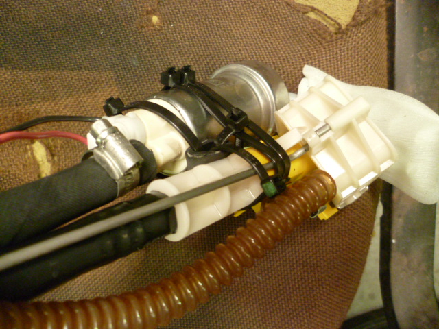

Having just had to change the fuel pump wiring on a dual 044 setup to 30amp I decided to take my system apart and do the same so I thought I would grab you guys some pics.

I have disconnected the venturi hoses from the jet pumps (one remains as the convoluted, the other I changed to a fuel hose) and drop the return into the black fitting that T's into them so that the fuel returns direct to each fuel pump.

Looks good and should work great! Why not just dump the jet pump to save some space and use the arm alone though? If i would have done it this way I could have easily run dual 450lph walbros instead of dual 340lph pumps in the swirl pot. When i get some time i'll start looking at fabbing something up to do this method. I'd rather do this method than sumping the tank and running external pump/s. good luck and keep us posted.

Not being sure how it would work I wanted it to be somewhat reversible if needed. If there was a way of filling the big black tube with a product resistant to fuel that goes solid then that would make them even sturdier.
