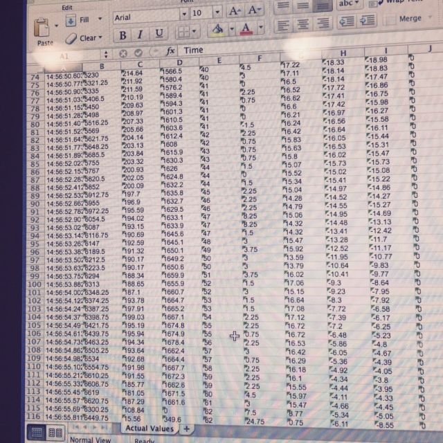

we have debated the gt2 RS ICs in many threads...
here are 2 logs from a shop in Louisiana, they are dyno logs with snail fans on outlets of ICs.. these are brand new gt2 RS ICs on a stock 2008 TT VTG with exhaust and some tune... one is with sport on and the other with sport off button... I can forward the actual logs for anyone that wants to see it in full.. the car is acting up pulling timing crazy but look at the intake temps how high they rose.. Now this is not my car nor my dyno nor my tune but rather last weeks independent dyno pulls.
On these logs the RS do not seem to do all that well... one pull is at barely 1.2 bar the other 1.4 bar and drops to 1.2 plus... both 4th gear... Does that mean all RS ICs do this poorly? no I dont think so...
Anyways, my point is that we all can show data to discredit and or promote XXX ICs... We all talk about cooling , what about flow... because the better they cool the worse they flow due to the fin design. My other point is , Im not trying stir anything up, I even triple checked to see if they are gt 2 RS... Some gauge performance based on temps only, some on road track performance, some on 1/4 and dyno, etc... I just think the the truth is in the middle in this case and if something sounds too good to be true it probably is.. learned that in Econ 101 back in 1987 at Marquette U
Would love to see this log. -18 Wow! I like to promote the stuff that works while having the facts to back it up.
