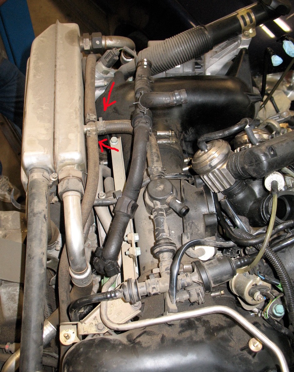

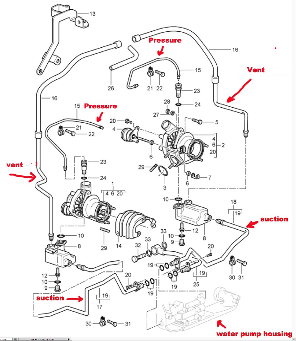

The line that goes to the top turbo tank is the oil pressure line and the one that goes to the side of the oil tank is the oil suction line. The oil is sucked by a pump located in the water pump housing and this oil goes back to the crankcase..... Picture corrected, thanks 03EvoIII !!!
Name:	Screen Shot 2015-06-30 at 11.44.31.jpeg

That's incorrect ^^^. That line you have marked as pressure is an air vent line...no 'pressure' per say is in that line.
The small hardline is the OIL FEED and the big suction line is the OIL RETURN.
OMG Your right I just saw my mistake!!! Thanks I am correcting it right now!!!!

Originally Posted by alwaysnboost
jpflip-Do you know how one would access this and replace? Looks like they are buried.
I would say yes it can be done but you should lower the engine about 4 inches to reach the attachment at the T just besides the top of the oil tank.... It is really easy to lower the engine, just place a jack under the engine, remove the two nuts on the carrier (18mm socket and 63 ft/lb of torque when reinstalling) and lower the engine maximum 4 inches. You will be able to reach the top attachment ....
Name:	Screen Shot 2015-06-30 at 12.02.02.jpeg

you can reach it but you will barely be able to get a pair of pliers on the clamp. if its like mine was the clamp was facing the oil tank and no way to get to it. since my engine was out i was able to pray it off but no way to get at it when motor was installed. good luck!
