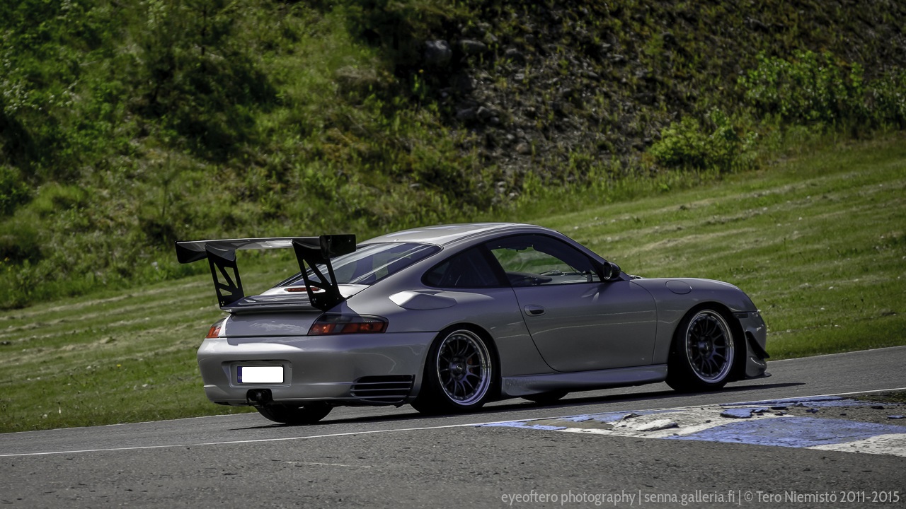

Pics below. Almost everything about the build can be found from RennTrack's 996 turbo section, there's a long thread, about a long process... Tuned locally, had last spring just below 600 hp and 800 Nm (crank) at 1.2 bar. Some alterations since, but no dyno trip.

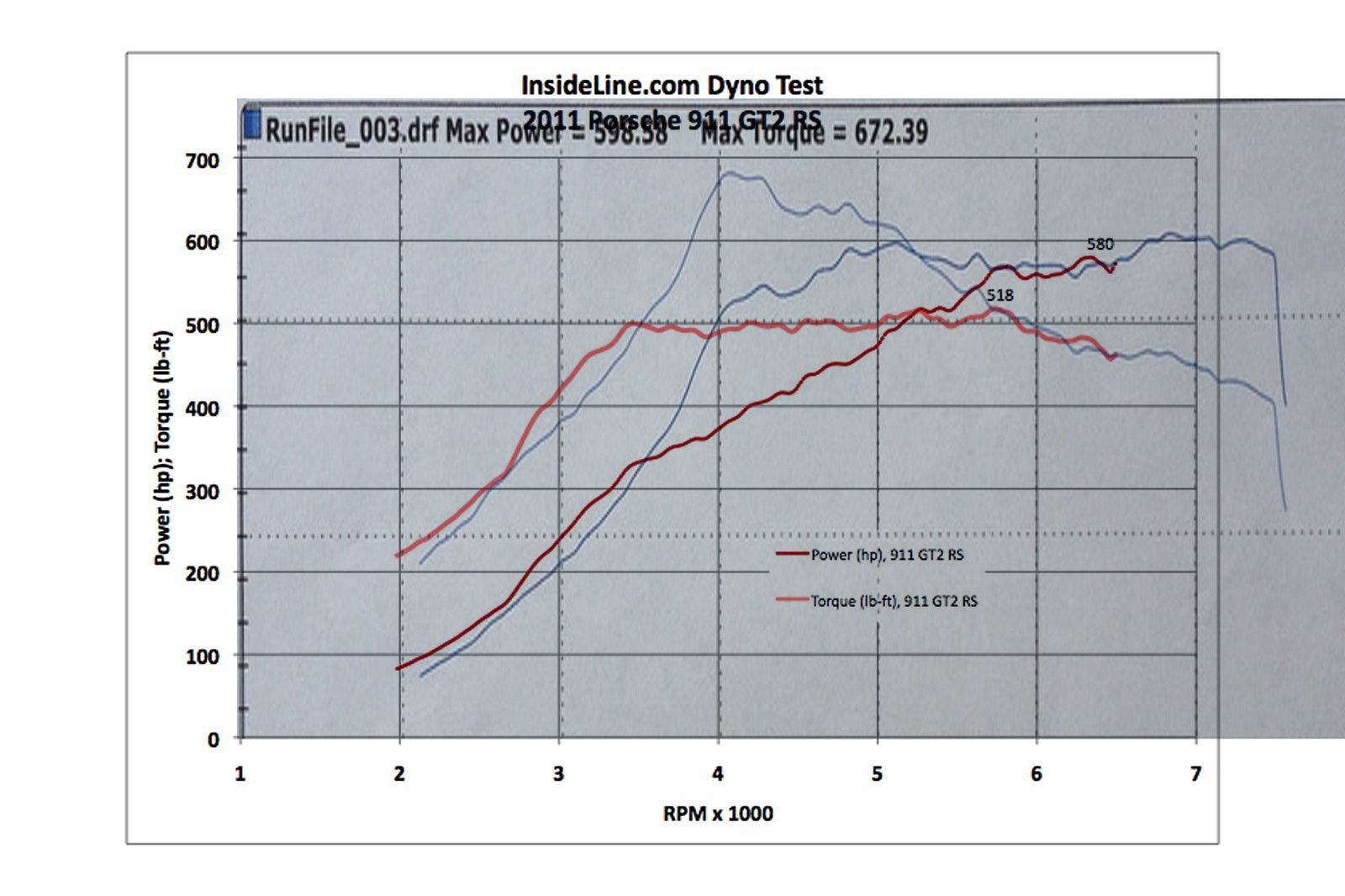

Wow! Your lower rpm torque is massive and your HP curve looks like a very good torque curve
Very impressive. I can see why traction is a problem. Have you driven in the wet yet?
I hope I can come close to this.
I've overlaid your dyno chart on the GT2RS's. Streetability is good too?
Streetablity is excellent. Drives like stock. Engine response is instantaneous due to the simple fact that the displacement is larger and all the rotating components in the engine are lighter. The ported K16 turbine housings and zero clearanced compressors obviously play a part in an essentially instant spool up. I'm actually thinking about having my turbo builder put together a set of similar zero clearance turbos but on a K24 frame to see how they would compare. I would be willing to give up some of the low end grunt (which I have almost too much off) in exchange for some more top end. We'll see. On street tires 1st and 2nd gear are basically useless but on track with sticky R compounds the car hooks up nicely. I have taller 997GT2RS gearing along with a 26.4" rear tire which helps tremendously by effectively making the gearing much taller thank stock. Re-gearing the box is a virtual must if you end up running appreciably more power than stock. No I have not run in wet as all my tires are basically slicks. Overall this set up works very well considering its 100% emissions legal and visually doesn't give anything away to the stock engine. I'm very happy with the performance we're getting on relatively modest 1.2 bar of boost compared to 1.6 on the RS. The one thing I'm running up against now is maxing out the intercoolers in prolonged track work in +35C ambient temps while on relatively low speed technical track. I've researching various options and it appears that the only intercooler which would provide quantifiable benefits over the 997.2s for my type of use would be ones with Secan or Aerospace Marston cores. I'm in the process of getting some quotes for the Marston Core ICs but I doubt I could justify their cost.

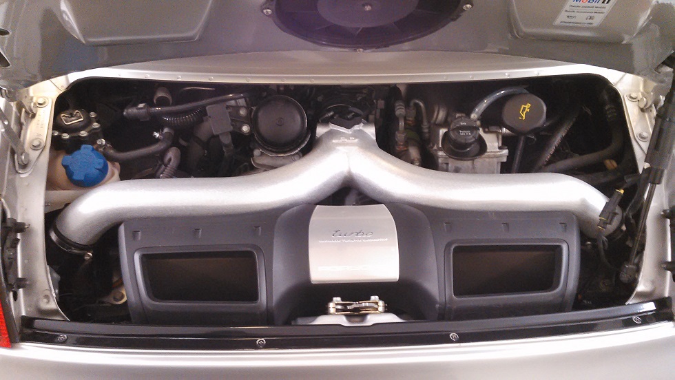

Thank you. I like to keep things on the car OEM to the greatest extent possible. The majority of stuff on my car are factory Porsche parts. I prefer to stay away from aftermarket parts to the greatest extent possible.

^^^ ya know pwdrhound...that stock y-pipe weighs a ton. Just Sayin.
But seriously....VERY clean setup.
That's why I offset it by removing the A/C compressor and fuel cooler... (-18lbs)
