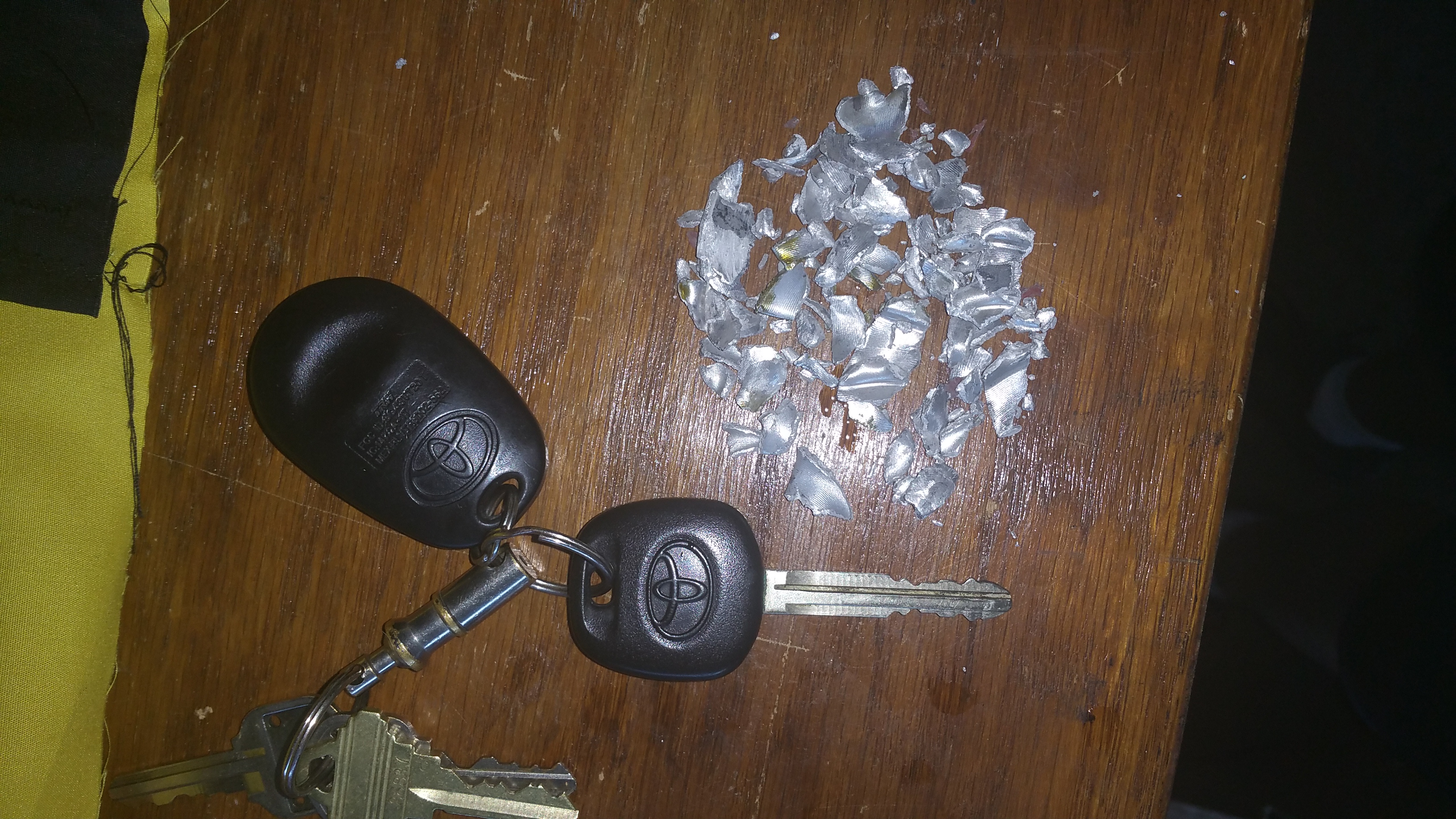

Got the turbos from the mechanic. Was getting ready to box them up when I heard loose metal bits. Rolled the failed turbo and all this came out. This is good as the more I find the less I need to track down in the engine. Shipping both turbos back to TiAL. Mechanic looked at bolt and first thing that came to his mind was that the nut was overtightened as well. We'll have to see what TiAL's ruling is now.

Tial is a PITA to deal with and will normally never take any blame. Just giving you the fyi. Best of luck, thats a sh!tty situation.
