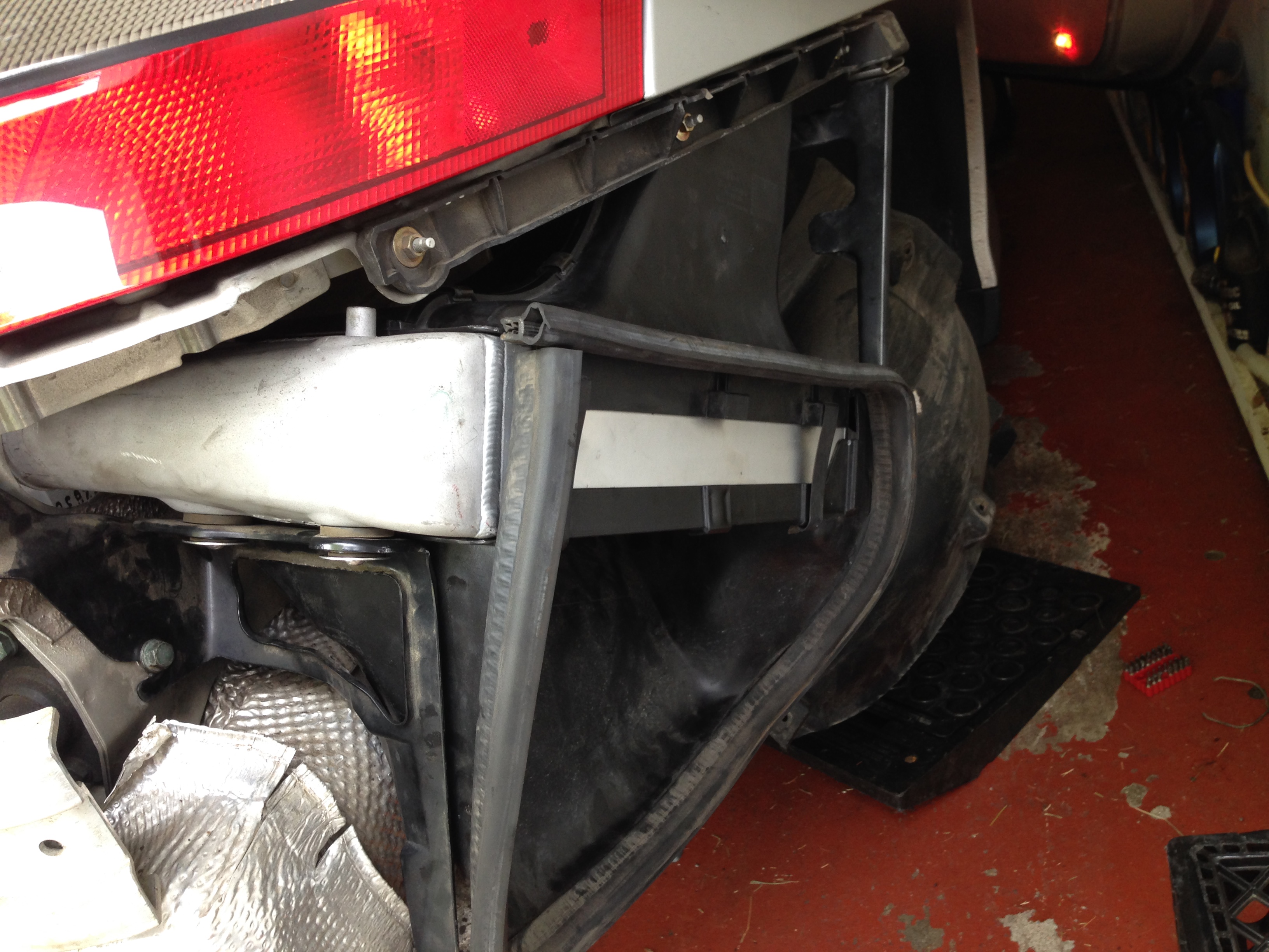

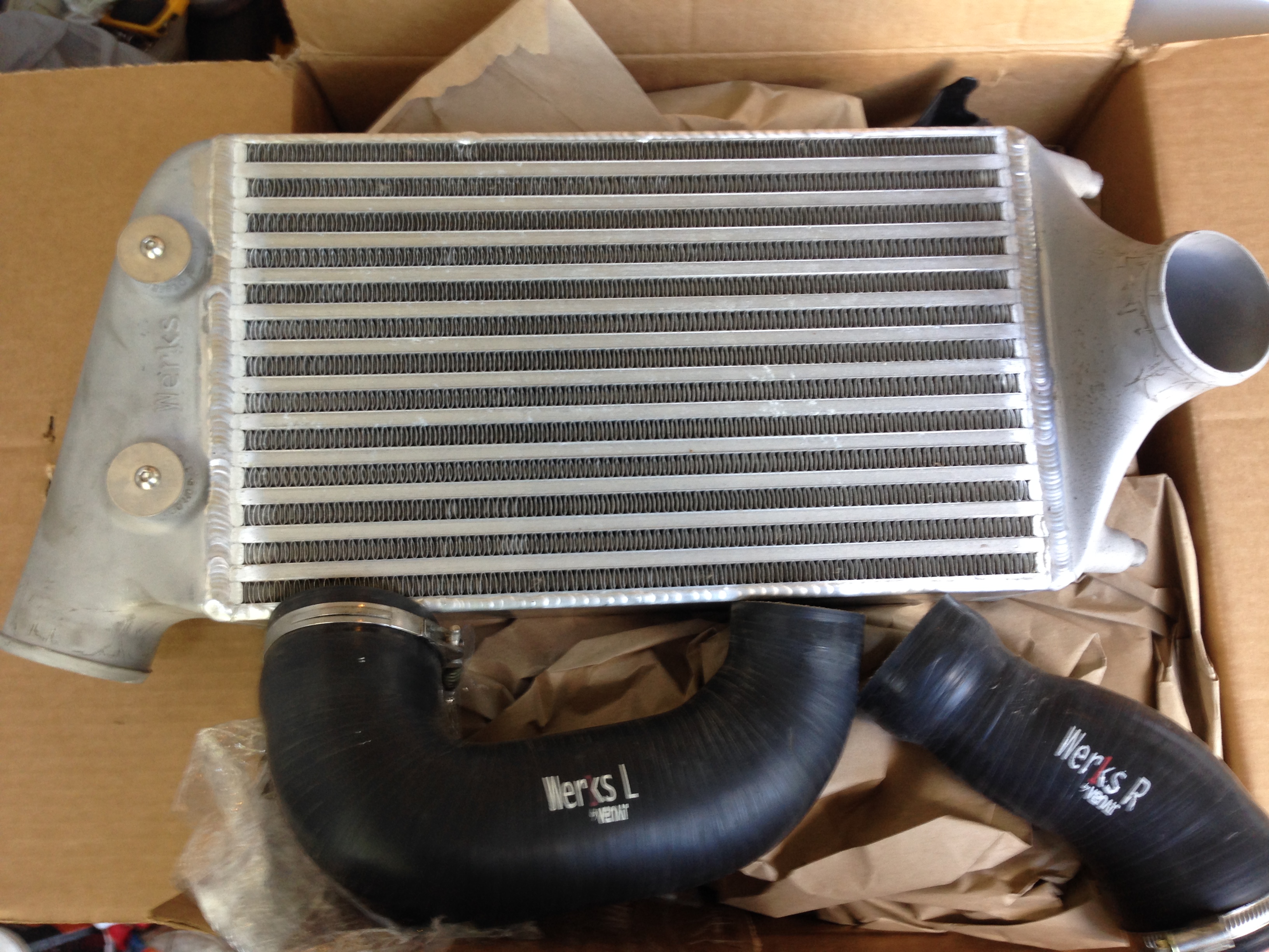

Just an update if anyone comes across these Intercoolers.
I fitted the Gen1 Werks1 Intercoolers to my 996TT.
I used the Wagner Intercooler hose kits which fits perfect.
http://www.wagner-tuning.com/-NEW--S...996_p_179.html
A slightly cheaper option for hoses may be http://www.ebay.com/itm/371451577993
but they may be slightly shorter as the ebay ones are made for the stock intercooler couplings.
