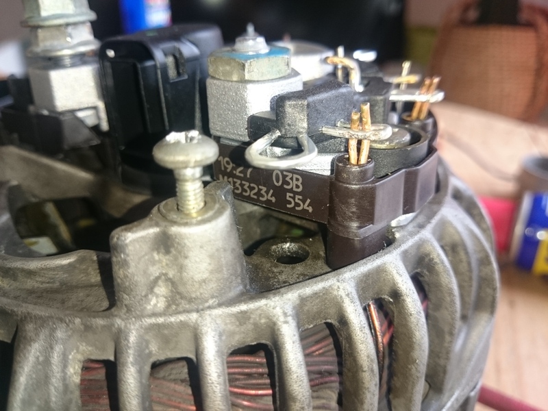

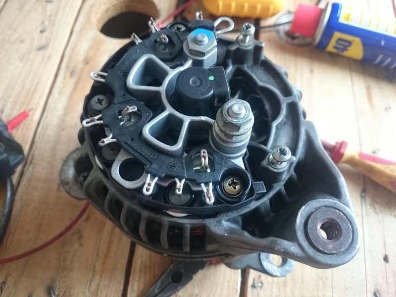

I had the same problem with my car some weeks ago.
I first changed my regulator but the problem was still there. I had to take my alternator down a second time and then change an other part.
I don't know the english word for it, but look at it:
It's really easy to do.
The reference of the part is no longer the same. You can buy it in a Bosch center.
Here is the new ref: 133234
