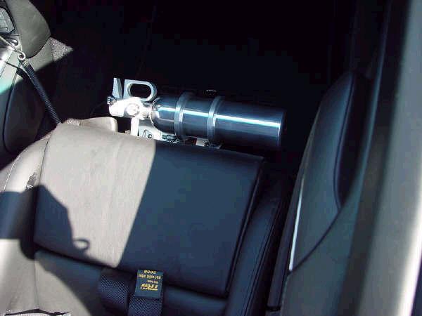

http://www.6speedonline.com/forums/showthread.php?s=&threadid=1668&highlight=safecraf
do a search guys, it's all here.
safecraft ext
billet mount
b-k sub bars and brackets
i had this rig in my last gt2. easy, straightforward, done on gt3 seats w/ no hassle

Watt;
Thanks for the reference to your earlier pictures.
I understand Safecraft’s extinguisher & billet mount. The "b-k sub bars and brackets" & how they work with the GT3 seat brackets and sliders are what I am trying to resolve.
I know B-K says we must buy their seat mount brackets, but frankly they don't always know everything about what they make and how (or why) it goes together.
There seems to be no question that the B-K anti-sub bar bolts directly to the STOCK sliders. We know we need the B-K anti-sub bar and we need the extinguisher mount from B-K. Why must we replace the brackets (that come with the seat securing it to the stock sliders) with the brackets that B-K sells (that secure the very same seat to the very same stock sliders)? They both bolt to the seat at the same location and they both appear to bolt to the sliders at the very same location, so what is the difference? Why must we toss out the ones that came with the seats and buy B-K’s?

Doug,
I'm not clear as to what you are saying. The BK sub mount has the brackets to accept the BK extinguisher mount. You also need a small bracket to adapt to the Safecraft billet FE. The stock bracket that comes with the GT3 seats will not work, it doesn't have the mounting holes for the BK bracket.
No need to change the sliders, unless BK has changed something.
The pics watt has posted is of my set up. I had installled the one on watts also. I'm positive it will work. Unless there have been some changes.
