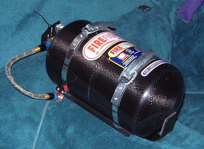

Doug, You are correct in the parts needed. Technically all the parts get mounted together with the studs from the sliders, seat brackets,and BK sub mount. You will see what I mean when you do the install. If you have any questions or problem during the install, just holler.
Robert, nice CF tank. I assume you made it?

Oak:
Actually, in this instance, I asked to have it made. In this particular case, two more weight saving items are the lightweight hose and the lightweight bracket. Finally, on a related note, we are looking at the hydraulic accumulator that is part of certain brake systems and with respect to which, albeit a relatively small amount overall, a weight savings of 50% to 70% may be achieved through the use of carbon fiber. This, however, is not a piece to be taken lightly as pressures within could spike to in excess of 250 bar.
