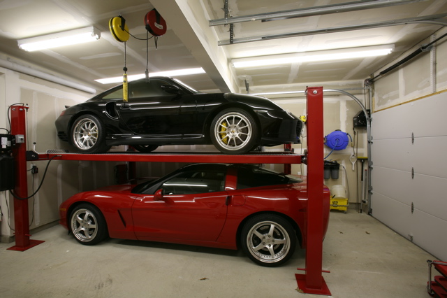

Originally posted by BartN (TX)
Your garage looks great however I'd want a lift to facilitate storing 2 cars in one bay instead for maintenance work.
Ah, you left that piece of info out.
This is my current solution but you need a higher ceiling. More like 10' and a few inches. Also two very low cars.
