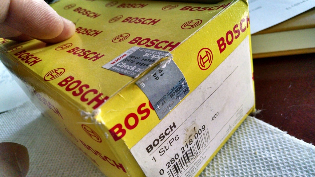

Hey Mark, mine had the waxy paper as well.
You can check online to see if your bosh part is genuine by entering the correct numbers. https://www.protect.bosch.com/Default.aspx
https://www.6speedonline.com/forums/...ml#post4379838
This was posted by mxracer
"That is the "correct MAF" for a 996 turbo but beware...
It should come in a multi-colored Bosch box WITH a Bosch KeySecure sticker on it, that you can verify here.. https://www.protect.bosch.com/Default.aspx
If it comes in a yellow "Bosch" box and does not have a real KeySecure sticker, 99.9% it's not going to work. There are TONS of knock offs out there, I went thru 2 of them before finding a real one from a local shop."

If it doesn't come in a yellow box, with red "BOSCH" lettering, with a keysecure sticker over the edge, wrapped in brownish wax paper, don't even take it out of the box.
