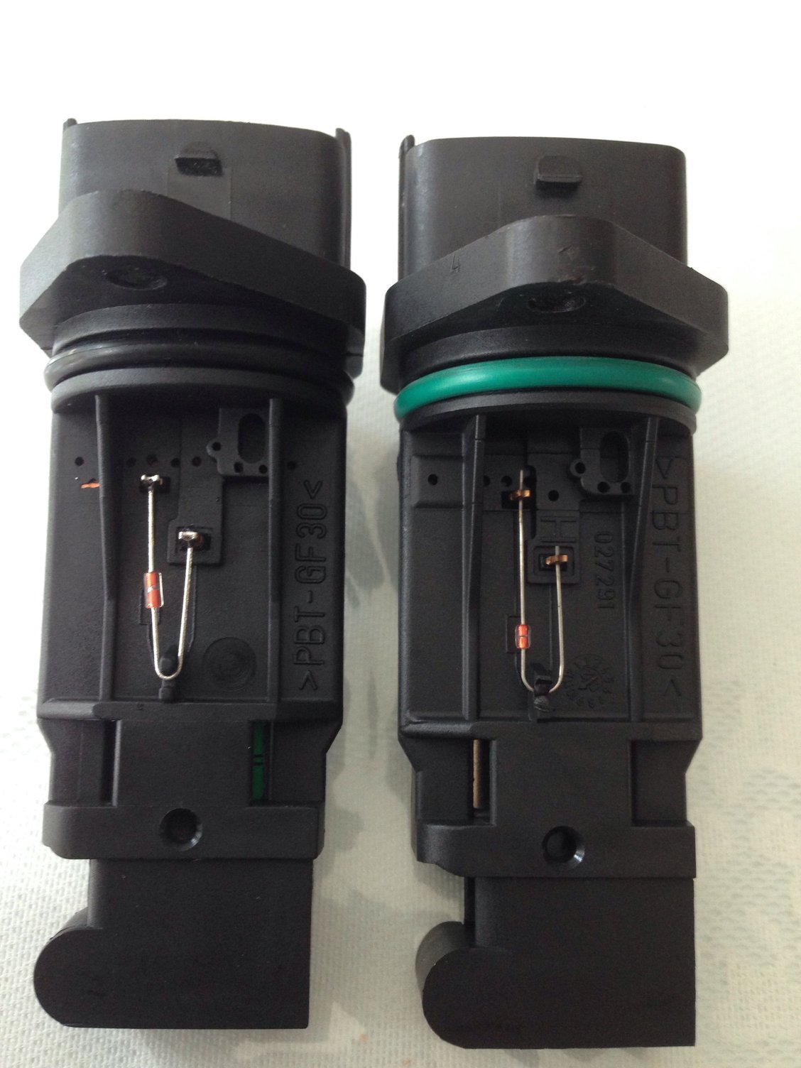

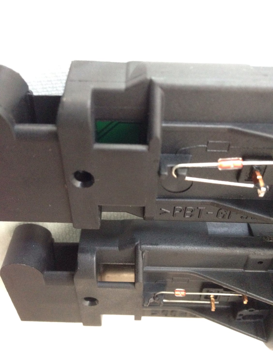

Here is the packaging..
Here are the two side by side. You can see differences..
OEM to the right. You can see the diodes are different sizes.
Here you can see the replacement doesn't have a metal shield over the board in the slot. Not sure if that metal has any function with metering air.
And finally the wires inside are different.
OEM:
Replacement:

Interesting, it's all in the details. I just took mine out over the weekend and cleaned it with CRC Maf cleaner so I just looked at mine and yeah that metal shield inside definitely was there as you show in the 2nd and 3rd pics.
Wow....Pretty crazy to go through all this trouble to make them look real but they don't even work Pointless.

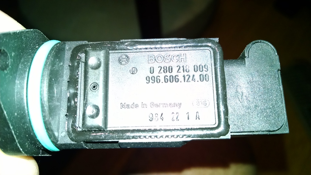

OP. 2 things: First, check your MAF connector. I've heard of the pins coming loose or breaking. Make sure you have the right voltage on the right pins. Second, while I haven't had my 996 turbo for years, I THOUGHT I had a MAF problem, so I bought one. Turns out I had a bad vacuum leak and never used it. Just went downstairs and found it, brand new in the box, Bosch, with the green O ring. Because of the issue you've been having, it's yours if you want it. PM me.
