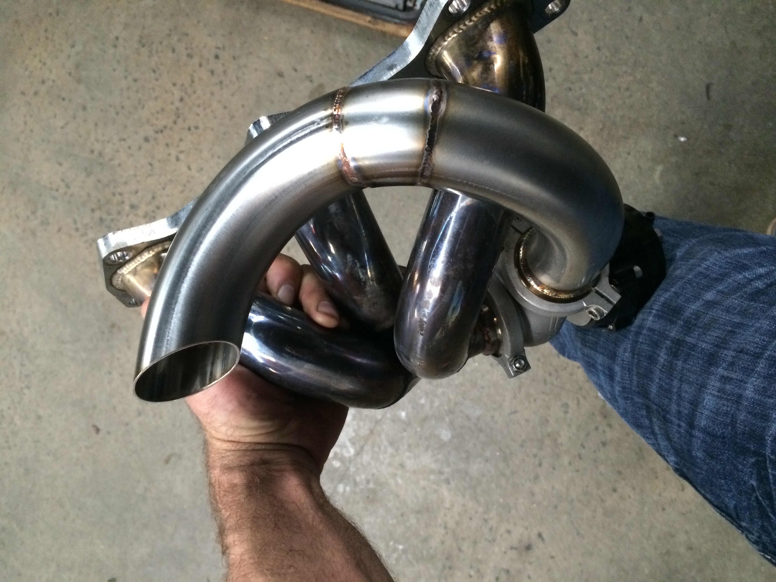

I'm looking for options to quiet down my external wastegate outlets which currently dump to atmosphere. Has anybody tied them back into the exhaust or installed small mufflers on them? If so, I'd be interested in hearing about or seeing your setup.
Thanks

thats the only way , route them back to the exhaust .

heres mine. just giving the sound a place to go
ID:	427468   Click image for larger version

^^^mine are similar...To OP. Just fab up some connector pipes that will route it into the exhaust outlet. It should muffle the harshness of the open wastegates a little. Of course it will depend on your exhaust setup as well. If routed into exhaust pre-muffler...that would help the most obviously.

I have tubes that vent down kind of like that. Routing them into the exhaust seems like a hit or miss. Where do I go in, before the cats, after the cats, before the Xpipe, after the Xpipe?
This is what I was thinking of installing on the ends of the dump tubes. Heard of some Suburu guys installing them resulting in the noise reduction. They're motorcycle supertrapp diffusers. Just not sure about them creating back pressure.
Is this a bad idea?

Careful restricting that too much, your wastegate will be less effective if corked up too much.

That's definitely a concern but that seems like the easiest and most reversable add on I could try first.

I wouldnt do that....but thats me. I would be afraid it would cause boost creep issues.
I see people are using it though, what are some results?

Porsche 930 turbos used a small muffler on their EWG, but they're about $500 a piece and would require alterations.
I read a long Subaru thread and every person that tried the supertrapp diffusers were pleased with the results, including some big builds. Not one person reported having any adverse effects.
So, I just ordered a couple and I'm going to give them a try. If I remember, I'll do a before and after drive-by for anyone that might be interested.

Undercover did a great job on mine, routing them through the exhaust

Yeah, those look great! Can you even hear them when they open? Do you have cats, I can't tell?
