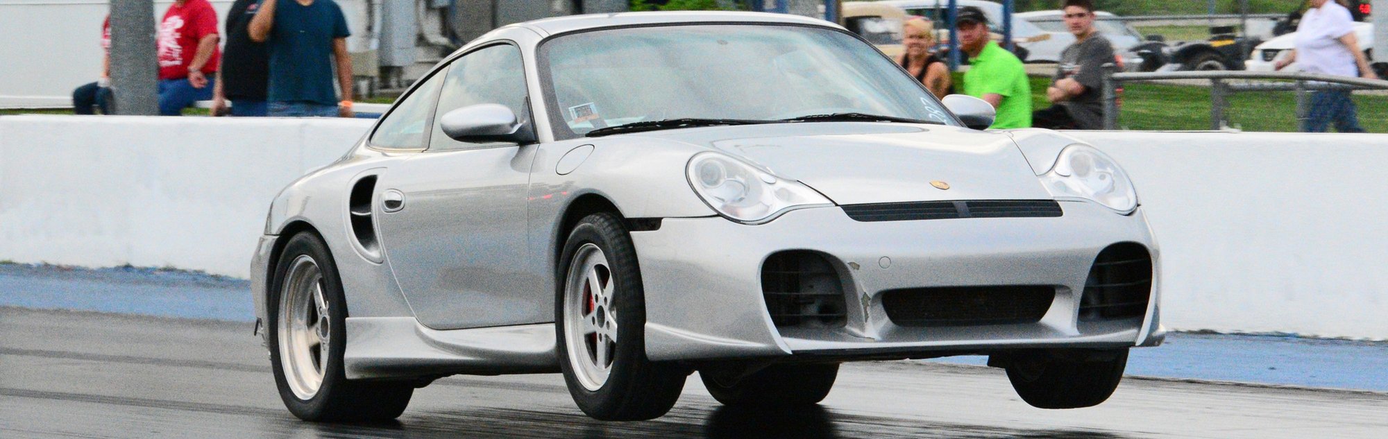

keep it 6 speed, do a tiltpn triple carbon clutch, pay a stand alone ecu and you can play...
here is my 6 speed stock ecu with a tilton, some trans work and decent axles..
2001 996TT 3.6L and stock ECU
9.66
seconds @ 147.76 mph 1/4 mile
click to view
