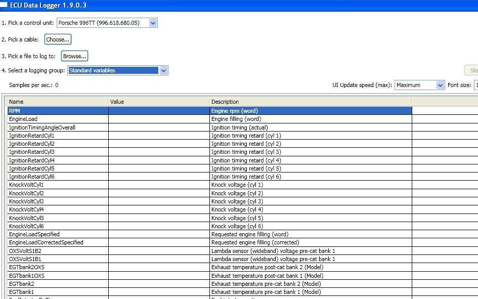

in fact it seems Tony provides sth. very similar. The patch I mentioned is indeed in the code segment of the DME enabling the upload of the memory reader subroutine.

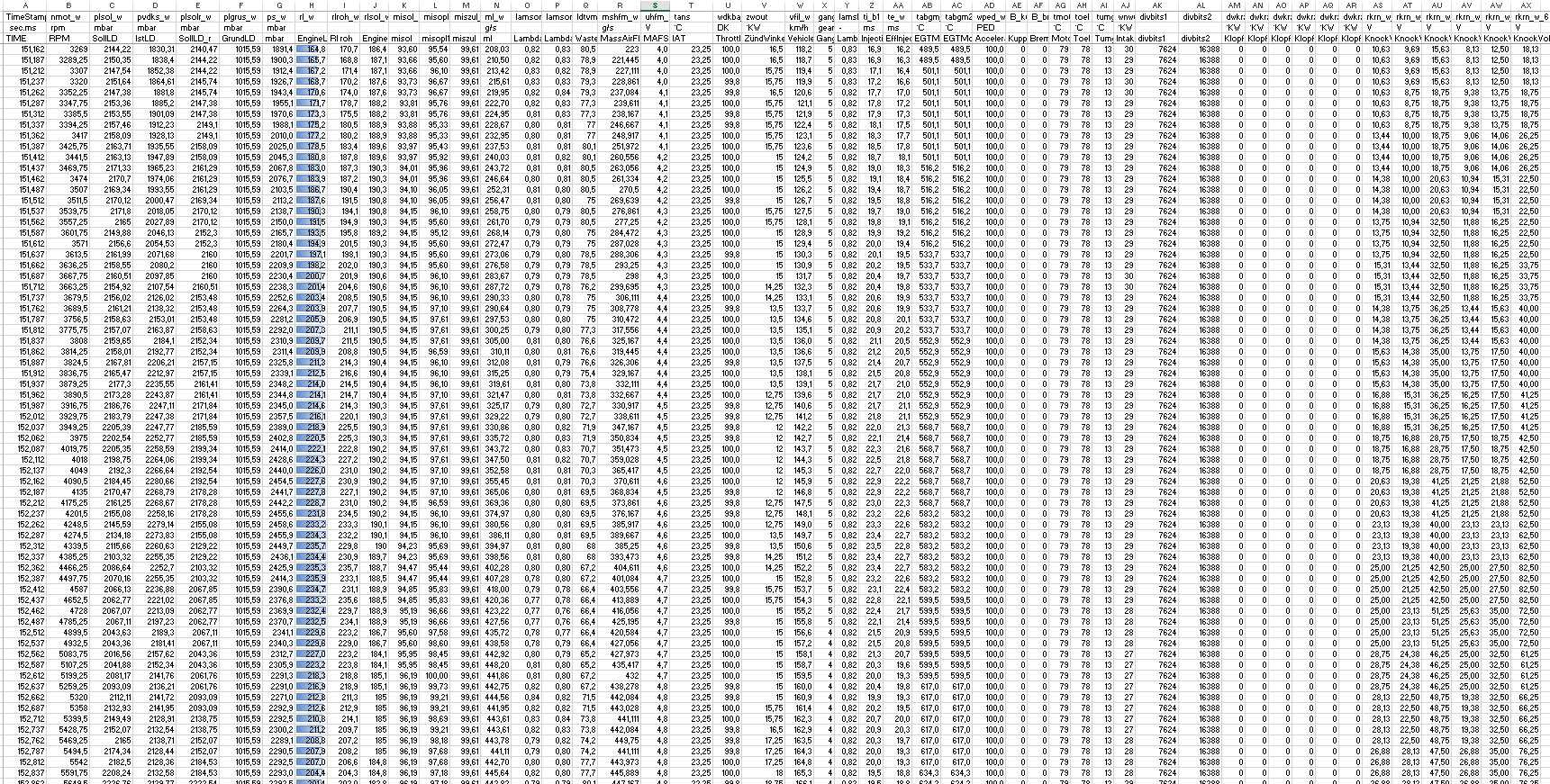

I did logging the knock voltage of each cylinder as well, as it gives a slightly better feeling of how close you are to the knocking angles. Did you also experience a single cylinder to always send higher knock voltages than the others and have an explanation in mind?
Here is an example after inserting the log data into excel an examining a WOT run. this sample was logged with 40 Hz and roughly 50-60 values per sample already hiding some less important.
When you narrow down your concerns to certain parts of your tune (PID fine tuning, knock, shifting, Rev-limiter, fueling) you limit of course the full set of possible samples (>700) to below 100.
Name:	log example.PNG
