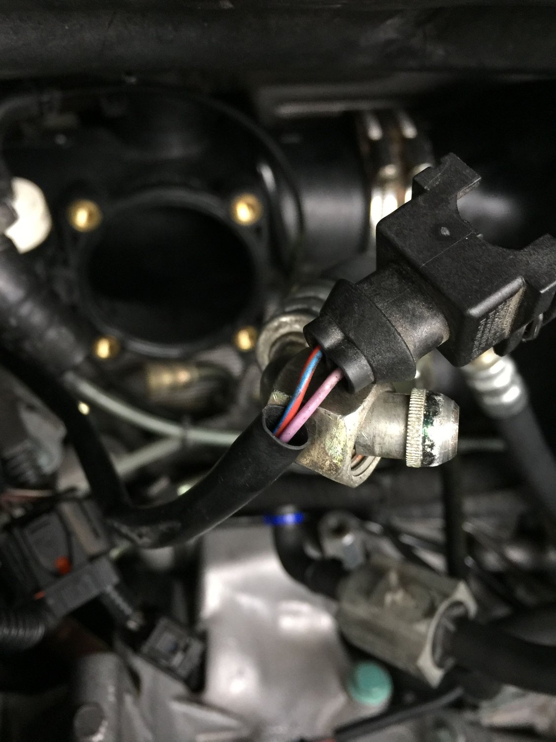

What does this plug go to?

Here's the other side of the plug.

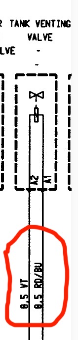

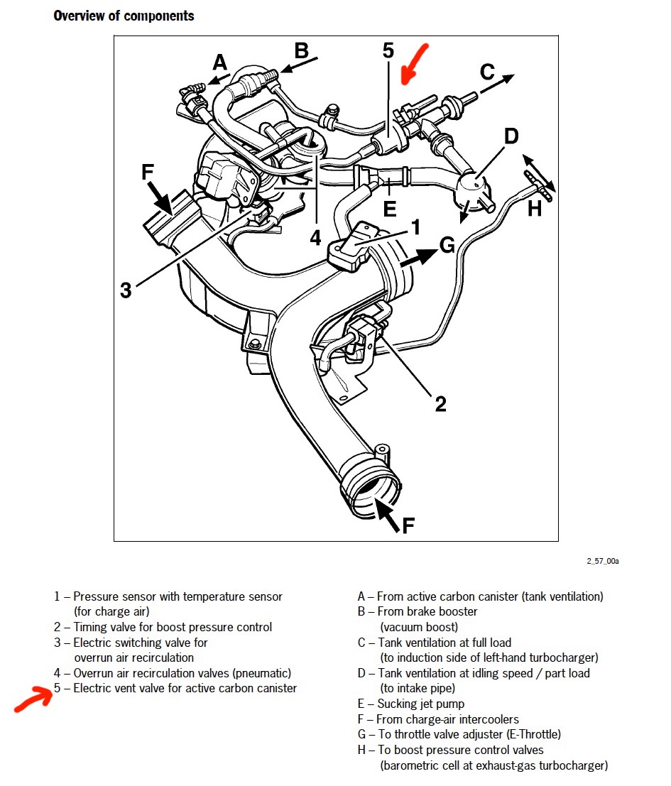

Some more info for a possible location:
Name:	Screen Shot 2015-12-22 at 12.21.57.jpeg

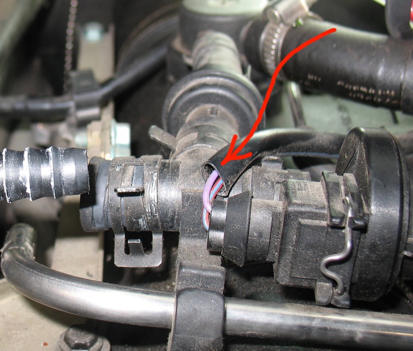

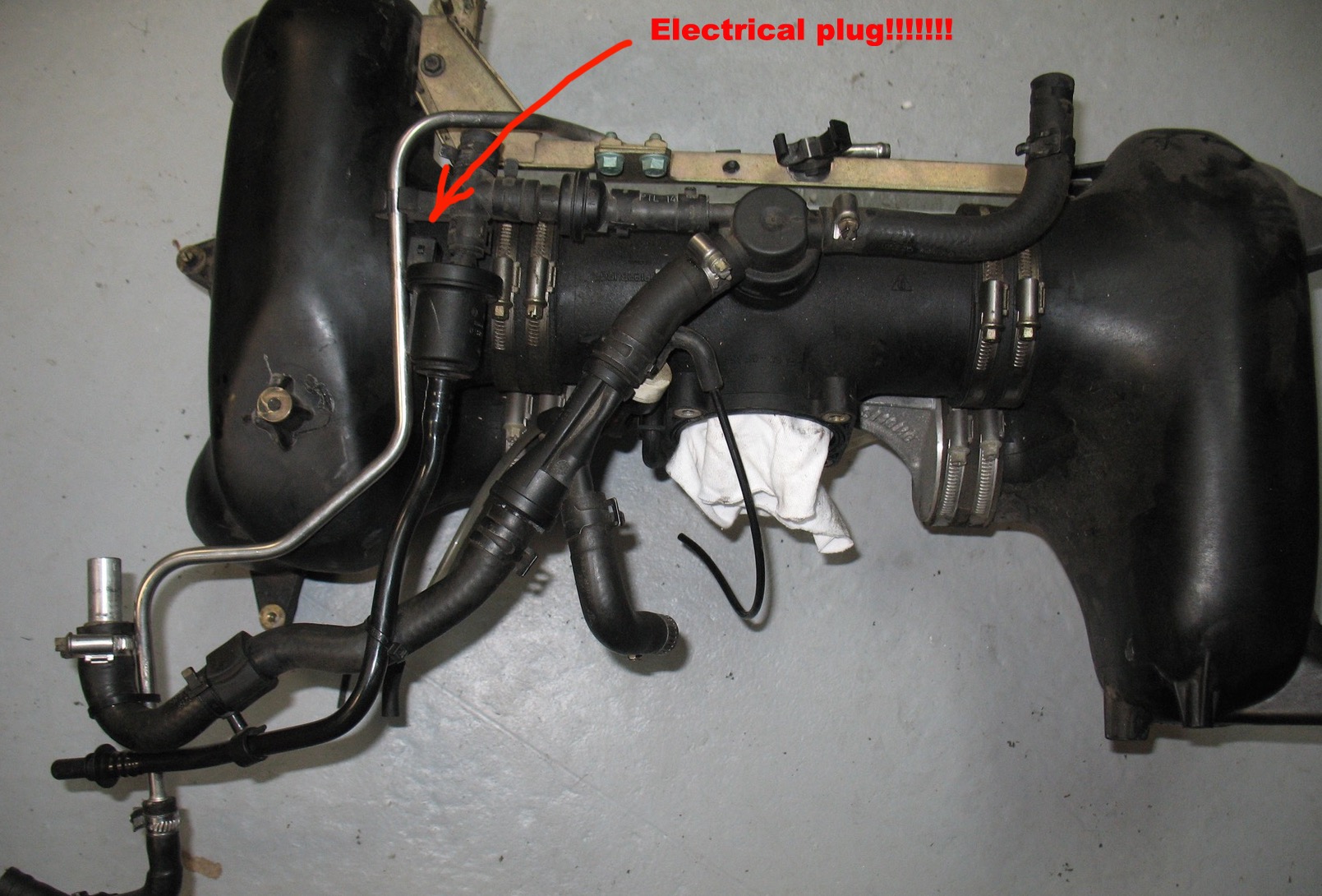

I think this is the plug position you are looking for!!!! Tank venting valve!!! A red/blue wire and a violet wire!!! This one looks good But probably difficult to reach. May be you should lower the engine a little bit (4 inches) to reach it.....
Name:	Screen Shot 2015-12-22 at 13.19.18.jpeg
