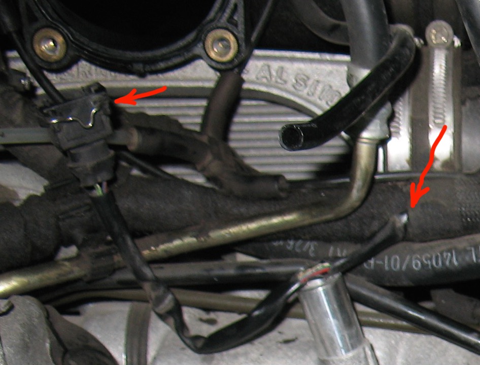

What does this plug go to?
Does anyone know what this plug attaches too?

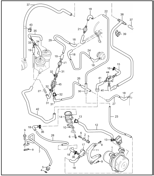

Looked at the parts diagram, but it doesn't really show electrical plugs origination points. Oil temp sensor, coolant temp sensor and the actuator connecting to the Y pipe are all connected. It's not like the plug will reach very far and there's not much there.

Engine bay temp sensor?

Will it reach the camshaft actuator solenoid?

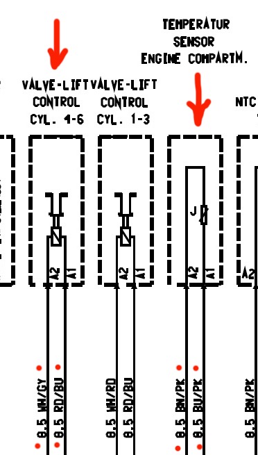

Would like to know the color of the wires. I think I can see a red/blue wire and a white wire. That goes on intake pipe change over valve which is a small gray unit near the air cycle pump.... For the other suggestions from sinKing and 06turbo, if the wires are white/gray and red/blue it is for the valve lift solenoid cylinder 4-5-6 and if the wires are brown/pink and blue/pink it is for the temp sensor.....

The wires are actually red/blue and green/white.
I don't believe it connects to anything on my motor. but I started second guessing myself. If it wasn't connected to anything, than what was it for?

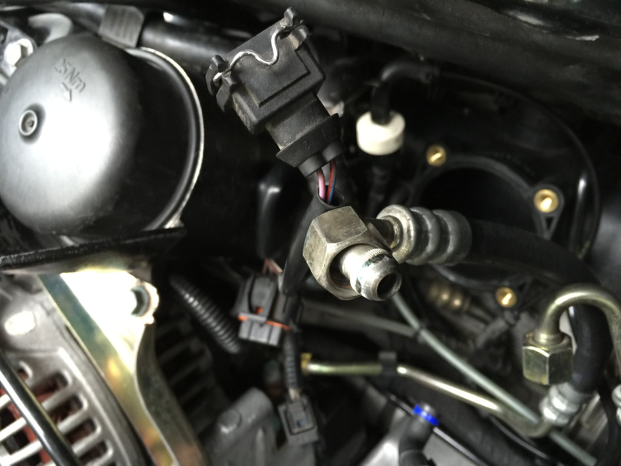

Look at this picture of my wires going to the N75 valve. Yours seems to come from the same place??? Are you sure you got the proper plug on the N75? I think you cannot make mistake with the plugs but I'm not sure....I have found my wires damaged, you can see the colors.... Last a/c pump change the mechanic got the wire stuck between the pump attachment and the case.....

I show three valves it the diagram.
17, 44 & 45
All three are connected.
Any idea which one should have the RD/BU and WH/GN wire?
That is definitely the wire and it will plug onto the N75 valve. I guess I need to figure out where the wire I have plugged to the N75 valve goes. It's blue/red - grey??.

Hum...I don't see any wires solid gray anywhere???? You cannot see a little green line or brown line on the gray wire?

Here's the plug/wires. I the picture is actually looks like it's a blue/red - Pink wire.

It's definitely a solid color wire and come off the harness at the same place as the wire for the MAP sensor and throttle body plug.

The is another valve not far, called a change-over valve, just under the diverter valves that also got a plug....I'm still looking for this pink wire.....
