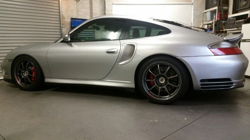

Picked up a set of used OZ racing wheels off a GT2 with Nitto NT01 235/40/18 and 315/30/18, rear tires are about 30% to 40% worn and the front about 10% worn.
My 1st question is are these sizes OK with my AWD.
2nd question these are noisier than an old truck, extremely noisy at any speed. Is this normal or is it possible its rubbing on the inside guard liners or something else?
Thanks in advance.
Jim

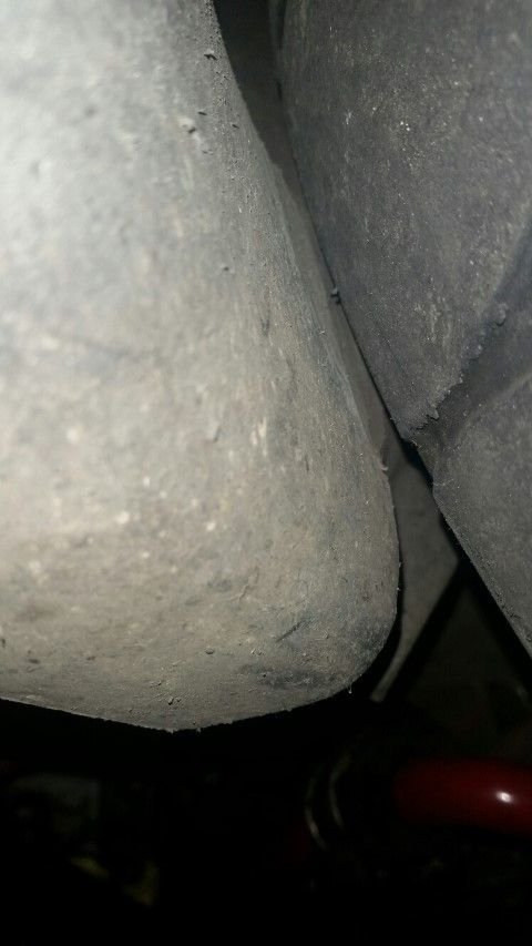

Just checked clearances and found that the lower section rear liner is very close to the tire,there is only about 2 or 3mm clearance on both wheel arches. I pushed through a 2 to 3mm piece of cardboard to check clearance, its reasonably tight but it does push through.

Jim,
Those tire should not be too loud. Louder than a full street tire but nothing alarming. You need to remove the liner and bend the attachment brackets back so that they will pull the liner nice and tight against the IC hose. Just reach in there and push on the liner and you will see there is room behind it. Over time the TT brackets get bent out and create clearance issues. You will have to remove the brackets to bend them. Bend them more than you should so that they actually lay against the IC hose with some force. When you bold the liner on, it will pull it away slightly. Better yet, just install the GT2 brackets which create even more room. The liners are the same part, TT or GT2. Adding a 5mm spacer in the rear also helps making the offset ET40. You should not get any rubbing whatsoever if you do this especially when using the short 315/30 tire. I run rears that are 1.2" larger in diameter at a much lower ride height and have no issues whatsoever.

I've posted this numerous times over the years. Lol. They should make this a sticky. Yes, the TT and GT2 liner is the same exact physical part out of the same mold. The only difference is that unlike the TT version, the "GT2" version has a hole drilled in the side of it for the bolt to go thought. If you can drill a hole in a TT liner, you can make a GT2 liner. The factory actually just puts a GT2 part number sticker over the TT part number that is molded into the liner.
GT2 brackets:
99650435391
99650435491
Cheers...

These tires will be loud if you have a lot of rubber pebbles stuck to them that they have accumulated from their previous sessions at the track. Once this wears off with some street driving, they quiet down. This may be contributing to the noise level also but from the pictures they look pretty smooth... Once you wear them down to this, they get very quiet..
