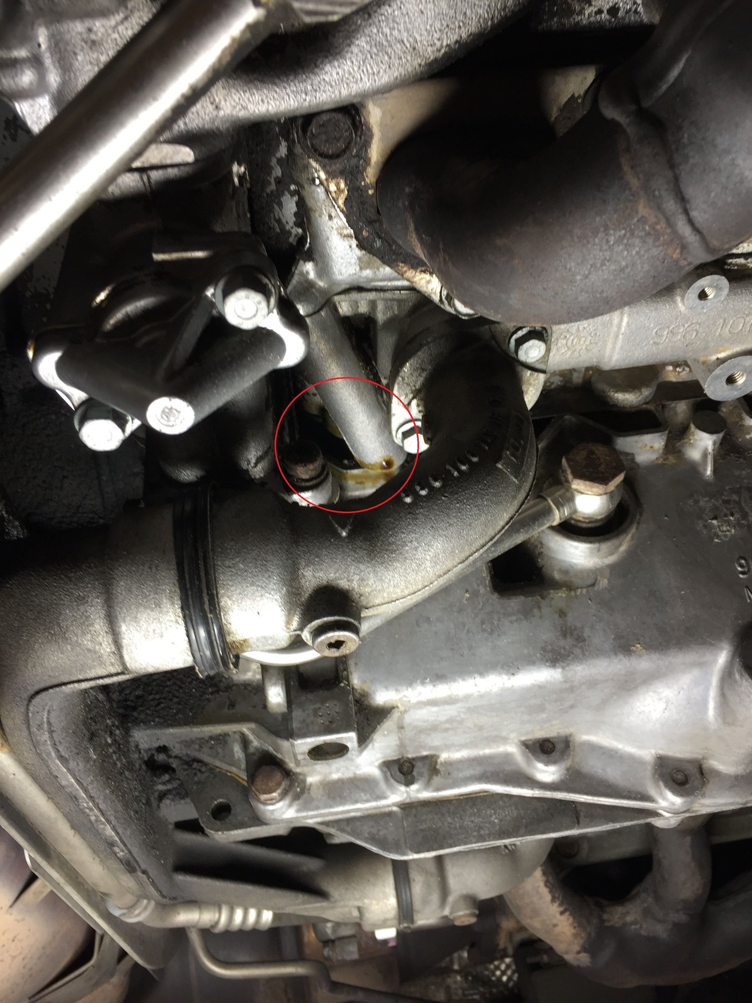

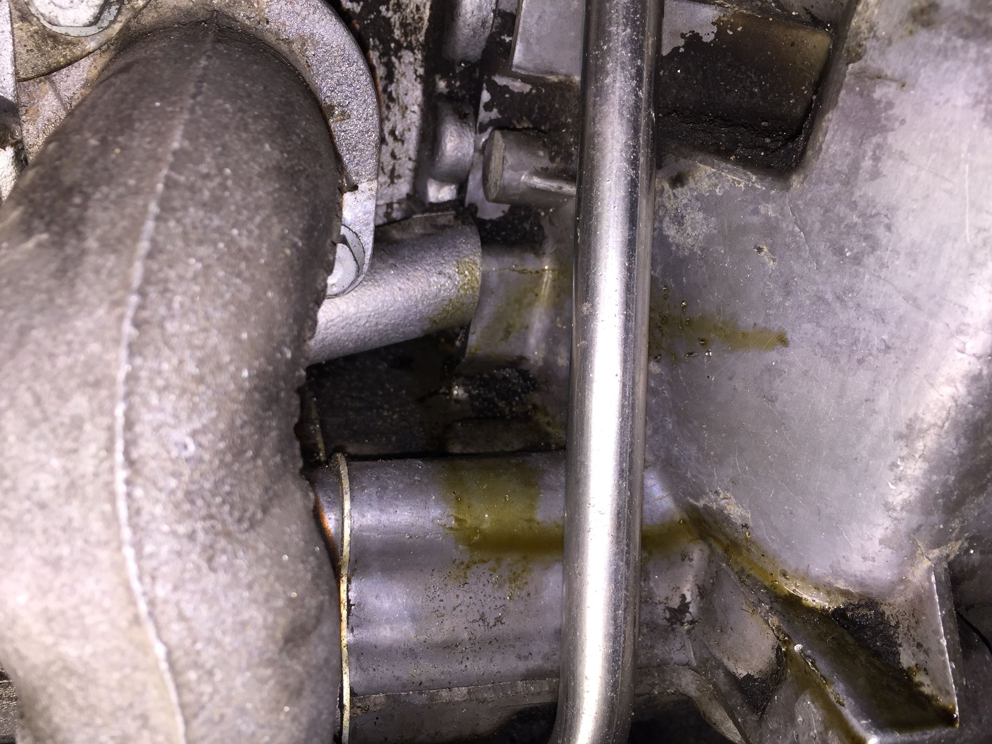

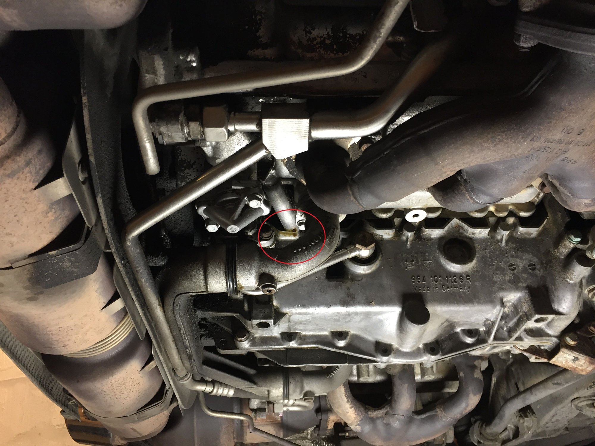

Anyway first thing I wanted to do was locate oil leak that has been leaving a small pool of oil under the right side of the engine.
So cleaned up the underside of the engine, started the car and left it idling for 10-15 minutes untill I saw first drop of oil.
The oil is coming from rear side of cylinder block..
Looks like it is the engine block to cylinder block gasket leaking on the side. But very little space between cylinder block and chain housing so it is hard to see.
Is that a common place for oil leak??
Or maybe something above cylinder block is leaking oil and the oil runs down the side of cylinder block..
Is there anything above the block that, if leaking oil, could cause oil to take that route?

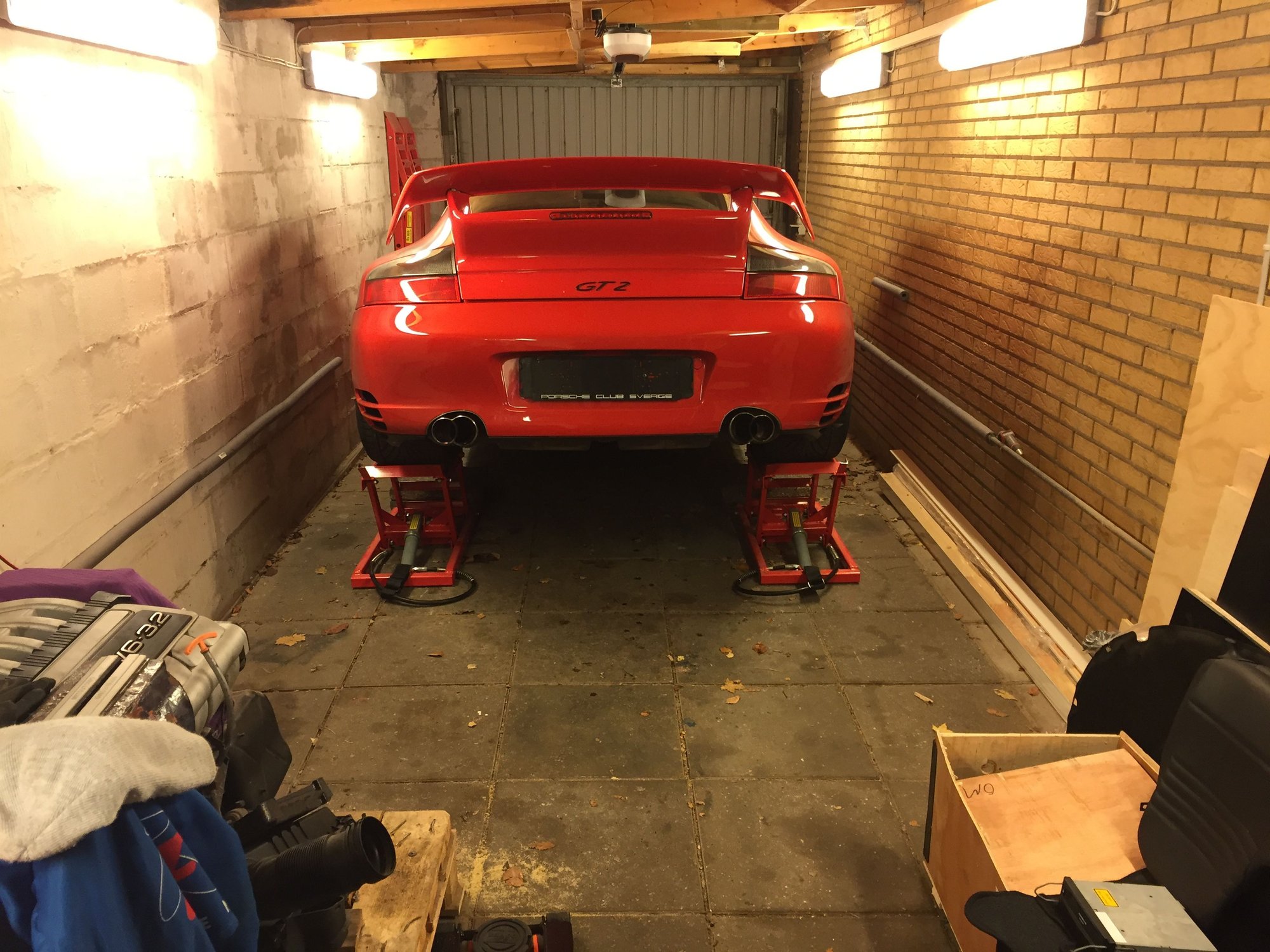

If I end up dropping the engine, I will likely leave the car on my hydraulic wheelstands.
Is there any problems in having teh car standing on the wheels with crossmember removed..?
Is it better to have it standing on the jackpoints?
I always liked it better to work under my cars when on the hydraulic wheelstands

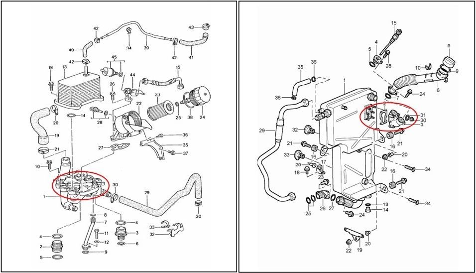

Check the top of the engine. There are 4 o-rings that seal the oil cooler to a casting that bolts to the block. When these start leaking, the oil pools on the top of the motor and eventually starts leaking down the front, back or both end of the engine.
This is somewhat typical of low mileage cars, as the o-rings do not get any oil when the car is sitting. They dry out and get hard. I just replace mine.

Old Jan 5, 2016 | 09:01 AM
Steve Jarvis's Avatar
Joined: Feb 2011
Posts: 1,075
From: Lewisville, NC
Rep Power: 110
Steve Jarvis Is a GOD !Steve Jarvis Is a GOD !Steve Jarvis Is a GOD !Steve Jarvis Is a GOD !Steve Jarvis Is a GOD !Steve Jarvis Is a GOD !Steve Jarvis Is a GOD !Steve Jarvis Is a GOD !Steve Jarvis Is a GOD !Steve Jarvis Is a GOD !Steve Jarvis Is a GOD !
For reference, here are some pictures with the areas mentioned circled in red.
