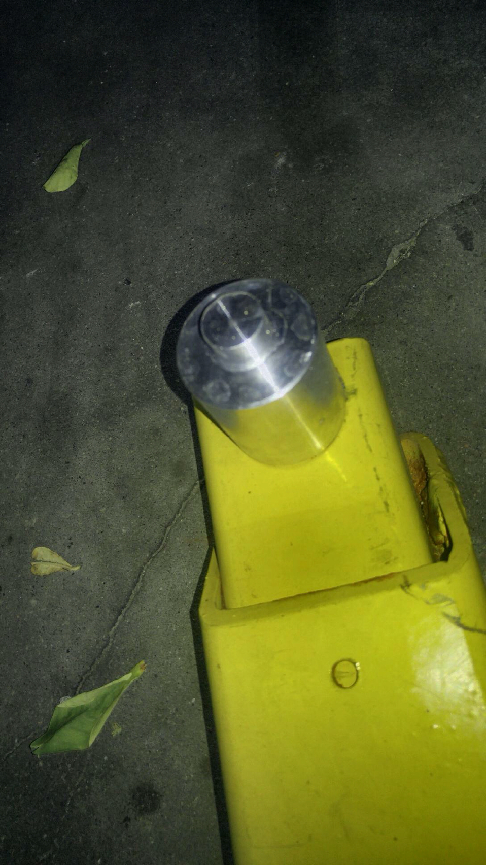

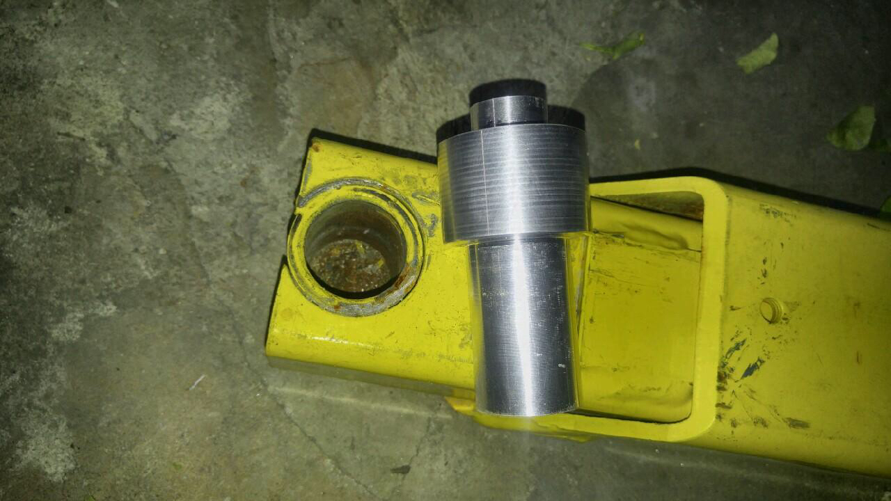

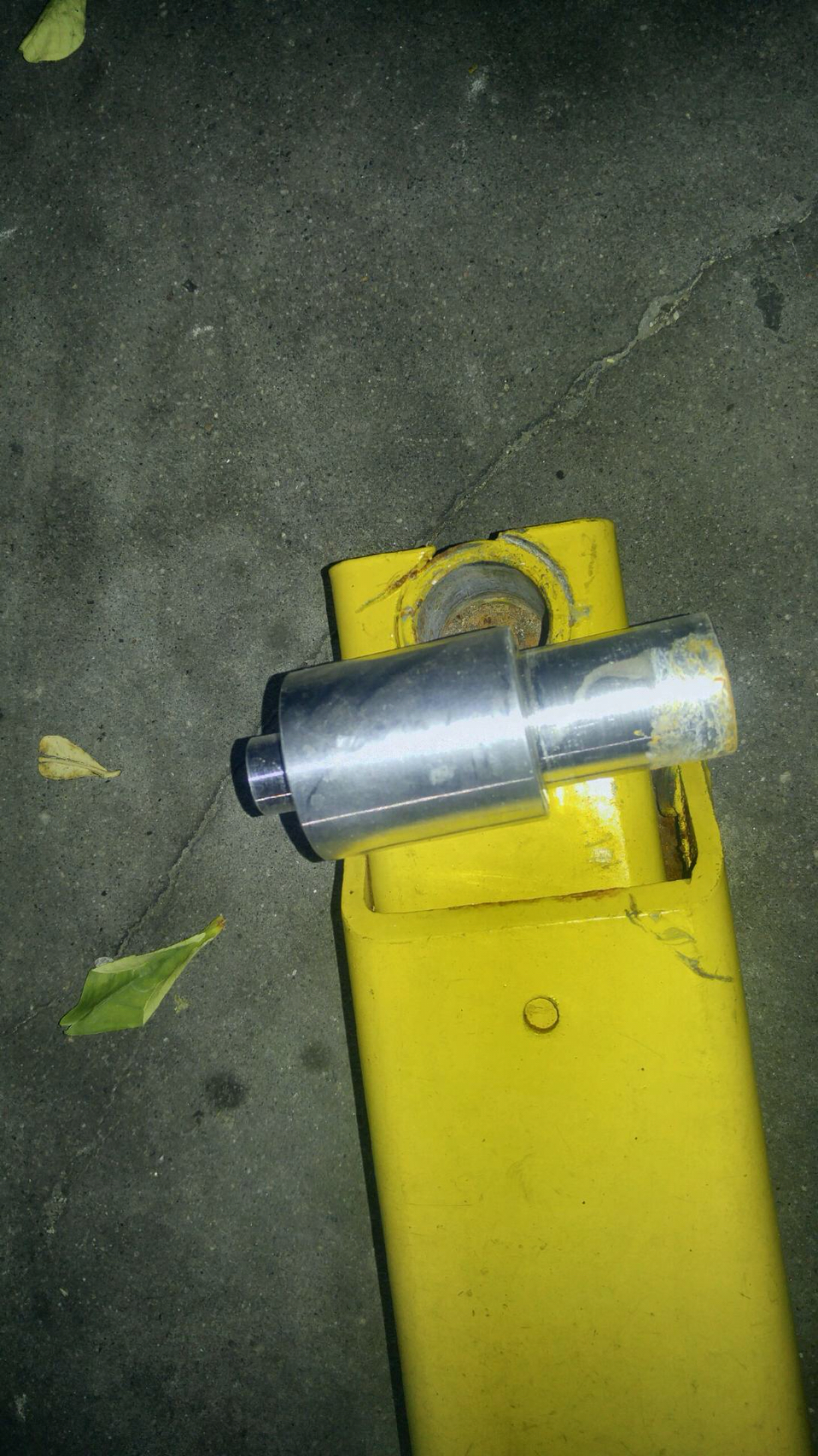

I had my buddy make me these. They fit perfectly in the jack points. Love the maxjax
I too bought the hydraulic table from HF. Very sturdy at 1000lbs capacity.

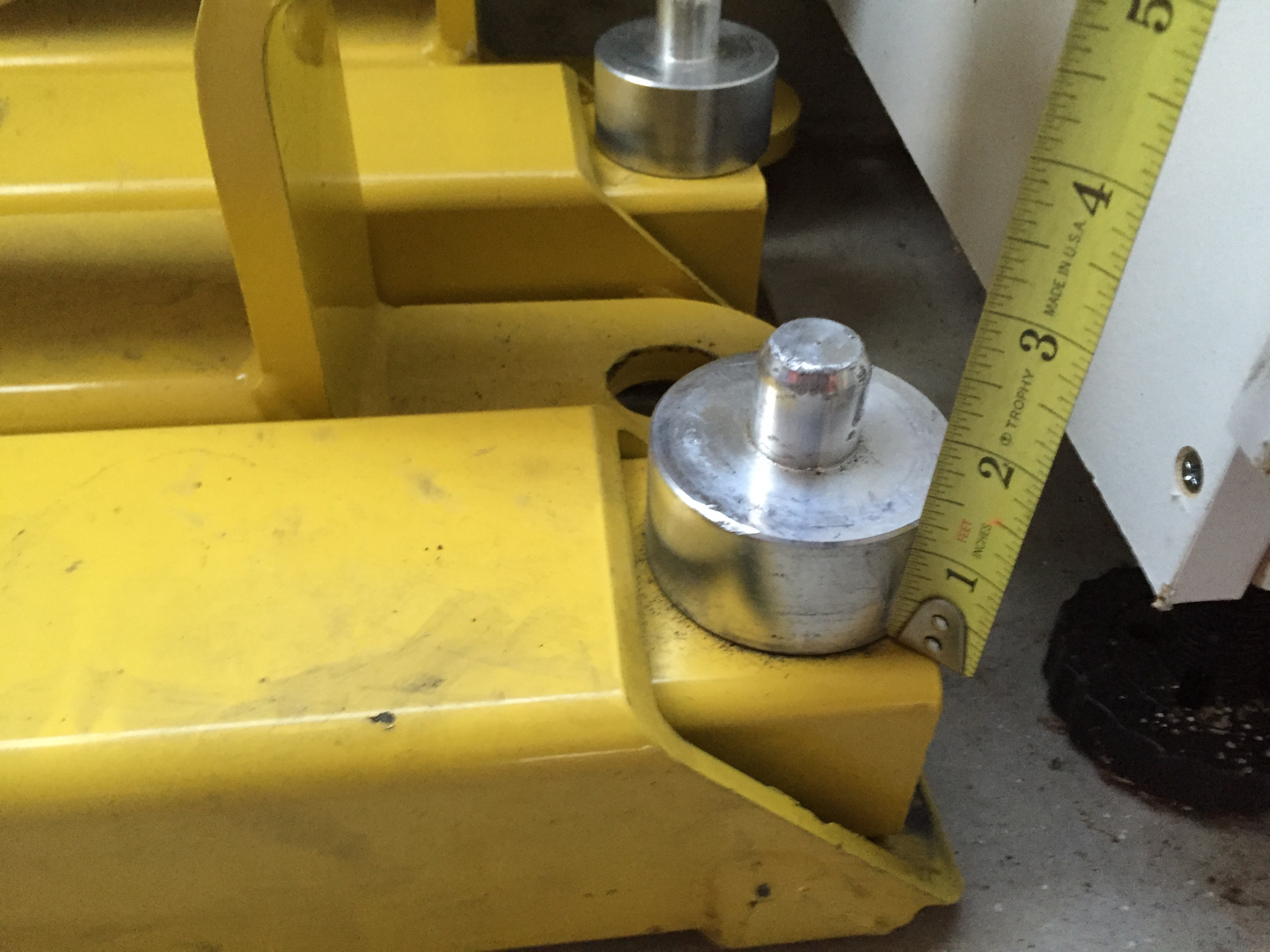

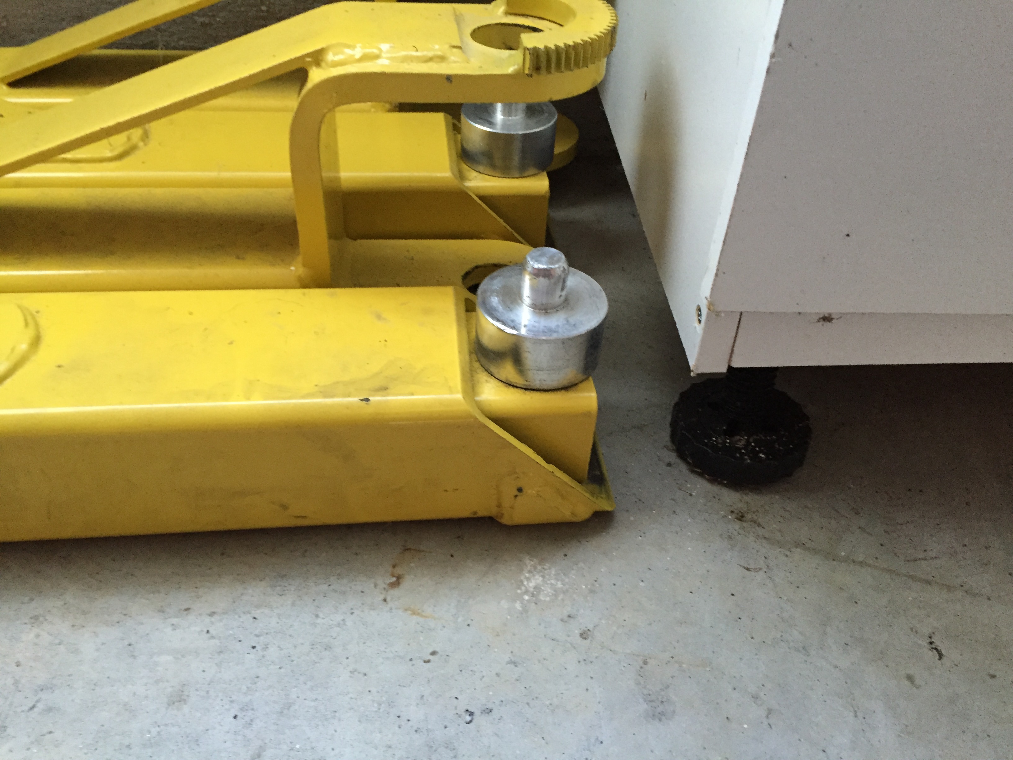

i have something similar from a member on here. those look a bit tall. i have to drive my car onto a 2x10 to allow the piece to slide under the car.

It really helps with the clearance as well since the Techart side skirts are a bit lower.

Yes I purposely told him to make them taller as I need the extra clearance

i get that you need the clearance. my point is that you cant swing them under the car when the car is on the ground. they will hit the skirts. you are going to have to drive onto boards to raise the car enough to fit underneath. mine are about half that height and they hit my oem skirts unless i raise the car.
you can of course jack the car up in the back once its placed between the lift. i find i have to adjust the car a few times for the pieces to fit squarely into the mounting holes

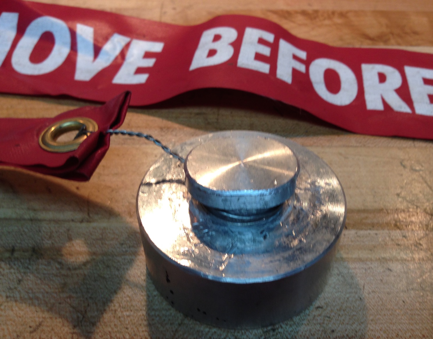

I got those on Ebay long time ago and you put them in the recess , turn 1/4 of a turn and they stay in place....But you can forgot them LOL!!!! That's why I have a "remove before flight" flag on each of them....

I use a 2x4 to drive onto and they are perfect. The reason the rear is taller was to get the car more level once lifted. Since the engine is in the rear obviously more rear weight bias the taller adapter in the rear makes it more level.
My buddy made them out of 7075 aluminum which is much harder then the 6061 as well.
