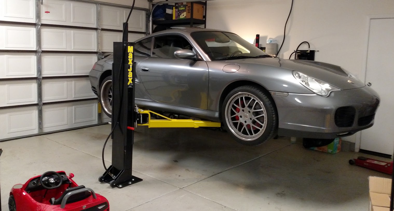

So I've finally gotten my Maxjax setup. Quite a production that took me better part of a month between the post tension slab, wall mounting the pump, and extending the hydraulic hose overhead. Worth it cause I now have it just the way I want.
My question is has anyone had success using just a floor jack to drop the motor? I see most shops use a hydraulic lift table, which I'm sure is best. Buying it is not the issue, but I'd rather not store it. I see lots using a motorcycle jack too.
With the MaxJax, could I get away with the floor jack? Possibly with a little custom platform?
Thoughts?
I do also have a low profile tranny jack.

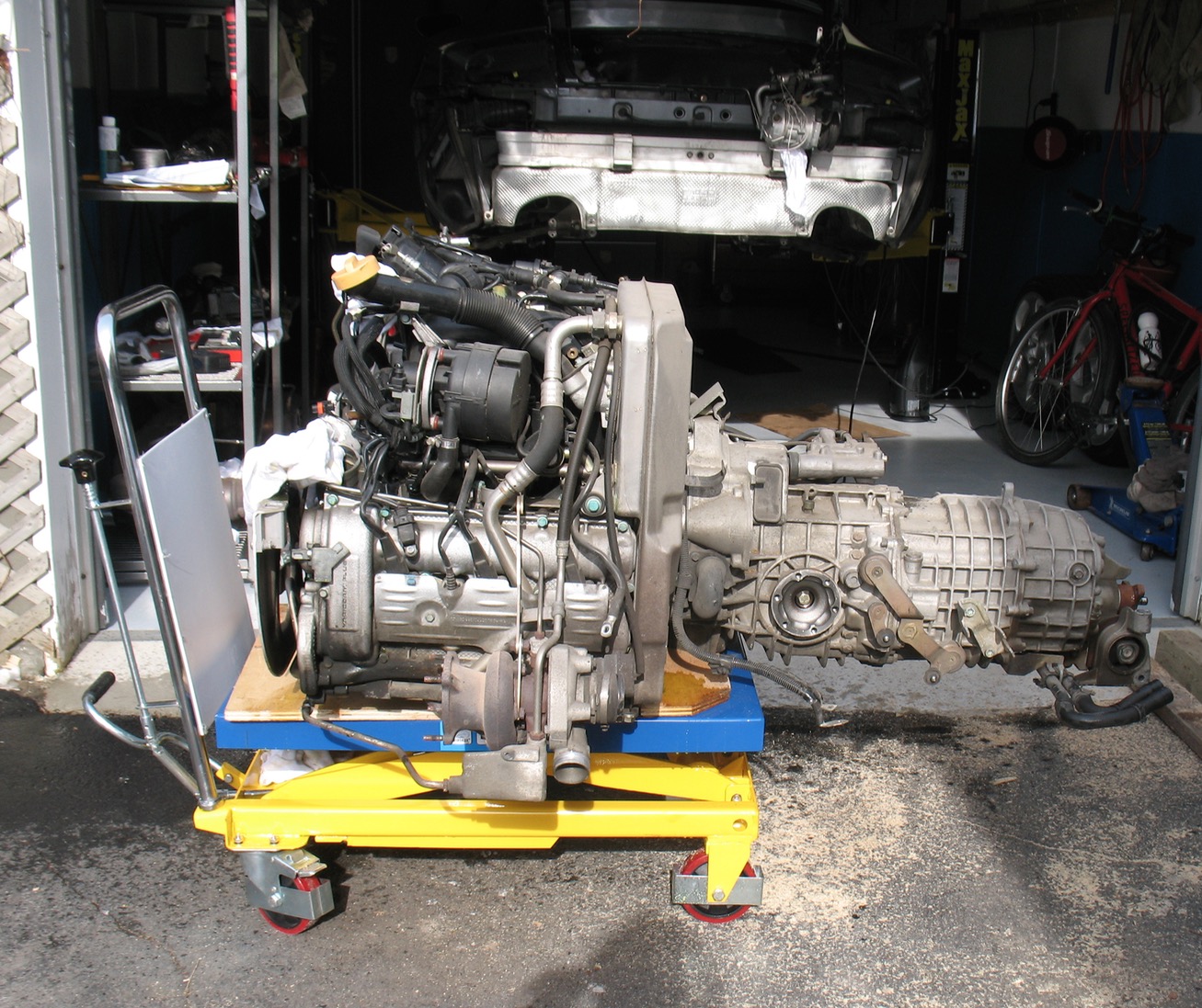

Think about it! A table is also useful to move the engine around, you can get the engine at your height to work on it and split the transmission etc... It is also more stable than a jack. I had to remove the handle bar to fit the table properly under the engine and made a small wooden platform between the engine and the table....

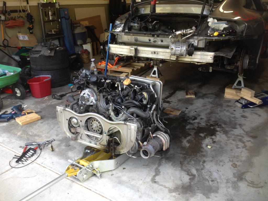

I made this form and used the motorcycle lift.
Here's a picture of when I pulled the engine/transaxle from the car. he nice thing is you can completely remove the jack handle, so it's not in the way.
Here's a picture with the lift in the up position, so I could work on the engine.

I took out and engine on Saturday morning from a 1975 911 Targa with a normal jack 18 inches wide. It was not too stable even with the small cradle we made but....This motorcycle jack seams a good option. It is wide and stable. Good suggestion from Byron and Steve!!!!
