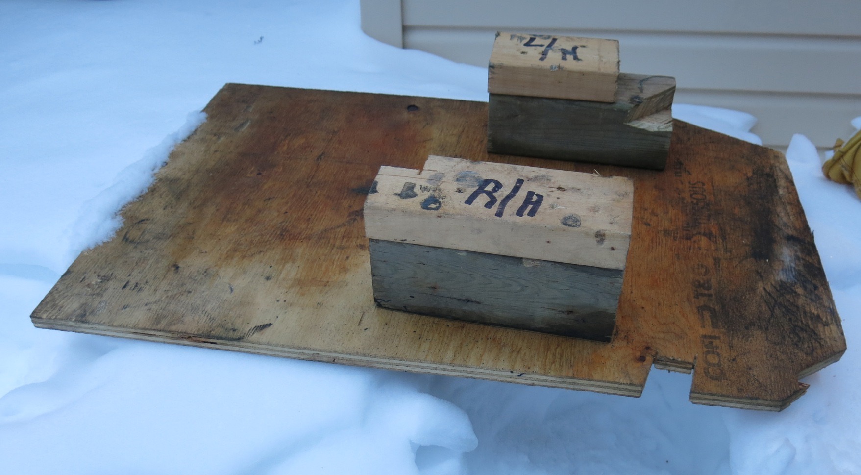

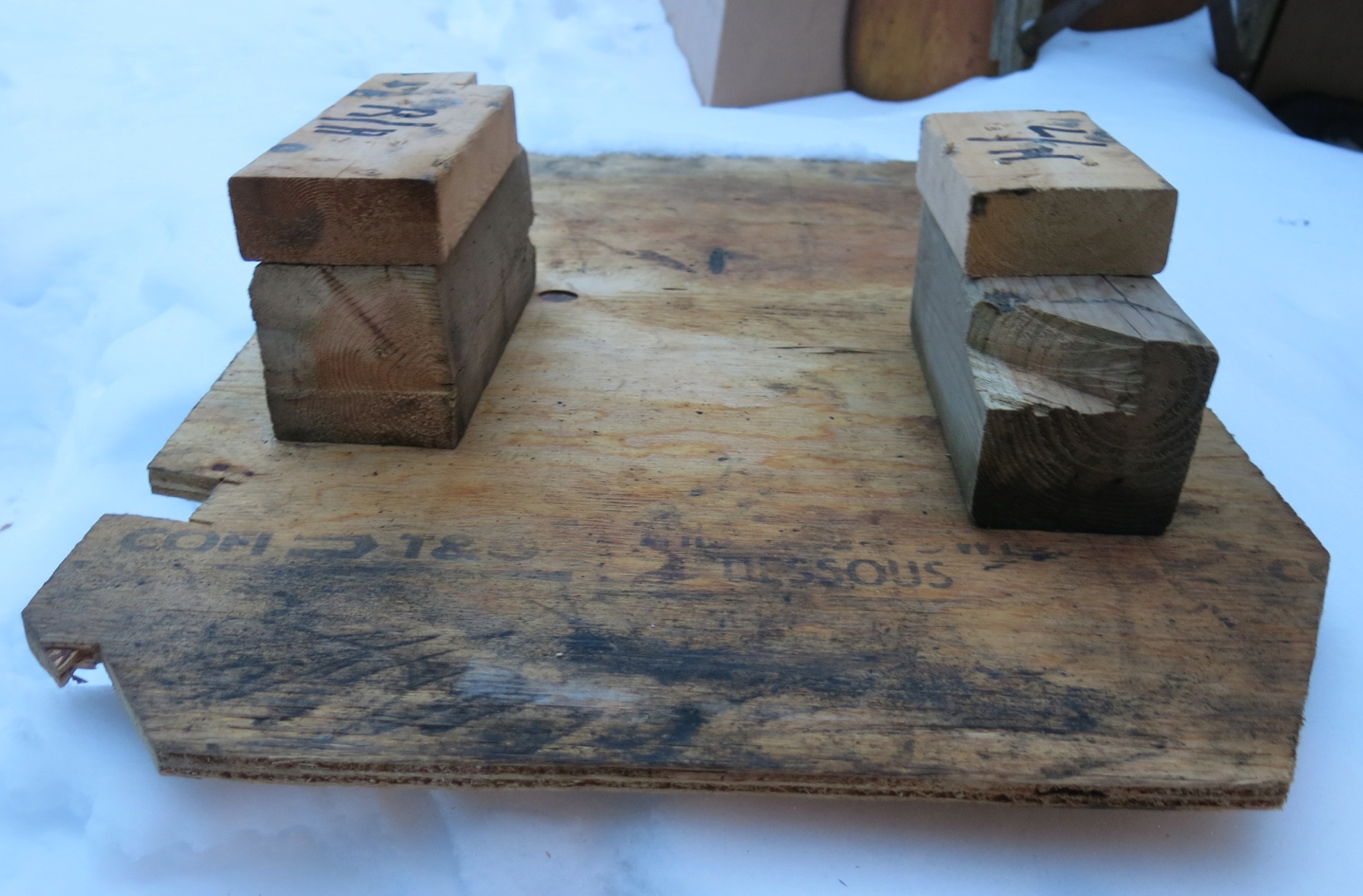

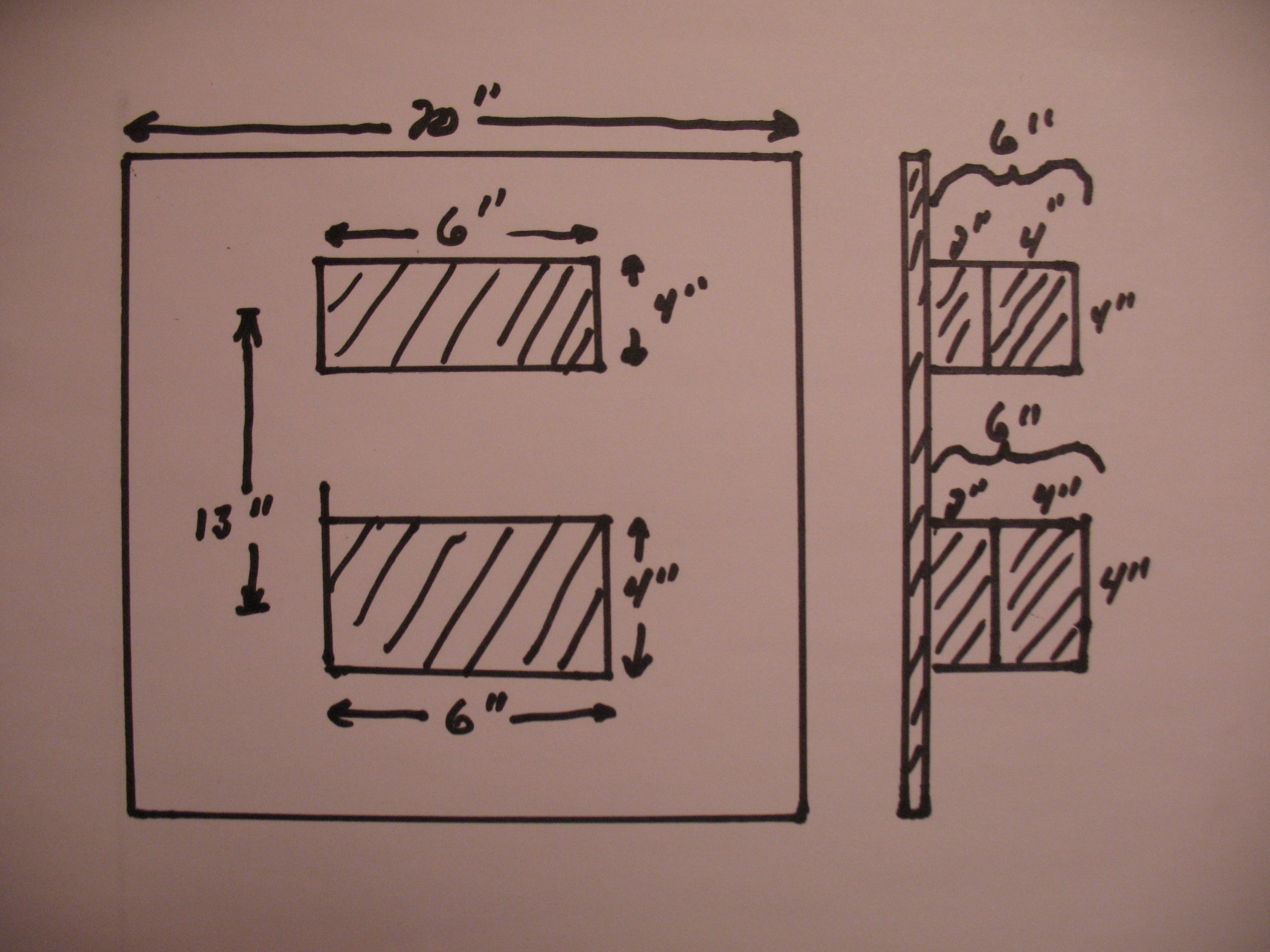

It's a pretty quick build. I doubt it would take more than 30 minutes and you don't have to worry about a block of wood slipping or needing a strap to hold the motor down. Once it's on the form, it's not going to turn over or slip off.

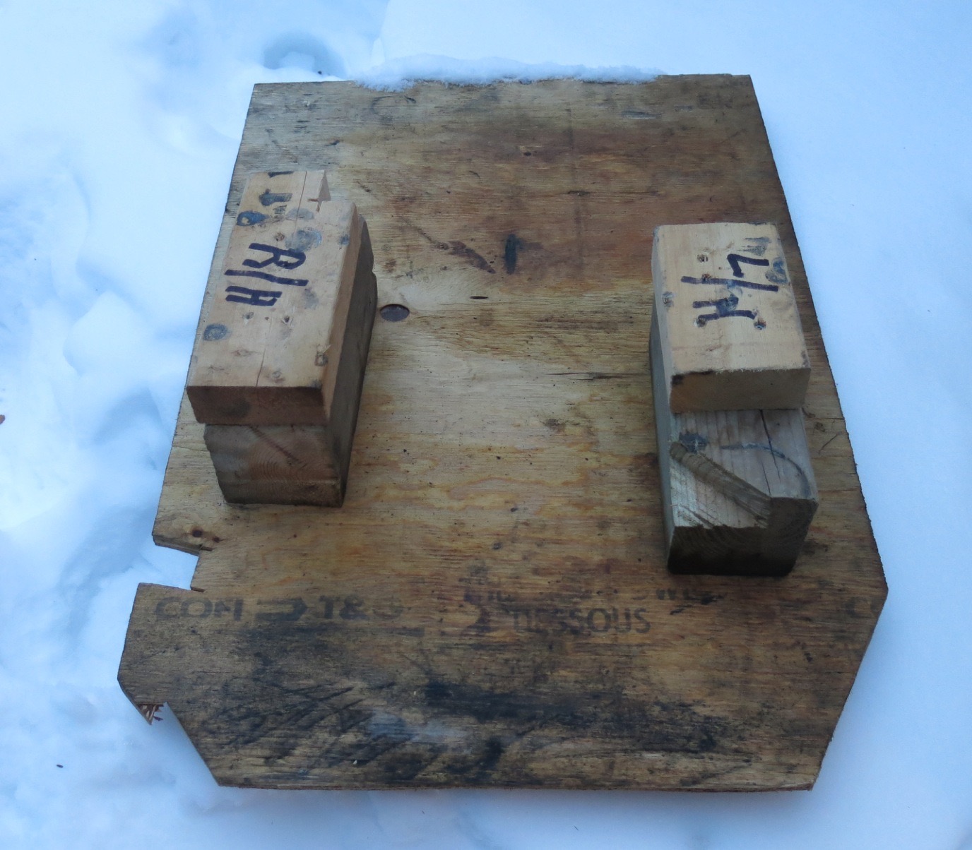

This is what I did to rest the engine on the engine block. Was really steady and no load on anything else...

Thanks guys. All your suggestions were greatly appreciated. I wound up building a smaller version of the wooden cradles. Basically just a "U" if you will, to stabilize the engine side to side. I'll get a picture after I put my motor back. But it's out now!
