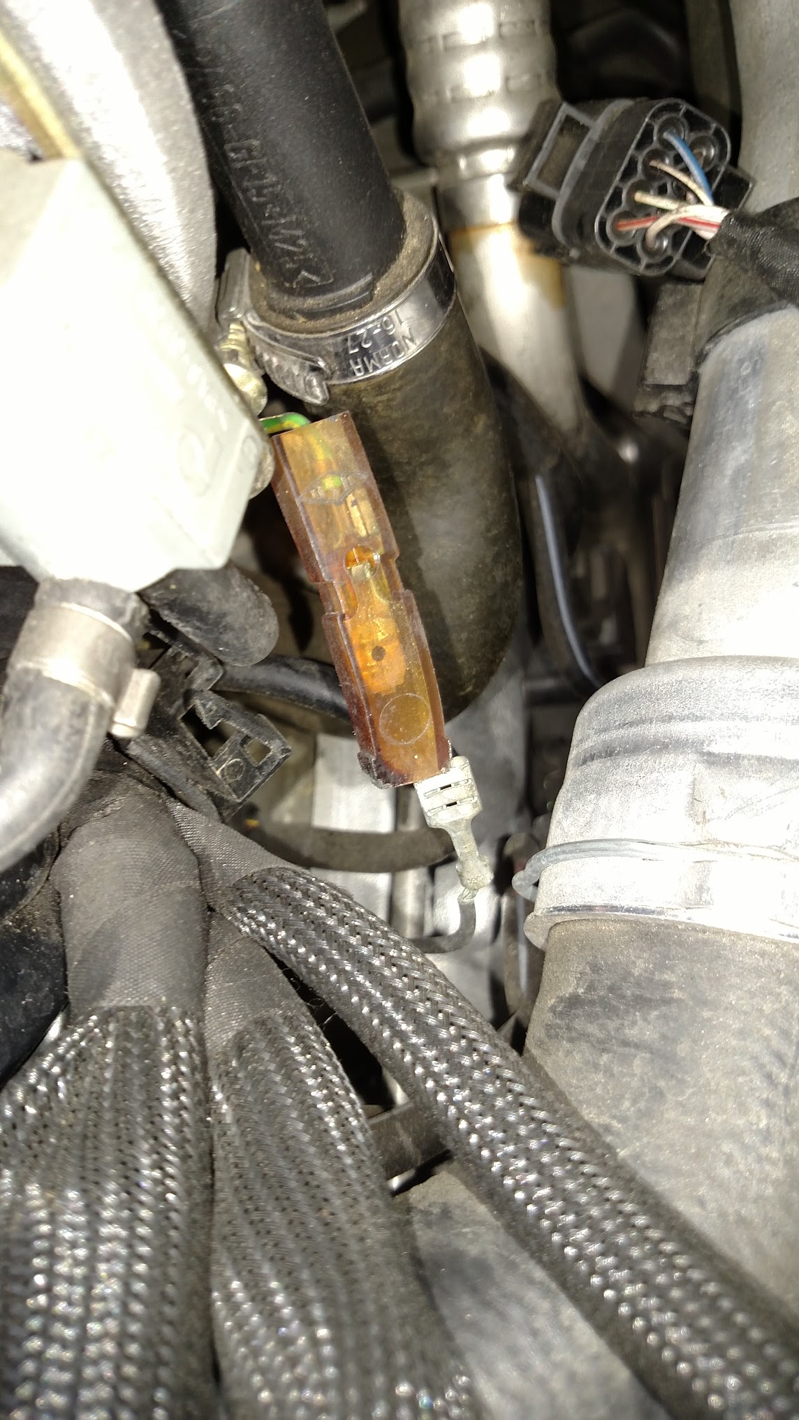

I pulled out the boroscope to chase the wire. The connector is on the way right of the motor, under where the main harness comes to the motor. Bull**** little spade connector, for a 100k+ car. Not even a clip/quick release. Just pull.

That same connector had me stuck for a couple of hours too.
I suspected that previous owner had done something with the wiring, but it turned out that this is the way porsche did it.
