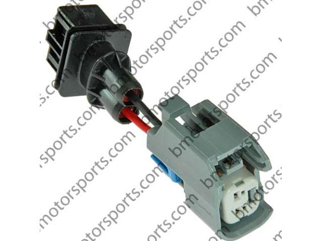

I've got ID1000s in my 996tt and am having a really strange problem. I'm using the one piece jetronic to uscar adpaters (see picture) to connect the new style injectors to the factory harness.
Long story short, when I first fired up the car, cylinder 1 wasn't firing. Changed the adapter and all was cured. I've been working with Sam on getting the tune in the car sorted out and as we're making progress I had the same failure on Saturday night.
I'm curious, for those of you that are using ID injectors, are you using these same adapters and have you had any kind of issue with the adapters.
Thanks for any help.

Hey bud, glad you put that picture up. Those are definitely different than the adapters Cobb uses and I would not doubt it's your issue. I will try to get you a set
Thanks for confirming I've got non-Cobb adapters Sam.

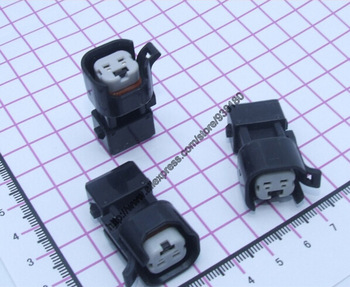

It would be great if you can get me a set and that solves the problem. That way I don't have to dick with pulling an injector out of the car. I ordered new ones that use factory style connectors on either end:
I ordered the connectors pictured below that use Delphi and Bosch manufactured connectors on both ends. However, using an adapter from Cobb that you know works is probably the way to go.

You know what, after opening the box and taking a look they are the same as your original picture. I used to deal with so many different set ups I got them confused. For what it's worth the ones that I received from Cobb I've never had an issue with. Same with the Bosch injectors Sean is talking about.

I didn't hardwire the connectors because I didn't want to chop up the harness. The adapters I bought to replace the current adapters are built using actual Delphi and Bosch connectors, so as adapters go it doesn't get any better than that.
