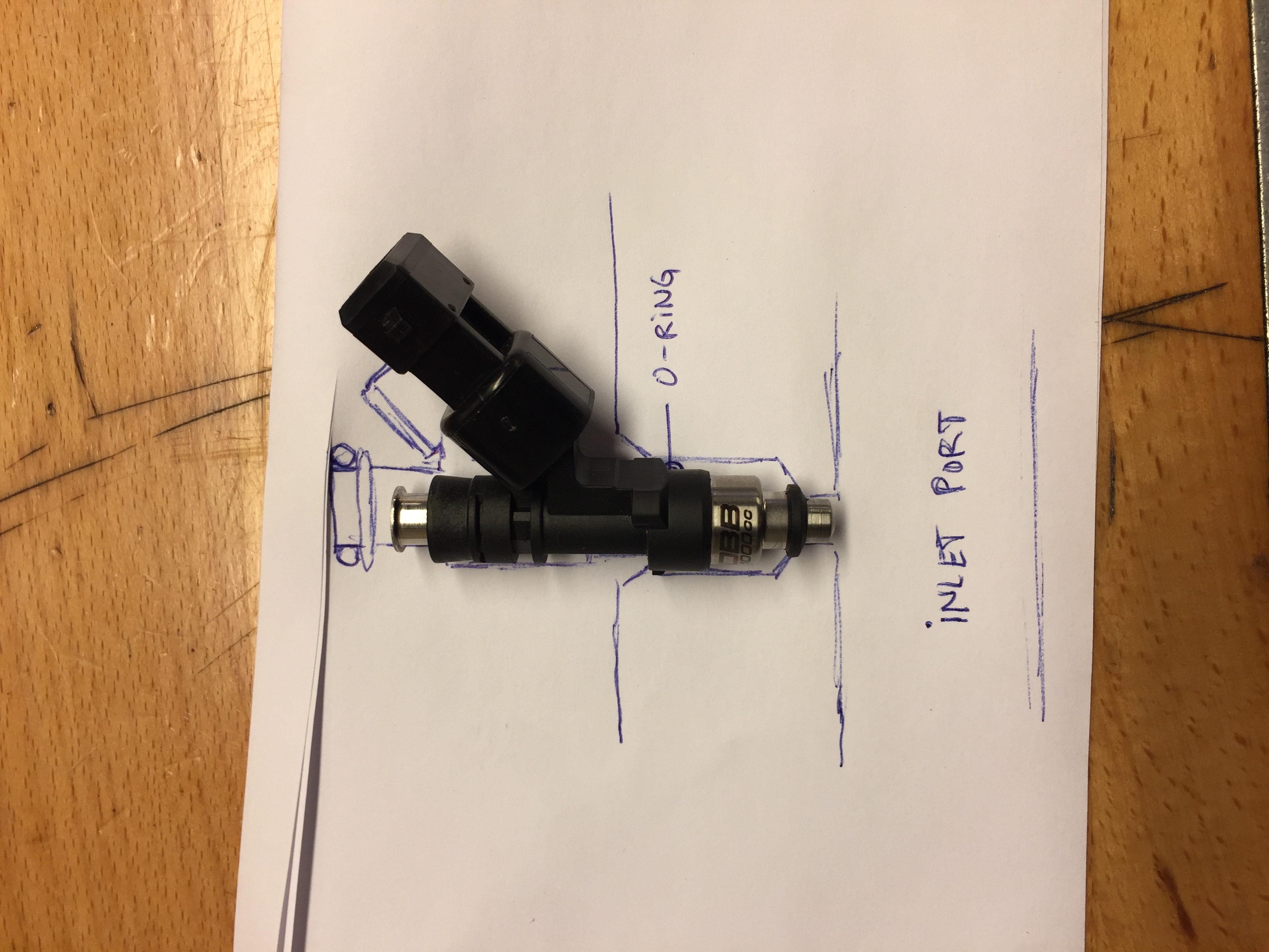

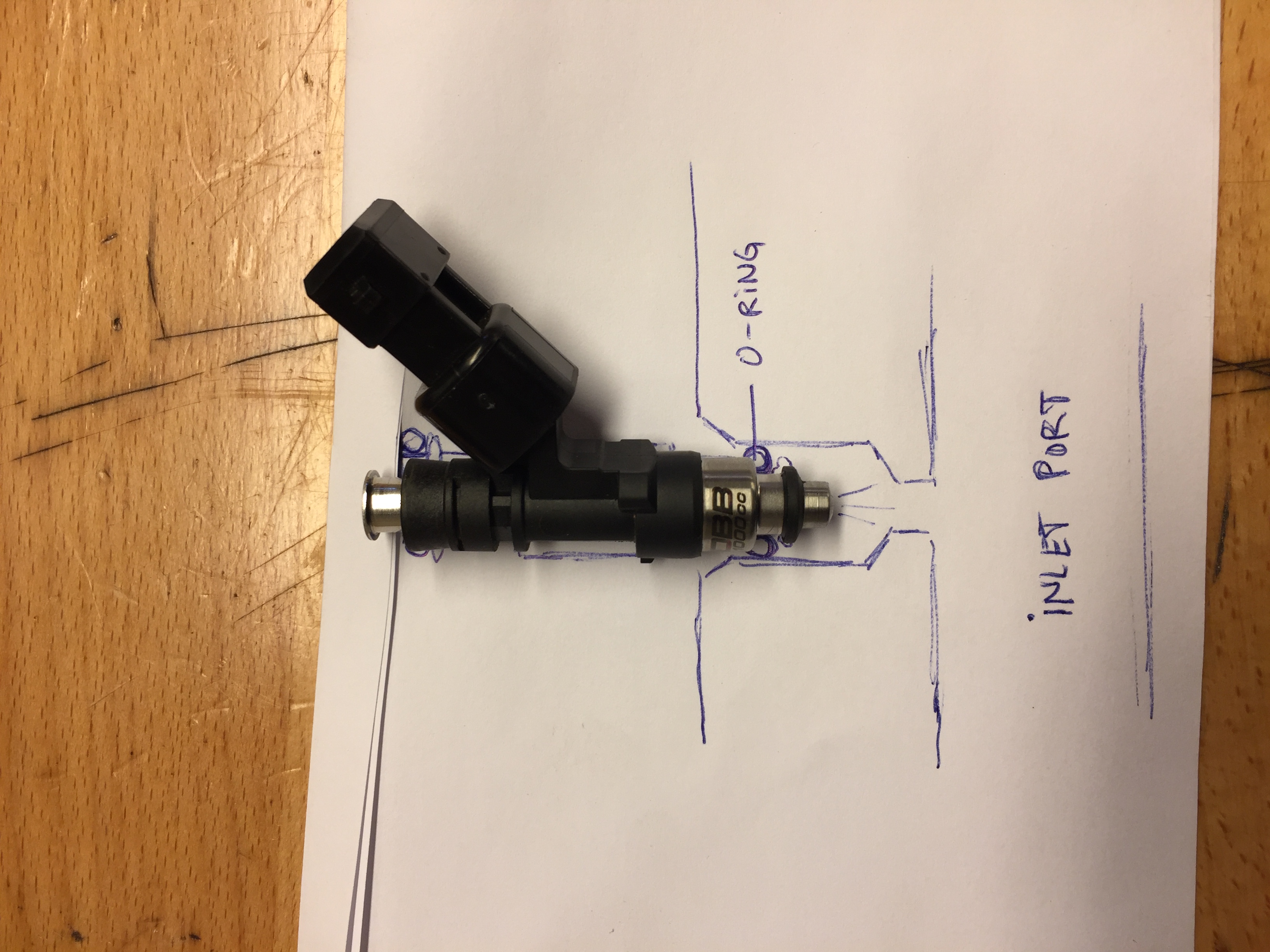

Reviving this old thread:
I ran with COBB 1000cc injectors last year and they worked fine, but now that I have my engine out I have been able to better inspect/look at the injector fitment.
Like OP I find it strange how the COBB inejctors are seated in the manifold flange..
I know it seems to work just fine but I am considering lowering the fuel rail 5mm to bring the injectors further down.
Both to get the o-ring down where it really seats well and to get the injector opening down nearer the inlet port.
Anyone did the same?
So changed the fuel rail?
Or carefully made a slat higher up in the plastic injector body?
Or should this be left alone - is it meant to be like this with injector positioned where it is?
The spray pattern is maybe so that this is the optimal position..

I believe those are Injector Dynamics injectors yes? Paul Yaw is the owner and posts on FB pretty regularly. He seems to enjoy technical discussions and engineering problems, you might want to just ask hm directly. They may have a FB page too just for the company. COBB likewise is pretty approachable. Seems a fair question to ask!

Yes, these COBB injectors are really Injector Dynamics.
Wrote Paul and COBB, will see what recommendations they come back with.
