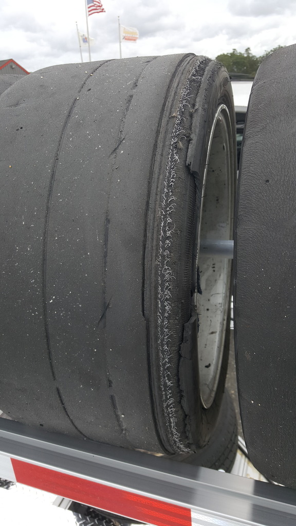

John, what are you doing in the rear? I just got back from a 2 day weekend and a screw from my left liner backed out and almost was a catastrophic failure - I noticed loss of traction and did a slow lap and came in next chance I had. I ask because this was a wear area I noticed before this happened and didn't realize the screw that holds the cover for the bracket in the rear was metal and not self tap plastic. For now I removed the bracket behind the liner that holds the wheel liner and simply tied this back till I figure out a solution.
I was running hollow twists at the time with 315/30 nt-01 and a 15mm spacer ( thought this would help)
you can try bending the braket backwards and then heat the liner and mold it to add some room. sadly there isnt much space with a 315 rubber

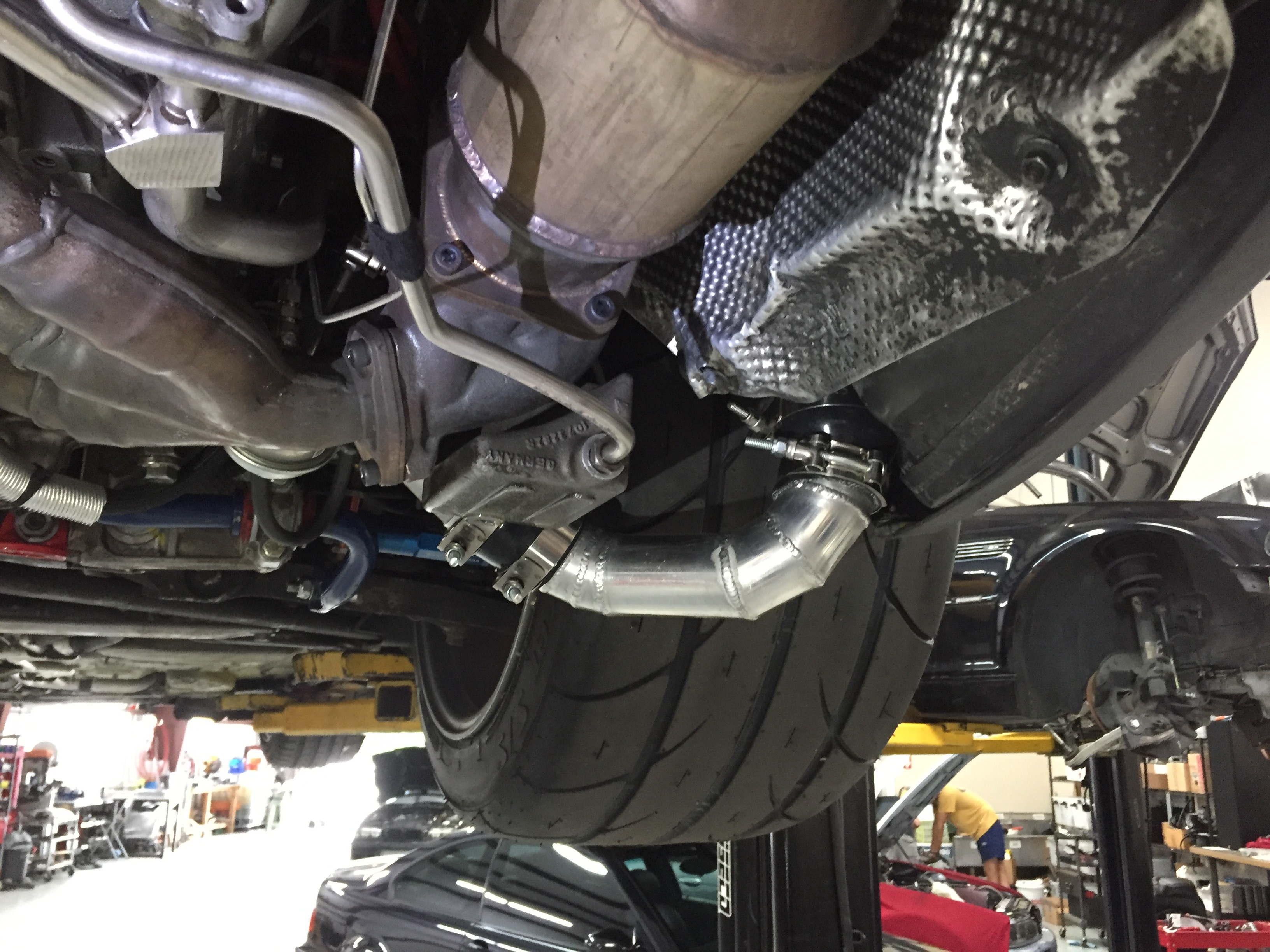

Yea I see what you're saying but even bending it doesn't give you much since the hose starts to get in the way
in talking with my tuner/shop thats doing a ton of work on mine they made these for me. according to them the smaller diameter doesnt really effect the flow as it at the same diameter as the turbo compressor outlet. this allows for heating and bending the panel back ever so slightly more. and allows for a place to tie wrap to if needed

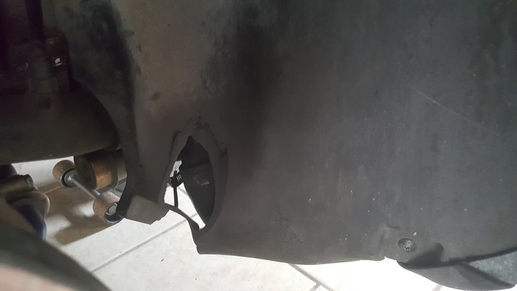

I went a little more redneck on mine. I removed the bracket, trimmed the bottom up some. Then headed the liner and pushed it back as far as possible. Then I drilled 2 holes and zip ties it to the intercooler bracket. Give me 1.5 inch more room back there. Also I drilled 2 holes in the liner down by the intercooler piping and zip tied the liner to the hoses. Lots more room. 8 can run my 325/30/19 with zero running. They are much larger than a 315/30/18

Bringing up an old thread for guys. Just did the mod on another customer car. Huge difference in space up front. Combine this with a fender roll and you can really make a 245 stick out and look nice, widen your track, and improve performance.
sorry my camera is kinda broken and sucks.
