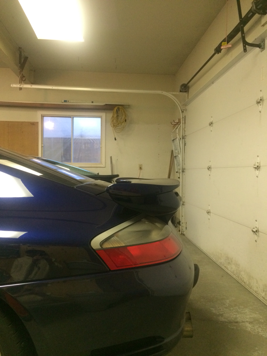

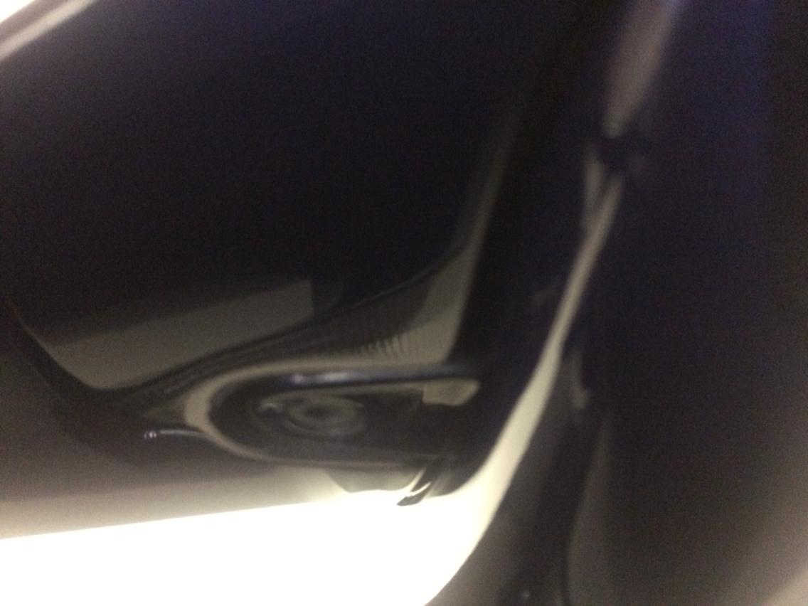

I was looking at my aero wing today and noticed it's angled really flat compared to the regular wings. All the pictures I've seen of factory aero wings look like they have the same flat angle though. I noticed that the top portion of my wing is adjustable by loosening 2 bolts underneath on each side.
My question for the aerodynamic experts here is what affect would tilting the back, up or down, have on the overall lift and down force of the car? I would think tilting it up would push the rear down but how would that affect the front, or would it even?
i learn something new every day! i have the aero spoiler as well and never knew it was adjustable!

Ok, so I didn't actually try to adjust it and just assumed it was adjustable from the way it sits on the base but the more research I do I'm started to think that it's not adjustable. I found this bulletin for dealerships on how to retrofit the full aerokit and it doesn't mention anything about it being adjustable.
Interestingly though, it does mention to not install either the front lip or wing on their own but that they must be installed together.
http://bethnrayndogs.com/car_docs/Po...okit_12-01.pdf
Since I have the aero wing without the aero lip, this concerns me.
