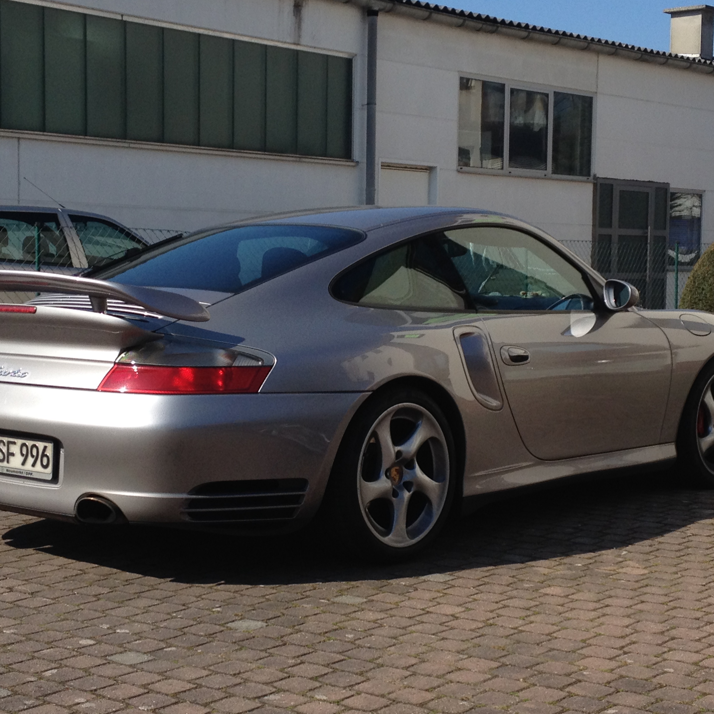

I dont think either its the aero. Check aligment.
I use areolip in front and a bigger wing on the rear. Car runs smooth over 300 km/h

Ok, I'll look into that. But would alignment issue drive fine up to 220km/h but then show up past that?
Maybe lack of aero lip in front thought?
