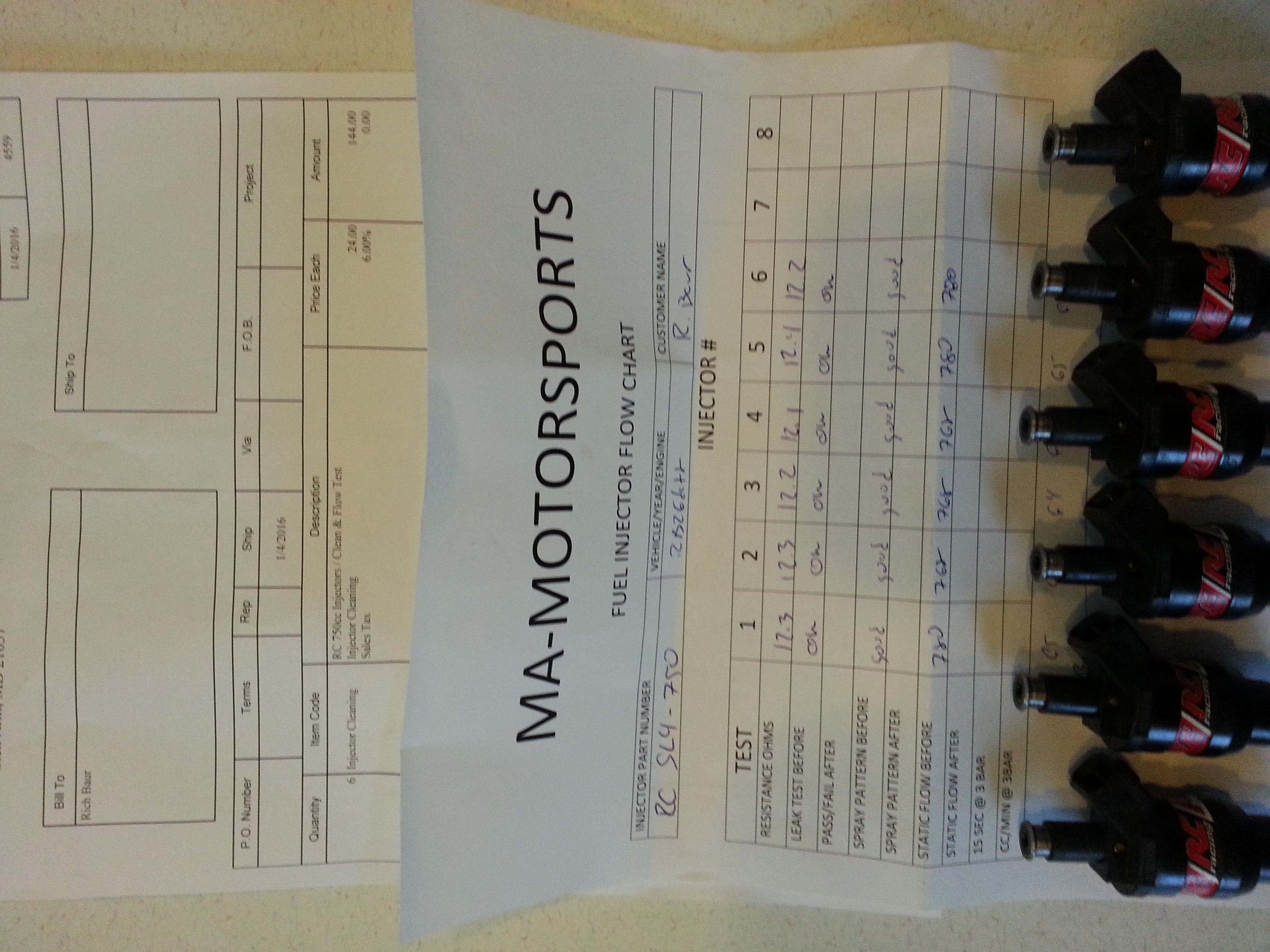

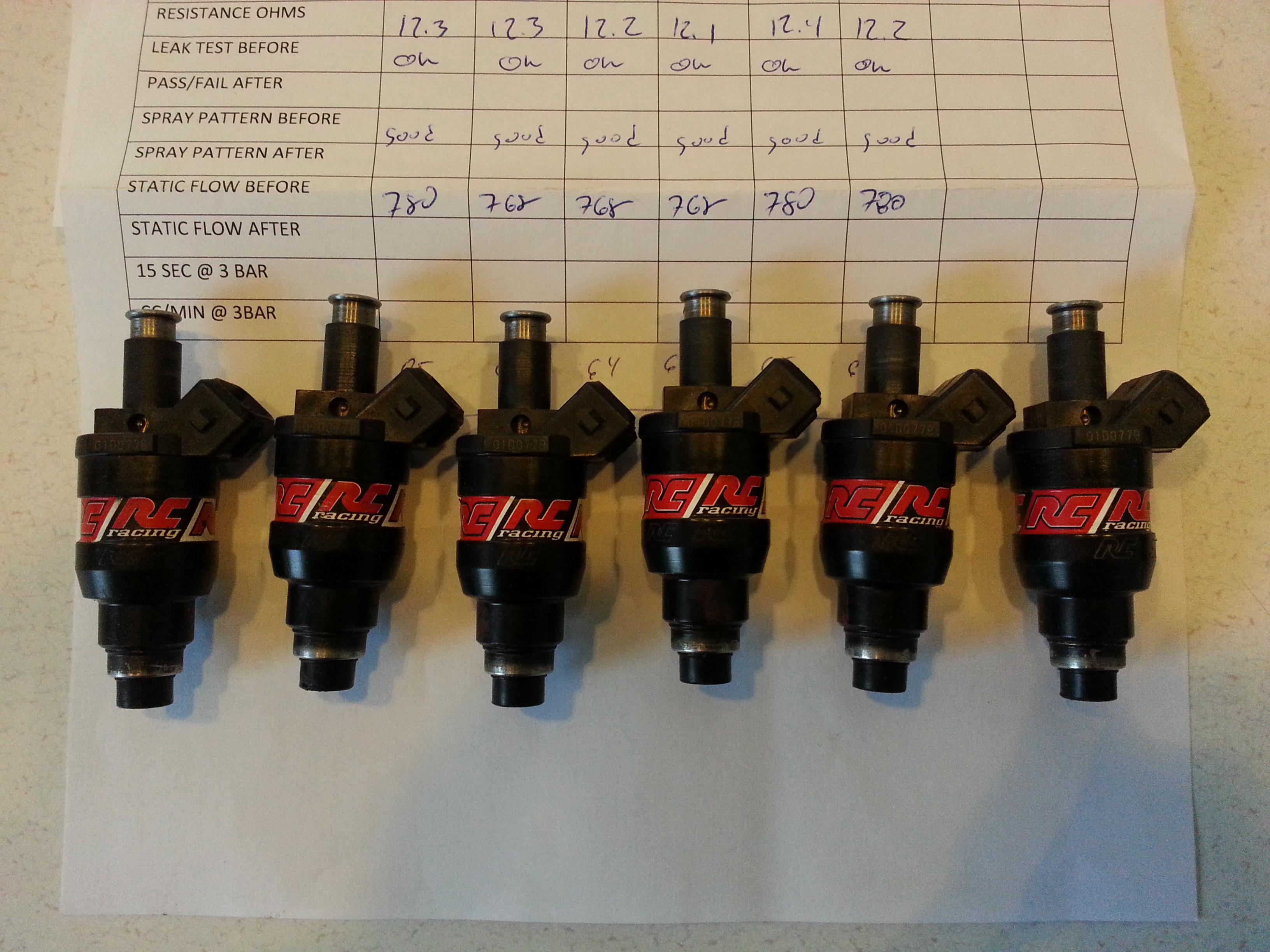

Will these injectors work?
I completely forgot i had these injectors and recently had them cleaned and flow tested.
They're 750cc and high impedance.
Reason I ask, I notice everyone using the long slender Bosch EV style.
Any reason not to use them?
ID:	443440   Click image for larger version

Do they fit into the fuel rail and lower manifold bosses? Same o-ring OD? Same length as stock? If yes, the I don't see why not.

I would recommend against using these. There are much better injectors available now and even though you have them in your hand, I have had lots of issues with RC in the past. I would recommend Injector Dynamics for any injector needs.

I think those look alot fatter then the oe ones and from what I remember they are a pretty tight fit.
