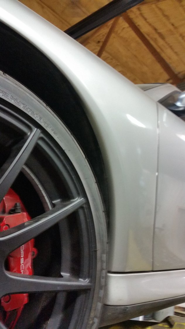

Yep eastwood roller. Had mine for about 5 years. No adapter needed, just need to use a cut off wheel to cut the 5 lug slots all the way out. I'll take a pic of thay tomorrow for ya. You will need to put of washer underneath the roller though to clear the caliper when rolling the front half.

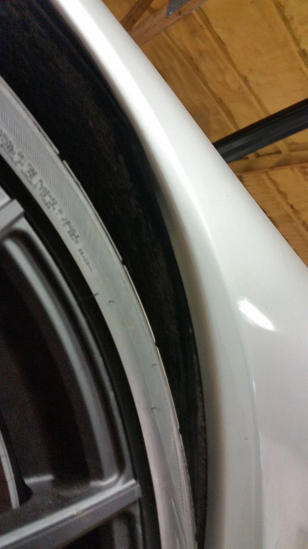

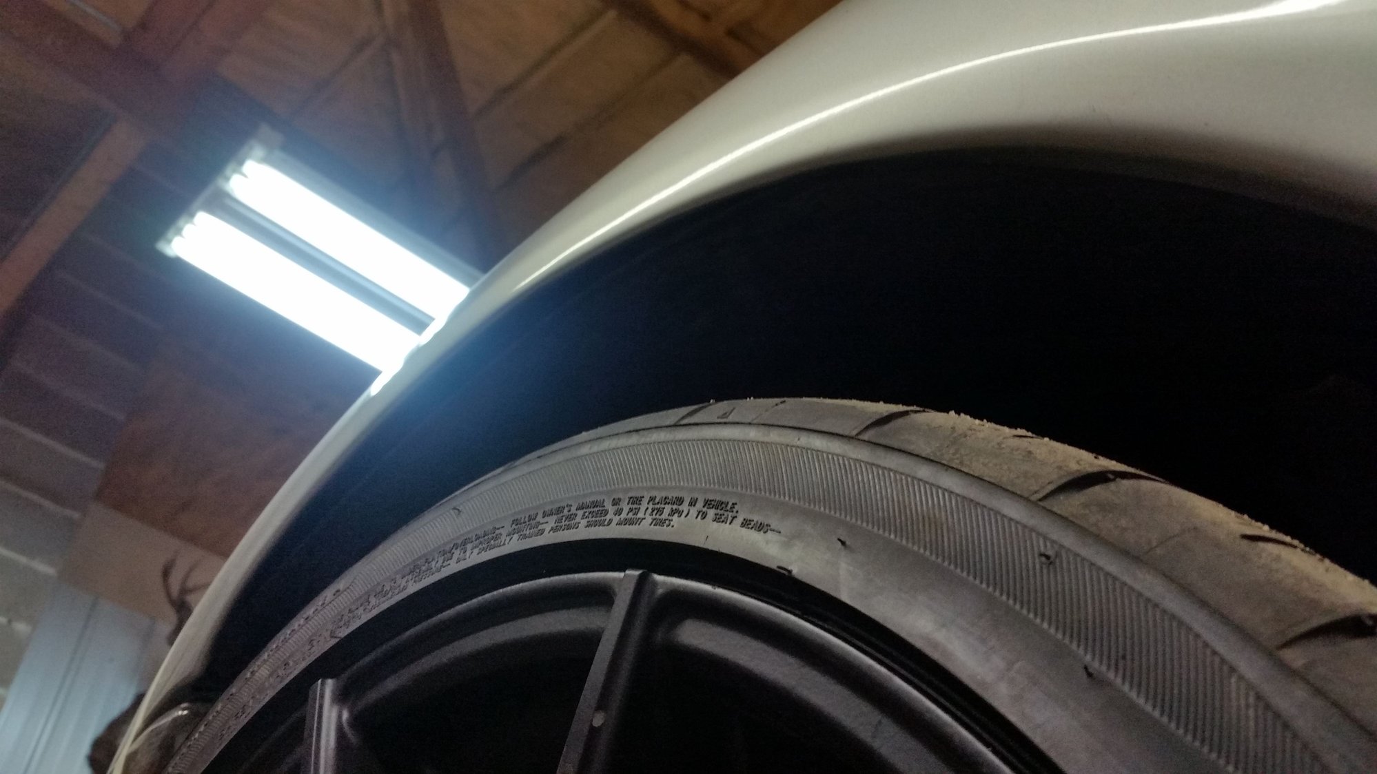

Pics of the front and how to mod the roller. Note I still have to finish modding and stretching the liner to make it fit properly in the front yet as well.
