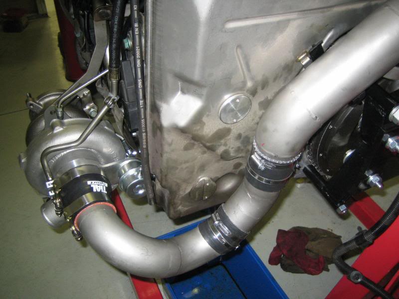

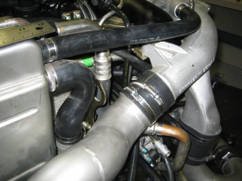

The best way to improve the intake air flow is to replace the restrictive OEM plumbing to the turbos with larger diameter piping such as this intake system pictured below. Air box/filter modifications don't really do anything meaningful for performance, whereas, larger plumbing with a hi-flow plenum on an upgraded car will...

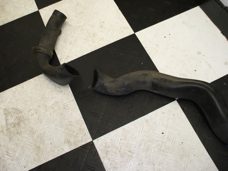

OEM plumbing removed from car for comparison:
There is no no comparison if you are looking to improve air flow, especially when running higher boost, larger turbos or both...

John, I agree but doesn't the motor have to come out for that intake piping?

It really does. Even lowered 6 inches or so it would be a huge pain. The black plastic intake piping is made by Evoms. It does not fit really well and it helps tremendously if you cut it into several more sections that will allow you to position it properly. When I was installing mine I wanted to run down to Arizona and smash it over their heads. With that said, once all the cursing, cutting, and modding is done, I think it's the best solution you can use as it is larger diameter and thick walled with great heat insulating properties which makes it nearly indestructible. I can not really fathom how you'd install it with the engine in the car. I run those with a large volume RUF intake manifold and it works very well. I ended up making one more cut near the passenger side turbo to make it all fit.

did mine with the engine in the car. cursed at every evoms person i could find. john at speedtech and everyone in my subdivision!! this needs to be cut into about 5 pieces and even then the fitment is crap. couldnt wait to sell mine and glad its gone

I would say that the stock intake pipes are the most restrictive thing on our car in stock form. If you have ever taken the pipes off and looked at how tiny they are you will understand. The flexible pipes I'd say for may are the easiest way to go to fix this but if not installed right can rub through. If you're going mafless, fender intakes are even better. Overall changing from stock will net you faster spool, more hp, and lower egts.

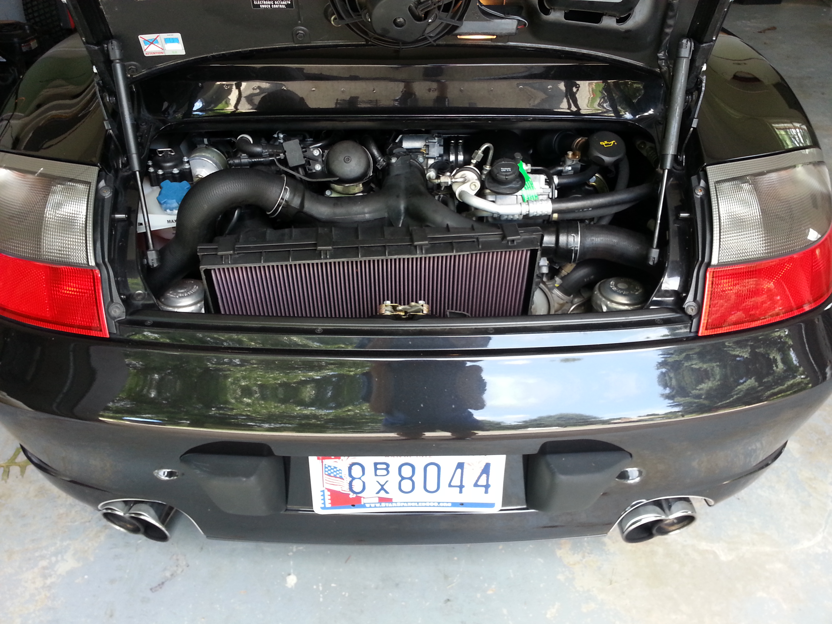

I installed this years ago...then the 997 went to dual...to copy me
