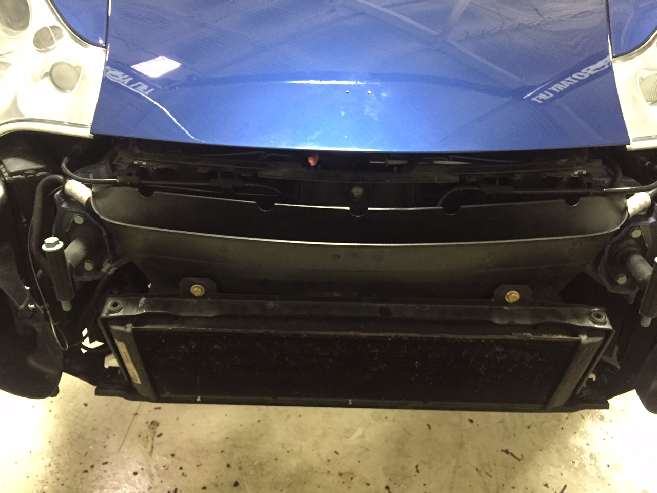

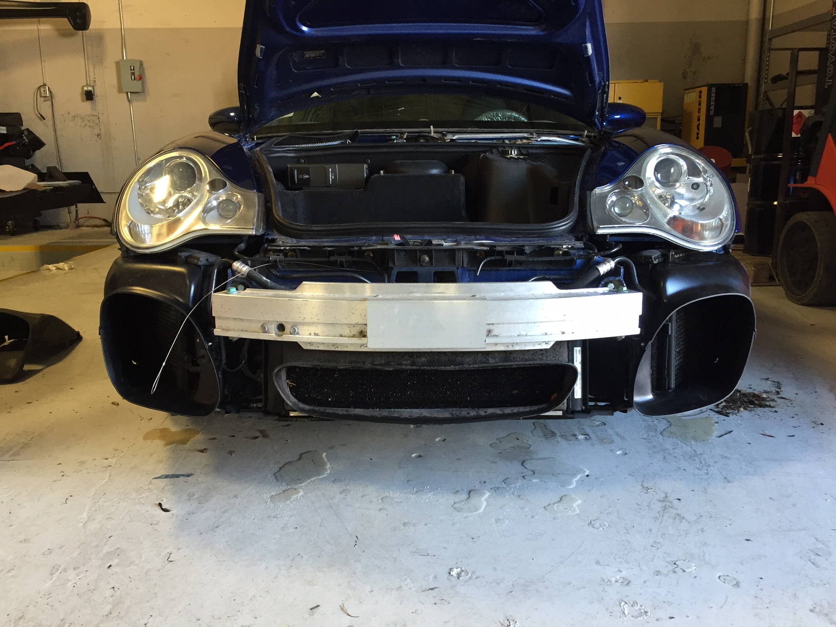

Here are the pics
ID:	444751   Click image for larger version
Old Apr 4, 2016 | 08:06 PM
macmann's Avatar
Joined: Jan 2015
Posts: 119
From: Houston, TX
Rep Power: 16
macmann is infamous around these parts
Top picture is before center ducting was added. Bottom is with rear of center duct added. The front portion is riveted to the center radiator.
