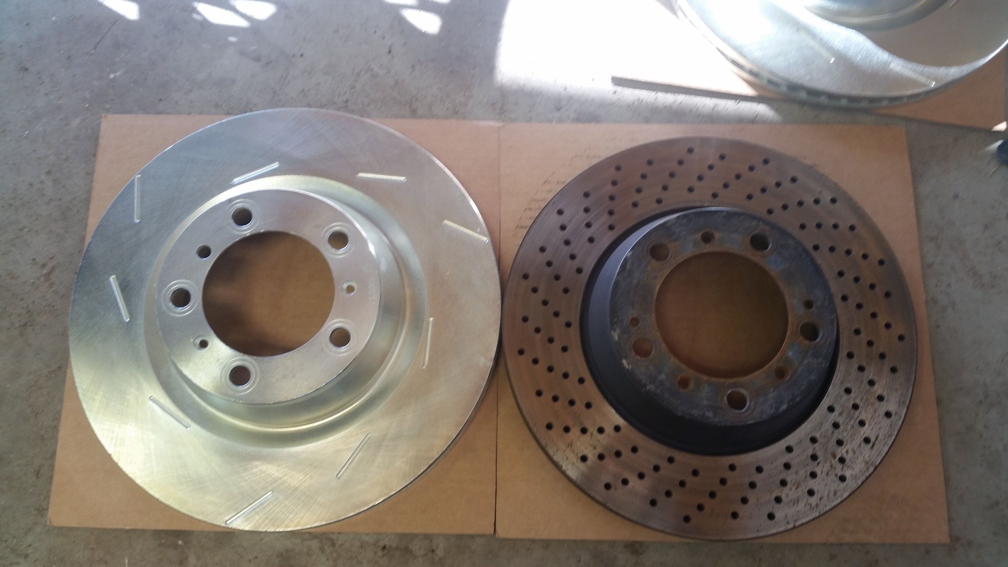

I got my front sebro from pelican bit like said no slotted rear option. I got my slotted rears from brakeperformance.com.
They are centric rotors. 170 for the pair.
