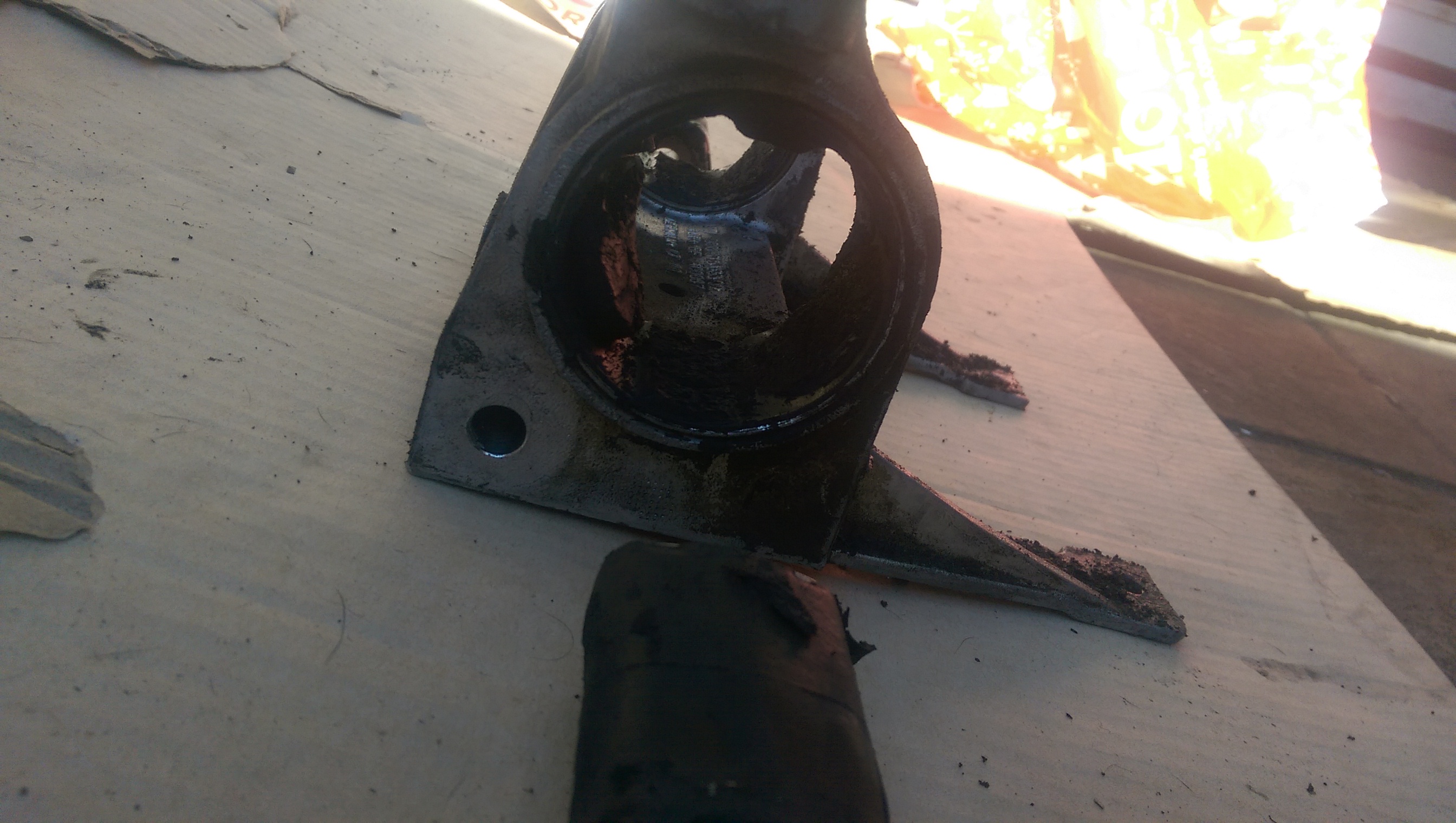

Hi guys,
I have been so impressed by the replacement/upgrade of the engine and transmission mount, I had to share my thoughts.
First off, I went for the torque solutions engine mount, which are semi solid- similar to the NYPPD, Wevo or RSS mounts.
The engine mounts themselves were not too bad. They had not cracked, just sagged a little but otherwise in good condition.

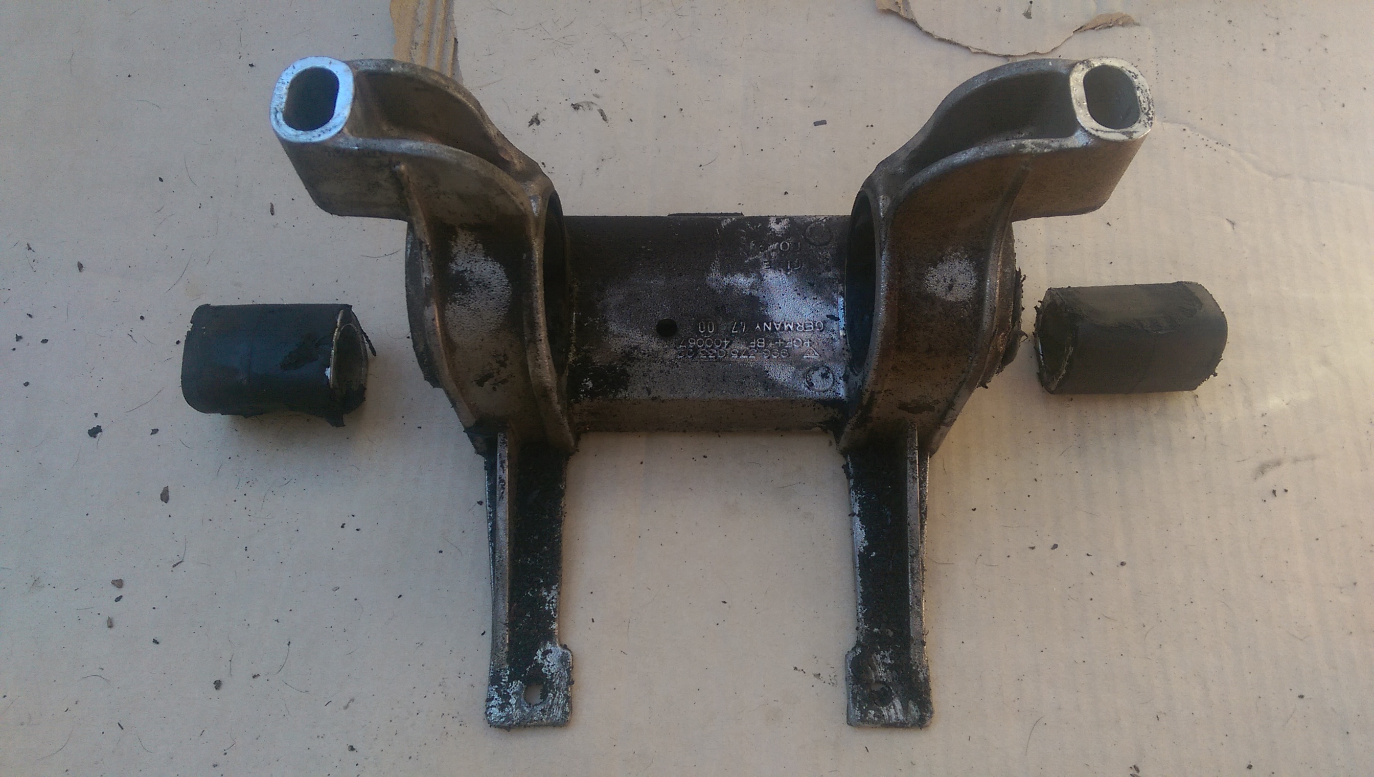

The transmission mount was another story. I knew it was on the way out and had been 'patching it up' but when I finally removed it from the car, it was totally shot. The rubber mounting points had split, disintegrated and were mostly missing.That is the mount was not supporting the trans, merely just holding it in the approximate position.
I installed a stock mount that I had filled with a two part polysulfide aviation sealant with a durametric rating of 50.
IMPRESSSIONS- It feels like I have upgraded my suspension. No more clunks/rattles, just a direct feeling and connection to the road. The car never felt planted or secure but now it feels stiffer and more communicative in the back end. With the Pirelli corsas I have fitted, the rear end feels 100% better.
Noise has increased minutely at idle but after a couple of days , I cant even tell anymore. I am amazed at how tying down the large lump of a weight mass that is the engine and trans has made a difference!
BTW-I have attached photos of the shot trans mount.
So, for anyone considering these upgrades, do not hesitate. The eng mounts were $400 and the trans mount $300(in Australia). The install of the eng mounts is very easy,took about an hour. The trans mount a little harder, if you do not have a lift and took me about 2hrs.

those 3 items VASTLY improved my car(s) "tautness" and eliminated ALL the lateral "slop" and would also recommend to ANYone hasn't done 'em. mine are the wevo semi's just the oem 997 t-mount. did same to both cars and had same results each time.
enjoy it. like a new car, handling wise.

my old 996 mount by the time i looked at it was crumbled bits, basically metal on metal with the remaining rubber bits crumbling out with each day
