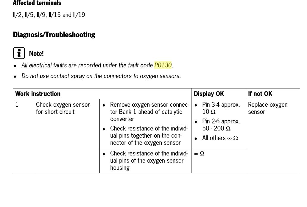

Hopefully what you saw *was not* anti-seize on the new sensors. Anti-seize can ruin an O2 sensor.
You did write "P0130". I screwed up somehow and got that to "P0113". Sorry.
Still P0130 is an O2 sensor error code.
P0130: Oxygen Sensor Ahead of TWC, Bank 1 – Signal Implausible.
Diagnosis conditions
• Vehicle at operating temperature, after this 3 minutes idle speed, then approx. 30 seconds increased idle speed.
Possible fault cause
♦ Short circuit to ground
♦ Short circuit to B+
♦ Open circuit
♦ Oxygen sensor

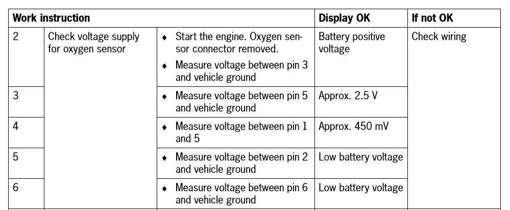

I've cut/pasted some tests out of my reference for you. See below.
